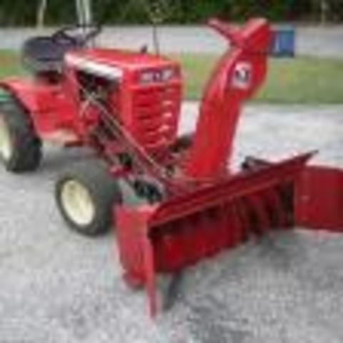

Jbones 10 #1 Posted August 23, 2021 Hi everyone, I am a long time viewer of this excellent community and I have learned so much from all of you guys that share your knowledge. I bought a new house and started looking at machines that could clear a long driveway and I stumbled across the 520H with a blower and a 48" deck. Anyway I love it, but now I have an electrical issue I keep blowing the 25 amp fuse. Its a 1992 and if i replace the fuse it runs fine for a while. I can change the fuse and it starts right up and goes fine, is there anywhere I should start looking that is a known trouble spot? Thanks, Josh 2 Share this post Link to post Share on other sites
