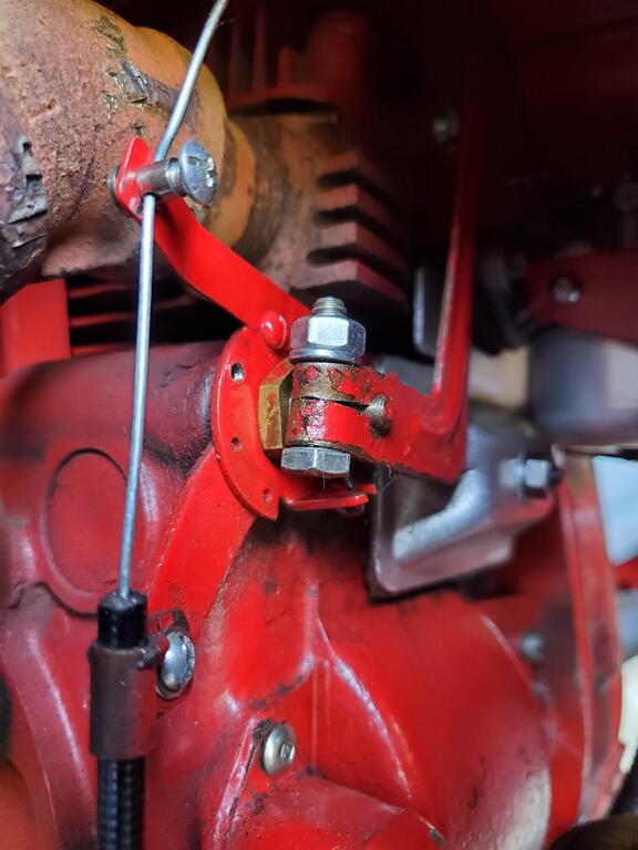

Maxwell-8 4,371 #2 Posted August 22, 2021 try moving this bar to the lower hole 29 minutes ago, pfrederi said: Out of all 20 some horses i have only 2 with k181. Neither one has much range for throttle response. A small movement of the the T knob makes a big change in RPM. I have seen some that have an arm on the throttle disc. Mine don't have that. Does that arm allow a bit more throttle range??? Worth trying to buy one??? 1 Share this post Link to post Share on other sites

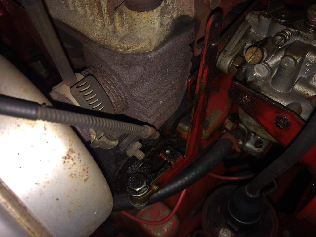

ebinmaine 79,736 #3 Posted August 22, 2021 Seems to me Trina's Pigpen 867 does have the arm. I believe she has a fair 3/4" or more of travel in the throttle cable/pull knob from idle to redline. I can double check tomorrow evening and also dump out a couple parts boxes to see if I have an arm. I s'pose one could fab one up and weld or braze it in place given decent measurements. The longer the arm on that pivot point is the more pull length you'd have. Worth it? I'd say so. 1 Share this post Link to post Share on other sites

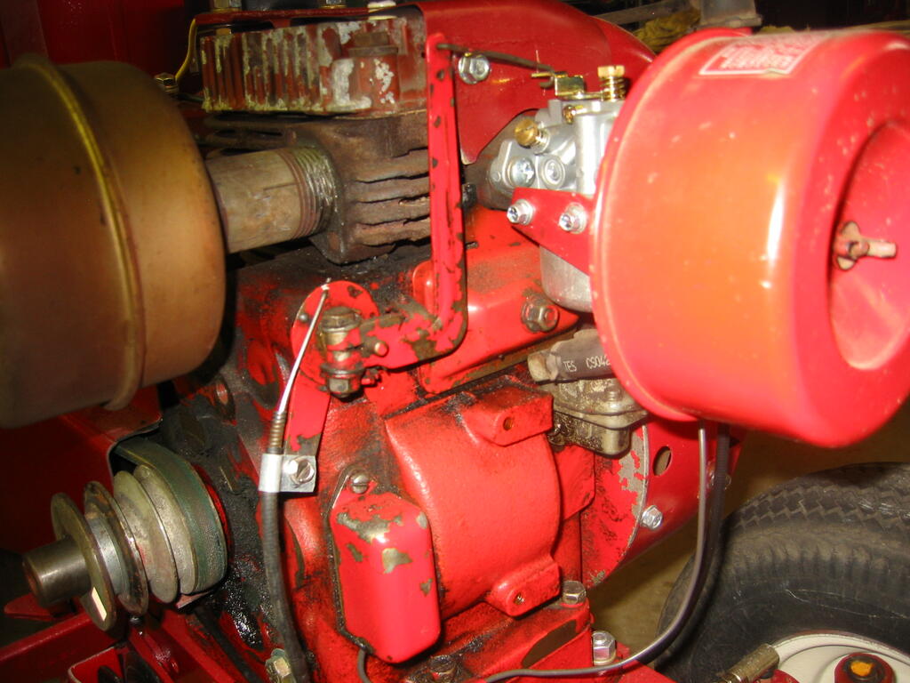

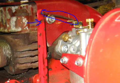

Racinbob 13,047 #4 Posted August 23, 2021 I've had the same issue with several K-181's. I've tried several things but most didn't work and some even caused the governor to operate erratically. I finally came up with this modification. There may be a better or more correct way to do it but it works great. 5 1 Share this post Link to post Share on other sites
pfrederi 20,886 #5 Posted August 23, 2021 50 minutes ago, Racinbob said: I've had the same issue with several K-181's. I've tried several things but most didn't work and some even caused the governor to operate erratically. I finally came up with this modification. There may be a better or more correct way to do it but it works great. Great iidea....Is that arm welded on or small bolt? Share this post Link to post Share on other sites
squonk 47,422 #6 Posted August 23, 2021 Are we talking a throttle that's hard to pull and it's either at idle or full throttle and not much in between? My 857 is like that. Replacing the cable did nothing. My cable comes in from the top as opposed to the bottom. Share this post Link to post Share on other sites
Racinbob 13,047 #7 Posted August 23, 2021 52 minutes ago, pfrederi said: Great iidea....Is that arm welded on or small bolt? Bolted. There's actually two bolts. I tapped the holes in the round thingy. They needed to be ground flat on the back side for clearance. I don't see why welding wouldn't work though. 2 Share this post Link to post Share on other sites
pfrederi 20,886 #8 Posted August 23, 2021 4 minutes ago, Racinbob said: Bolted. There's actually two bolts. I tapped the holes in the round thingy. They needed to be ground flat on the back side for clearance. I don't see why welding wouldn't work though. Thank you!~! 1 Share this post Link to post Share on other sites
pfrederi 20,886 #9 Posted August 23, 2021 12 minutes ago, squonk said: Are we talking a throttle that's hard to pull and it's either at idle or full throttle and not much in between? My 857 is like that. Replacing the cable did nothing. My cable comes in from the top as opposed to the bottom. Very small movement in the T knob gets you from idle to full throttle... You seem to have the small extension arm that i do not have... 1 Share this post Link to post Share on other sites
squonk 47,422 #10 Posted August 23, 2021 3 minutes ago, pfrederi said: Very small movement in the T knob gets you from idle to full throttle... You seem to have the small extension arm that i do not have... Yup same thing I have. Share this post Link to post Share on other sites
