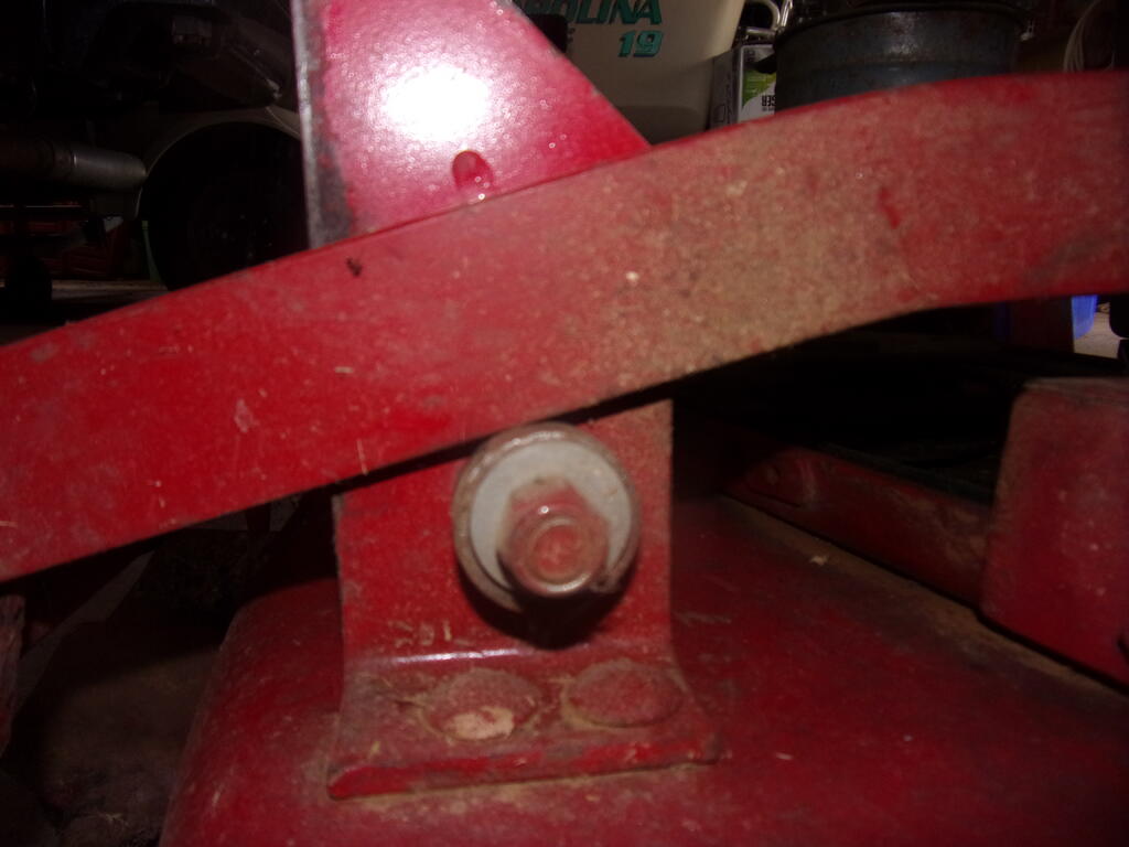

Ifixoldjunk 778 #1 Posted August 21, 2021 So I just bought a 42 side discharge with hopes of putting it on my 310-8. I’ve already had a 42 rear discharge mounted on this machine but I can’t seem to get the side discharge to work. It mounts on normally but I can’t really adjust the height or raise it into transport position. I know the po had the deck apart at one time, maybe he reassembled it wrong? Idk. Anyways, here’s some pictures just in case y’all see something that I don’t. Share this post Link to post Share on other sites
Ifixoldjunk 778 #3 Posted August 21, 2021 removing this seemed to give me some extra height, but it seems like a fairly important piece. Nonetheless it still won’t “click” into transport position. Share this post Link to post Share on other sites
Bill D 3,099 #4 Posted August 21, 2021 Take that washer off the leveling rod. It's hitting the antiscalp wheel bracket. The nut looks like it's cranked up too high. The nose of the deck is down more than the recommend 1/4". That could be stopping it from clicking into the transport position. 14 minutes ago, Ifixoldjunk said: removing this seemed to give me some extra height, but it seems like a fairly important piece. Nonetheless it still won’t “click” into transport position. Share this post Link to post Share on other sites

Ifixoldjunk 778 #6 Posted August 21, 2021 7 minutes ago, Ed Kennell said: Is the fork on the attach-a-matic properly? Raise the bolt in the slot on the front bracket so the rear end lifts earlier. I have had to add bushings to some of my decks to get the rear to lift. Well, I tried that, turns out it was just a bonehead error. I never took my snowblower “flag” off so that was wedging between the deck and the frame. 2 1 Share this post Link to post Share on other sites
