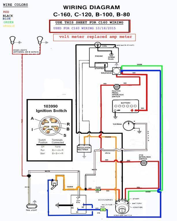

AHS 1,566 #1 Posted August 17, 2021 What models do the key switches fit? The C series? What is the wiring diagram? The issue is, 70 Raider 12 (updated) regular round coil. The key switch had a solenoid built into it… threw that away. Bought a 103990, and regular solenoid that mounts on the motor. All the wires are ran, now I just need to put them where they actually belong in that 5 block. Thanks! 1 Share this post Link to post Share on other sites

953 nut 62,992 #6 Posted August 18, 2021 4 hours ago, AHS said: The issue is, 70 Raider 12 (updated) regular round coil. The key switch had a solenoid built into it… threw that away. Bought a 103990, and regular solenoid that mounts on the motor. All the wires are ran, now I just need to put them where they actually belong in that 5 block. Your Raider isn't equipped with all the safety switches found on the "C" so here is a much simpler diagram with the 103990 key switch. 2 1 Share this post Link to post Share on other sites

1940willys 137 #10 Posted October 31, 2021 Squonk, Will this Diagram work for a C101 vintage 1976? Daughters C101 ran fine for the last cutting of the season the other day. Died at the very end and had to be pushed into the shed where it sits 60 miles away. Won't turn over and I suspect clutch pedal safety start switch because it's always been a little Sketchy. So if the Clutch safety fails When the Tractor is RUNNING, will that STOP the tractor While it was running? Share this post Link to post Share on other sites
squonk 44,860 #11 Posted October 31, 2021 (edited) 1 hour ago, 1940willys said: Squonk, Will this Diagram work for a C101 vintage 1976? Daughters C101 ran fine for the last cutting of the season the other day. Died at the very end and had to be pushed into the shed where it sits 60 miles away. Won't turn over and I suspect clutch pedal safety start switch because it's always been a little Sketchy. So if the Clutch safety fails When the Tractor is RUNNING, will that STOP the tractor While it was running? No. The clutch switch only kills the starter circuit. The diagrams posted will work. If your tractor has an ammeter check it's connections. Bad connections there or a bad meter kills power to the switch and you will have nothing Edited October 31, 2021 by squonk 1 Share this post Link to post Share on other sites
