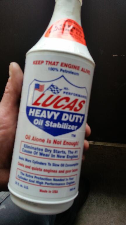

OutdoorEnvy 1,817 #55 Posted March 19, 2022 Well parts have come in and we are under way. Today I had a little time so got the valve lapping done and the cylinder honing as well. Also set the ring gaps. The close auto parts stores to me were all out of assembly lube. So waiting on that to arrive from the jungle site. Honestly I don't know how parts stores are going to stay in business when they can't keep in stock the simplest of stuff like assembly lube. They offer to order it of course but you can order it online and get it quicker and cheaper and not have to make the trip again...they're only niche is that they are there and you can go get it now...without that I don't know what they offer....anyways...rant over. 1 Share this post Link to post Share on other sites
WHX?? 57,466 #56 Posted March 19, 2022 This works for good assembly lube too... little messy but works. 4 Share this post Link to post Share on other sites
pfrederi 20,879 #57 Posted March 19, 2022 STP also works 1 1 Share this post Link to post Share on other sites
