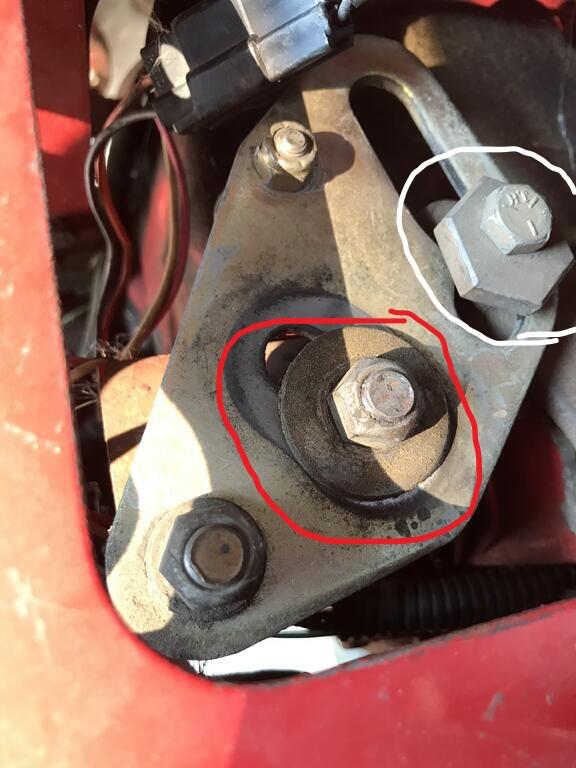

Chuck14025 9 #1 Posted August 15, 2021 I need to hold the control forward to keep full speed ahead. How do I adjust the "control lever Friction adjustment". The manual says "approximately 6 pounds pull". That's no help. I'm not able to find the "Repair" manual. 1 dozen donuts to the first one with the correct answers. Share this post Link to post Share on other sites
lynnmor 9,042 #2 Posted August 15, 2021 Adjust the nut under the seat, see the Owners Manual page 15. The 520H wasn't made in 1983. That friction device should not be lubricated, if it is disassemble and clean it with parts cleaner. Where do I get the donuts? 5 Share this post Link to post Share on other sites
squonk 48,157 #3 Posted August 15, 2021 I'll take 2 plain Old-Fashioned please! You need to check the surface of the linkage cam where the plate rides. The plate wears a groove in the cam and it will throw off the adjustment. Look at the cam where the longer slotted hole rides under the funky looking nut.. Share this post Link to post Share on other sites
Ed Kennell 47,401 #4 Posted August 15, 2021 The first year for a 520H was 1988. The '88s and '89s had the motion control on the console. The 1989 and newer are on the steering column. I'll take an apple fritter if Lynn and Mike don't eat em all. 1 1 Share this post Link to post Share on other sites
Chuck14025 9 #5 Posted August 16, 2021 "Adjust the nut under the seat". Adjust it how? My owner's manual doesn't say how. Do I tighten it or loosen it? The manual calls for 6 pounds pull; pull on what? Is the manual referencing 'pull' on the shift control lever? If so, that is not the problem and adjusting the 'nut', is not the solution. The problem is that the machine does not go forward at full speed unless I hold the shift control lever forward. Could it be a linkage that needs adjusting? Share this post Link to post Share on other sites
Darb1964 1,174 #6 Posted August 16, 2021 You may need to adjust the break. Share this post Link to post Share on other sites
lynnmor 9,042 #7 Posted August 16, 2021 8 hours ago, Chuck14025 said: "Adjust the nut under the seat". Adjust it how? My owner's manual doesn't say how. Do I tighten it or loosen it? The manual calls for 6 pounds pull; pull on what? Is the manual referencing 'pull' on the shift control lever? If so, that is not the problem and adjusting the 'nut', is not the solution. The problem is that the machine does not go forward at full speed unless I hold the shift control lever forward. Could it be a linkage that needs adjusting? Turn the nut till it works. Share this post Link to post Share on other sites
oldlineman 1,810 #8 Posted August 16, 2021 you need to tighten the nut with the large washer clockwise ,won't take much, tighten till the control handle stays put. Do not lubricate that area! Bob Share this post Link to post Share on other sites
WHX?? 58,218 #9 Posted August 16, 2021 (edited) This one here Chuck in red. The one in white adjusts the forward reverse travel and adjustment is in the manual also. I like to take the assembly off and clean it well. Edited August 16, 2021 by WHX?? 2 Share this post Link to post Share on other sites
squonk 48,157 #10 Posted August 16, 2021 32 minutes ago, WHX?? said: This one here Chuck in red. The one in white adjusts the forward reverse travel and adjustment is in the manual also. I like to take the assembly off and clean it well. And make sure the cam isn't worn! Share this post Link to post Share on other sites
Chuck14025 9 #11 Posted August 16, 2021 Ok, I'll try the nut in 'red'. I have the manual but it does not say what does what? Once I figure out the adjustment, I'll take it apart and clean it up. Share this post Link to post Share on other sites
Chuck14025 9 #12 Posted August 29, 2021 Thanks for the help guys. I adjusted the nut in red just a touch clockwise and that has helped some. I have the owner's manual that fits the machine but the manual does NOT say what nut does what or HOW to adjust them. The owner's manual is not a SERVICE manual. If there is a service manual can anyone tell me how to find one. '94 520H. Share this post Link to post Share on other sites
