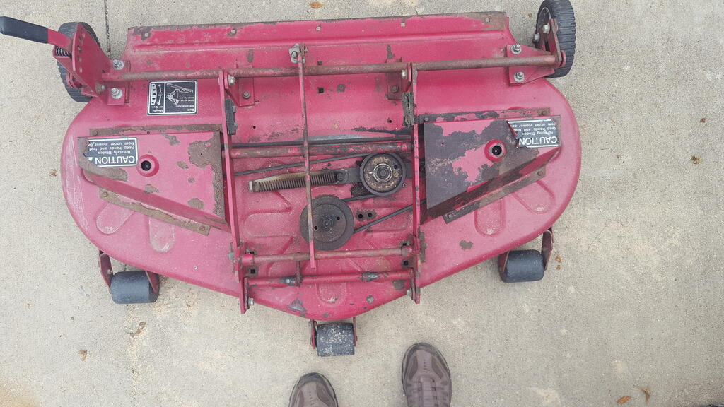

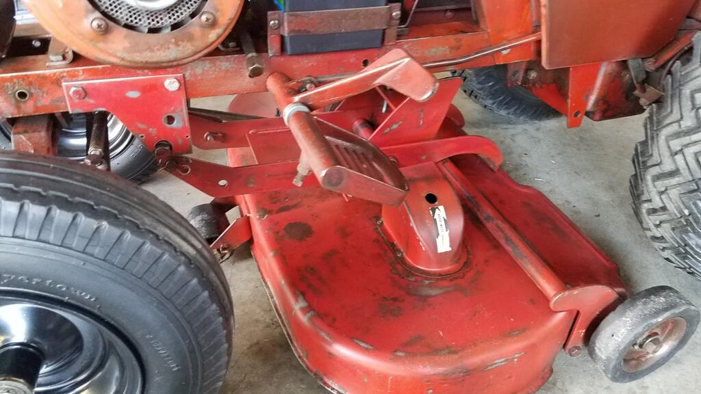

Gregor 4,848 #1 Posted August 14, 2021 I have 2 mower decks, and I'm afraid I don't know which tractors they came from. This one measures 36" across, and is a read discharge. I think maybe it came from my 876. Does it look right for an 876? The next one is also read discharge. It measures 45"wide. I don't know if it came from a C series or not. I think it would almost have to, because I have the 876, a 656, a C-125, C-141, and a C-175. Will this deck fit any C series? I can't find any numbers on either of them. Thanks Greg Share this post Link to post Share on other sites
oldlineman 1,814 #2 Posted August 14, 2021 not sure about the first one Greg but the second one is a 42 in that fits a c series. I have that one and put it on a 1979 c-101 and a 1989 414-8. Bob 1 1 Share this post Link to post Share on other sites
rjg854 13,404 #3 Posted August 14, 2021 Yes that 1st deck should fit a short frame tractor. 1 Share this post Link to post Share on other sites
ri702bill 13,190 #4 Posted August 14, 2021 Gents: The first one is a 36 inch gear drive and as mentioned above fits Round Hoods (not Lawn Rangers) and other short frame tractors. I have pretty much the same deck on my 854. Bill 1 Share this post Link to post Share on other sites
Zeek 2,299 #5 Posted August 14, 2021 32 minutes ago, ri702bill said: Gents: The first one is a 36 inch gear drive and as mentioned above fits Round Hoods (not Lawn Rangers) and other short frame tractors. I have pretty much the same deck on my 854. Bill I had the same deck (first one) on my 1962 552. 1 1 Share this post Link to post Share on other sites
squonk 48,215 #6 Posted August 14, 2021 (edited) The first deck came on the later short frames but they will fit all the way up to the 61 701. The earlier decks had the 2 rods to adjust the belt tension. Edited August 14, 2021 by squonk Share this post Link to post Share on other sites
ri702bill 13,190 #7 Posted August 14, 2021 Squonk: Yup, I have one too - what I refer to as the "Suitcase" deck. Used it one season, did not really care for how it cut. Replaced it with a 32" round corner deck, then the 36" version. Bill Share this post Link to post Share on other sites
gwest_ca-(File Mod) 12,510 #8 Posted August 14, 2021 The 42" RD deck will be one of these. Some of the differences in models is noted Mower DNA 1976 model 65-42MR01 replaced by - (Has the flat spindle belt idler pulley mounted on a triangular plate.) - (Has multi-link hardware at the gauge wheel support) 1977 model 75-42MR01 - Both use blades with 5/8" x 3/4" double-D center hole unless the spindles have been upgraded. (Has the flat spindle belt idler pulley mounted on a triangular plate) - (Has multi-link hardware at the gauge wheel support) ---------------------------------------------------------------------------------------------------------------------------------------------------------------------------------------------------------------------------------------------------------------- These all use blades with 3/4" center hole. 1977 model 75-42MR02 replaced by - (Has the flat spindle belt idler pulley mounted on a flat bar) (Has multi-link hardware at the gauge wheel support) 1978 model 85-42MR01 - (Has the flat spindle belt idler pulley mounted on a flat bar) (Has multi-link hardware at the gauge wheel support) 1979 model 95-42MR01 - No ipl available 1979 model 95-42MR02 - (Has no multi-link hardware at the gauge wheel support) 1980-1983 model 05-42MR01 1984 model 05-42MR02 - Last year for bearings with 3/4" ID 1985 model 05-42MR03 - First year for bearings with 17mm ID unless older spindles were updated. 1986-1988 model 05-42MR04 1989-1990 model 15-42RC01 1990-1992 model 15-42RC02 1993-2012 model 78350 Note - 17mm is .669" 1 Share this post Link to post Share on other sites
Gregor 4,848 #9 Posted August 14, 2021 Took a screen shot of that. Hopefully I will have it forever. Share this post Link to post Share on other sites
gwest_ca-(File Mod) 12,510 #10 Posted August 14, 2021 Just copied it from our Files. If you want more just search the Files for DNA. Then look through the search results to find what you want. They will be in a random order. https://www.wheelhorseforum.com/search/?q=dna&quick=1&type=downloads_file Garry 2 Share this post Link to post Share on other sites
