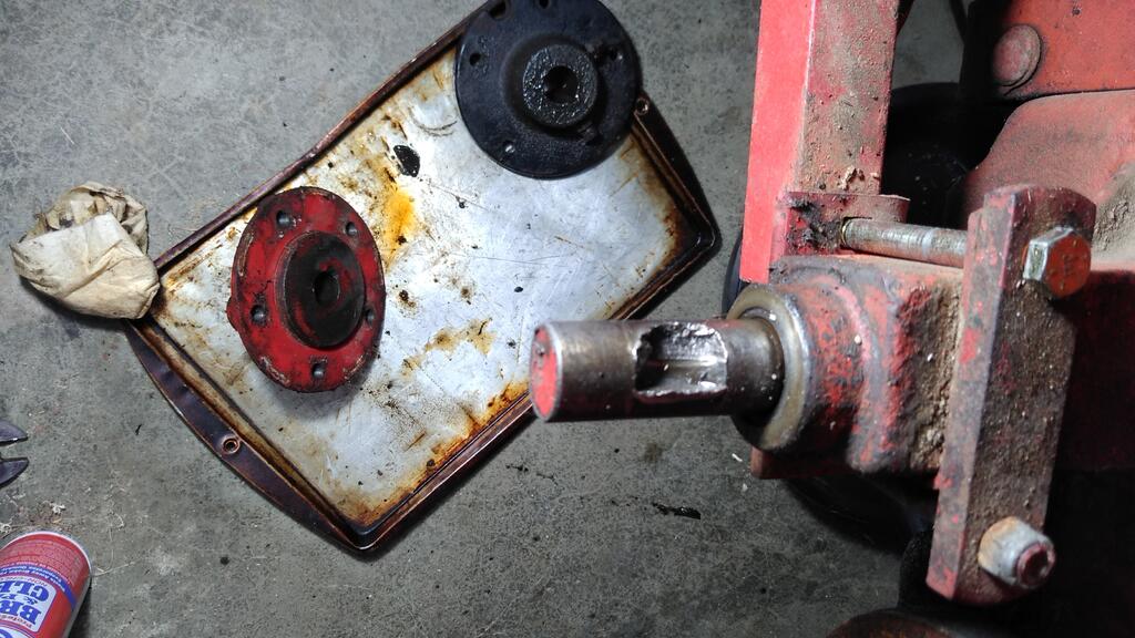

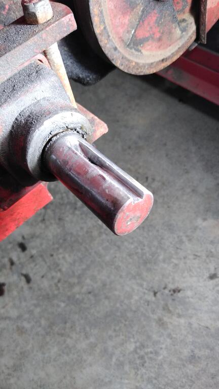

Bentoolong 94 #1 Posted August 14, 2021 I recently acquired this C-120 and found that I have a bad hub and axle. I think the hub is worn to the point where it is not salvageable by me. I'd like to find a new 1-1/8" hub and use that. The axle is another matter. A PO installed a large bolt that broke off in the hub. I was unable to remove it until I did some drilling on the left over piece. I got the hub off and found this carnage. The axle must be harder than the hub because I mic'd the axle and it is within a few thou of 1.125 in most locations. The pics tell the rest of the story. I'd like to take a file and flatten the shaft as much as possible. The keyway is another matter. I'm not sure on the length of the "keys" on these axles but I am hoping with a little work I could refit one and then maybe reinforce the side with some JB weld as well as add another set screw. I don't weld or have access to a machine shop. Is this a good plan? I don't care to split the tranny and install another axle. I know others have had the same issues and I'm open to other suggestions. Thanks Bentoolong What size are the keys on this model? 3 Share this post Link to post Share on other sites

rmaynard 16,690 #5 Posted August 14, 2021 As the pictures show, there is enough torque at the junction of the hub/axle/key to tear up a hardened steel axle. JB Weld would not stand a chance. Pull the axle and replace it or find another transmission. 2 Share this post Link to post Share on other sites

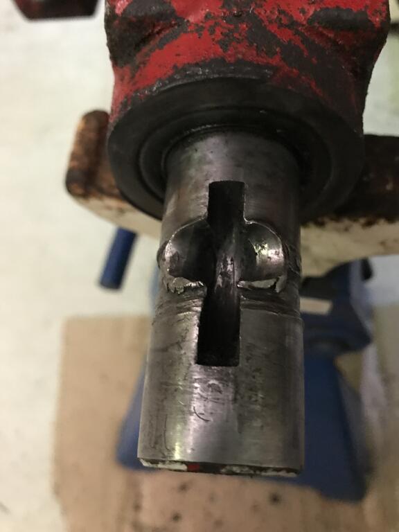

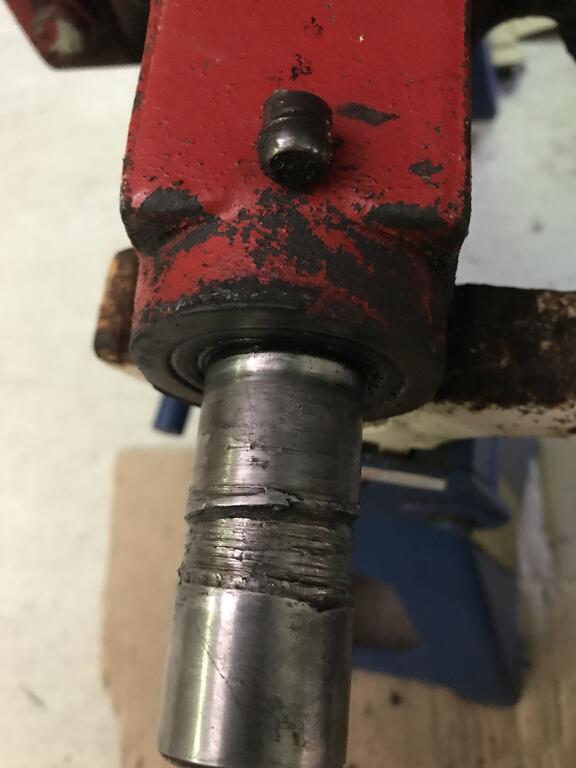

edgro 680 #10 Posted August 14, 2021 This is what i did. It would have been smarter to cut the new keyway on the opposite side of the axle. Weld very slow with cooling off periods. Do not get axle hot. 2 Share this post Link to post Share on other sites
