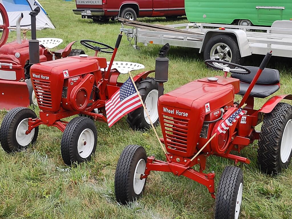

Snoopy11 5,731 #10 Posted August 22, 2021 On 8/14/2021 at 7:53 PM, graywolf1939 said: Don't mind me... I'm just here to copy the flag holders on the front of that horse... Found my next project... Don 1 Share this post Link to post Share on other sites
