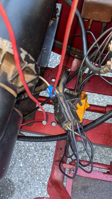

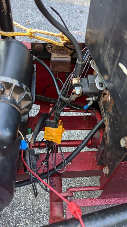

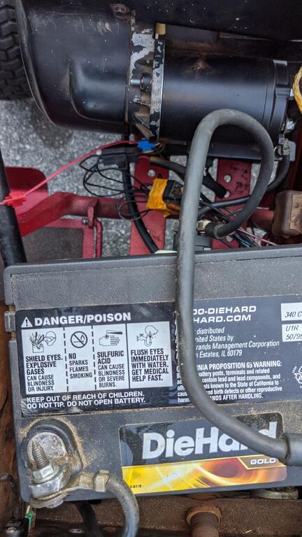

RITEK 25 #1 Posted August 12, 2021 I had redone the electrical on my WH and I had put a kill switch where I put the wire connection as seen in the photos and was wondering if and how I could wire this up to the keyed switch Share this post Link to post Share on other sites
gwest_ca-(File Mod) 12,489 #2 Posted August 12, 2021 Guessing this is what you have. Be real careful with the dark blue wire going to the magneto ignition. If this sees any battery voltage the ignition coil will burn up. Best to leave it disconnected and isolated until everything else is working. That is the wire the ignition switch uses to shut the ignition off. Garry 2 Share this post Link to post Share on other sites
953 nut 69,551 #3 Posted August 12, 2021 It is a bit difficult to tell from the photos what wires you are showing. Is the key switch you want to connect to a magneto switch (one of the terminals has a "M")? To properly connect the key switch to the Magneto you will also want to include the safety switches ( PTO and Seat switches) to maintain safety. Share this post Link to post Share on other sites
RITEK 25 #4 Posted August 12, 2021 I have no idea what I'm doing I have thrown out all the safety switches when I had redone the wiring so all I have is the stuff to start it run it and turn it off and show.voltage on the voltage meter. Could someone guide me through what I need to do. I think I had to make a kill switch because when I disabled those it wouldn't start. Please help 1 Share this post Link to post Share on other sites
