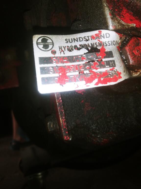

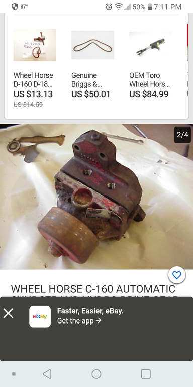

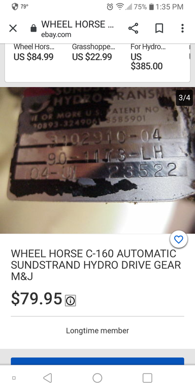

Wh d200 1 #1 Posted August 12, 2021 Hello I was trying to get some help with my d200. The HYDRO DRIVE GEAR went out. I found a HYDRO DRIVE GEAR from a c160 that looks the same but didn't want to buy it and it not be the right one. The tag with the red paint is off my d200 Share this post Link to post Share on other sites
daveoman1966 3,884 #2 Posted August 12, 2021 (1st) The C-160 has Sundstrand model 90-1140 for years 74 the 77....NOT 90-1173. (2nd) the C-160 series does NOT employ the brake drum as shown in pics. (3rd)...According to my files, only the 'D' series uses the Sundstrand model 90-1173 (1978 & 79) and the prior model was 90-1137 (1974 thru 77). So, it appears to me that the Ebay listing 'From a C-160' is misleading b/c the Hyd Motor shown is likely from a 'D' series tractor with Sundstrand model 90-1173. Conclusion: I think the E-bay listing will provide you with the correct Hydro Drive Gear...inasmuch as BOTH tags (your D-200 & the E-bay listed C-160) identify it as a 90-1173 model. Still, it is YOUR $80 bux.... 2 Share this post Link to post Share on other sites
