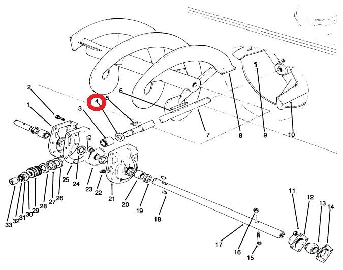

JD guy 1 #1 Posted August 11, 2021 To change the quad ring 237-87 on auger input shaft is it necessary to split the peerless right angle gearbox? Share this post Link to post Share on other sites
gwest_ca-(File Mod) 12,453 #2 Posted August 11, 2021 Had to look it up as have never heard of it - item #4 part number 237-87 I will guess the case must be split because Woodruff key #5 will key gear #29 to the shaft and quad ring #4 likely won't go over the key. Unless the quad ring #4 can be installed from the rear of the shaft. Share this post Link to post Share on other sites
