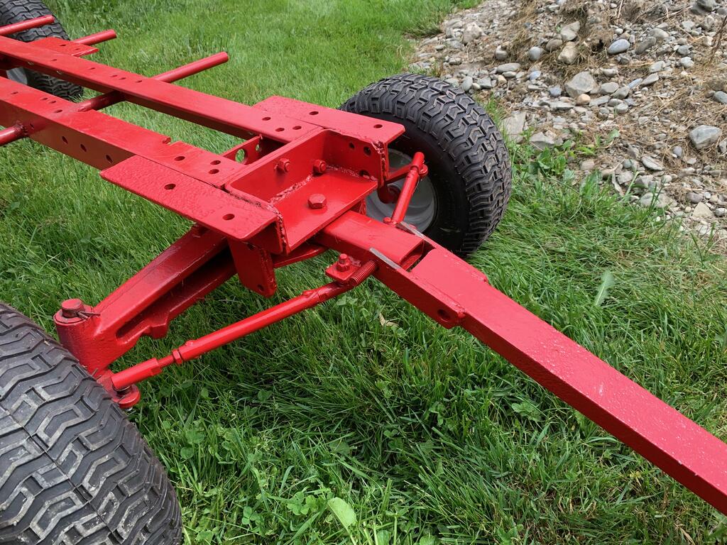

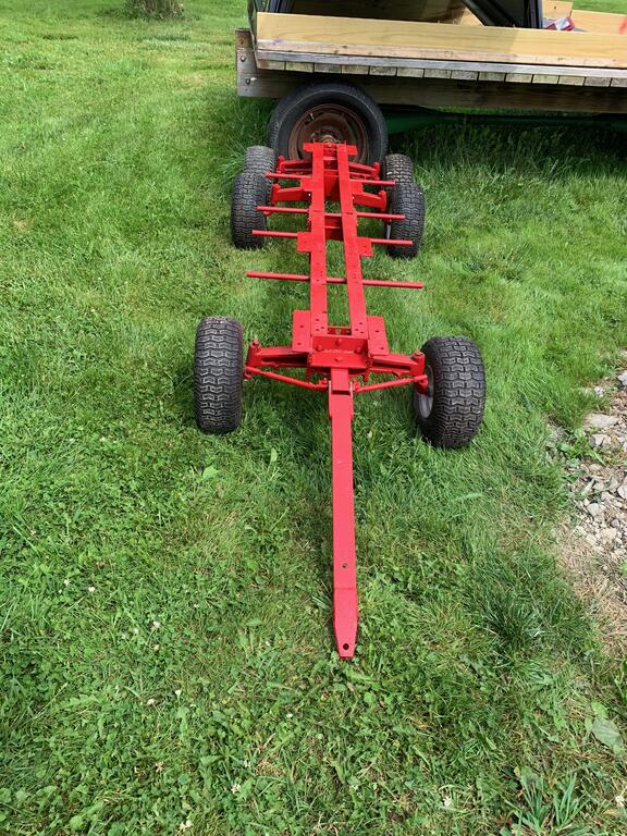

IthacaJeff 151 #1 Posted August 10, 2021 (edited) Hi Folks: For many years I have wanted to do this, and Covid gave me the chance. I had a spare frame with front axle and wanted to turn it into a wagon. Well, a total of 3 frames and 3 axles went into this, but it mostly served as a way to learn to weld. Bought a welder (Forney 140 Fci Easy Weld), practiced, then decided to dive in. I am a crummy welder, but as long as it holds I am fine. Two frames bolted and welded butt end to butt end, and there ya' have it. Had to purchase some steel plate, the rest of the metal is scavanged from WH tractors and an old spring tine harrow I had. The tongue is entirely from really old metal from the harrow -- perhaps 80 years old? The wood deck is obviously not yet on, that should be the rest of this week. In the background is a 1940/50s JD wagon, I believe to be a 963 or 953. Edited August 10, 2021 by IthacaJeff 9 11 Share this post Link to post Share on other sites
IthacaJeff 151 #2 Posted August 10, 2021 More pics. 5 2 Share this post Link to post Share on other sites

IthacaJeff 151 #4 Posted August 10, 2021 (edited) More pics. BTW, cost nealry $300 thus far, not including welding supplies and grinding disks. Uggh. Grinding dust all over the place. Frames/axles ~ $60 (from WH members) Extra steel ~ $45 (local supply) Wheels ~ $40 (not all WH, from WH member) 4 tires ~ $60 (Carlisle, Amazon) Paint ~ $30 (Rustoleum and Majic rattle cans, primer, paint, and rust converter). Hardware ~ $20 Tie rods ~35 (from a WH member, tried making my own. . .fail) I have the 4 x 4 lumber for the deck support, will need to buy a couple more 2 x 6s. Edited August 10, 2021 by IthacaJeff 15 Share this post Link to post Share on other sites

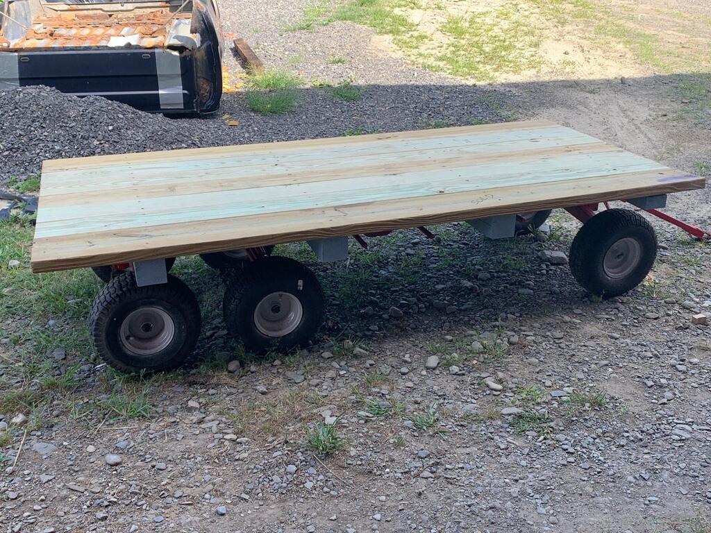

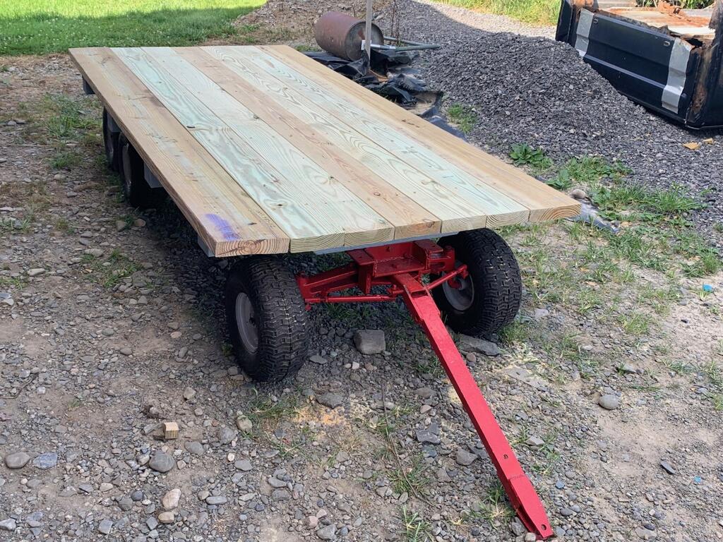

IthacaJeff 151 #14 Posted August 16, 2021 (edited) Got the flatbed on this weekend. Pulls nicely. Stake sides will need to wait until . . . .uggh, whenever. Right now it is sitting in the garage with a dining table on top of it. . . my wife is using it as a platform to refinish the table. Edited August 16, 2021 by IthacaJeff 1 5 Share this post Link to post Share on other sites

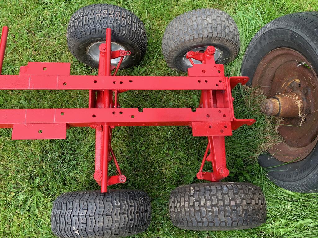

Pullstart 71,482 #15 Posted August 16, 2021 So cool! With 3 front axles, does it pivot or tip? Did you limit the movement side to side somehow? also, I’m guessing the rear tie rods are welded or bolted solid so the rear tires don’t steer? Share this post Link to post Share on other sites

IthacaJeff 151 #18 Posted August 17, 2021 (edited) A bit more info on the rear axles. They are fixed from steering using short fixed tie rods (see 2nd pic). I tried other methods, like connecting the steering arms all together, but there was too much slop. The axles also do not pivot, only the front steering axle pivots. The non-pivoting rear axles prevents the deck load from pitching side to side. Being able to pivot but with no real suspension there is too much floppiness.The pivot restraint was made by adding blocks under the existing axle bump stop pads. Edited August 18, 2021 by IthacaJeff 3 Share this post Link to post Share on other sites
