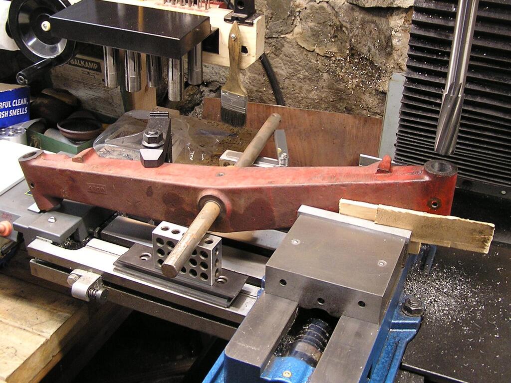

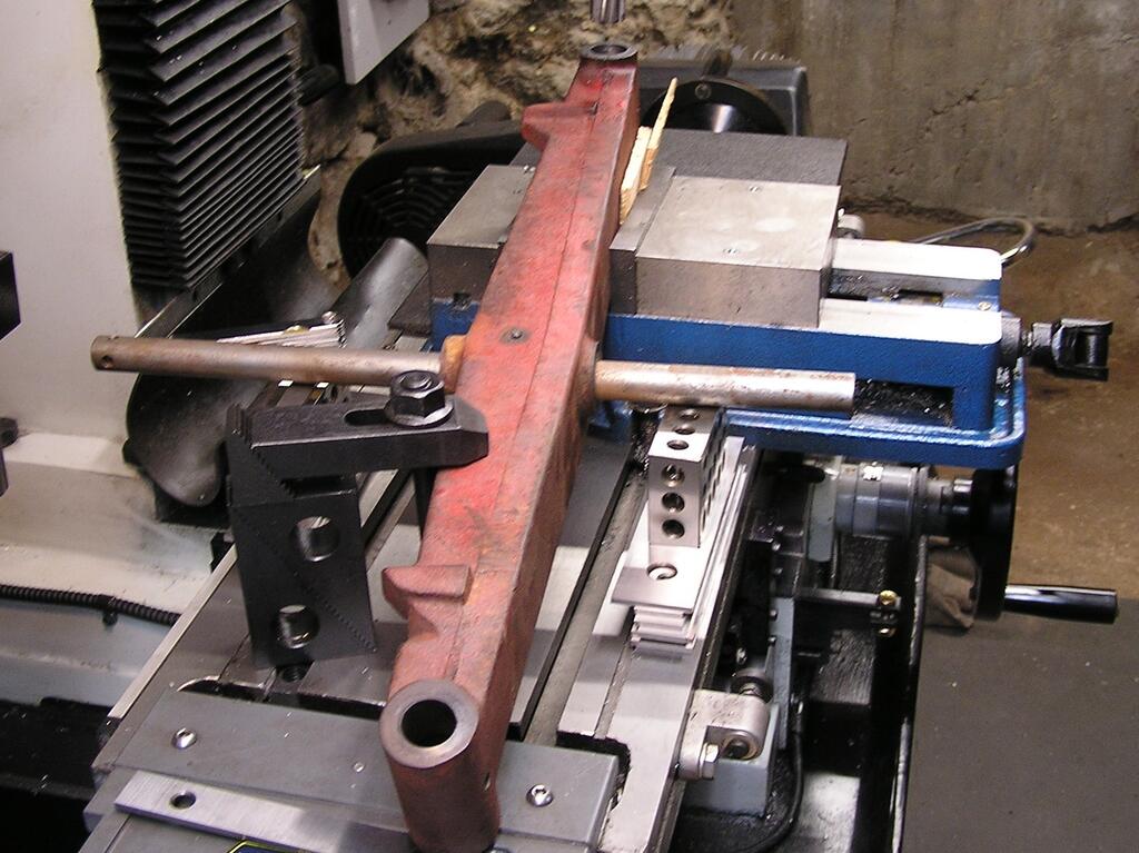

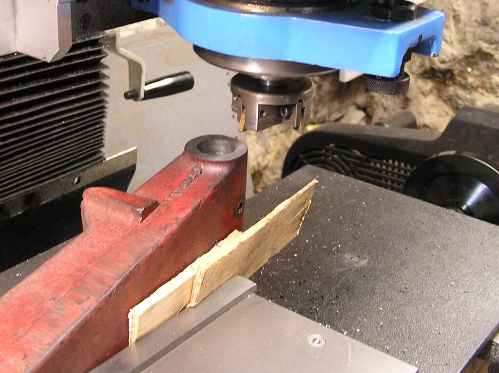

ri702bill 13,271 #8 Posted August 14, 2021 All: Here are a few pictures of the setup I used. I drilled and reamed the pivot hole first, installed the bushings and used it with a piece of cold rolled as part of the setup so the spindle bores would be perpendicular to it. The last picture is after I flycut 1/8" off the bottom boss. I will be using a 1/8" thick bronze washer - needle bearings require the hardened washers on either side - not sure grease would get in there by the washer. Pacer - you were right about the setup being a challenge as this is a cambered axle - fixing my 702 non cambered axle should be easier. Bill 2 Share this post Link to post Share on other sites
