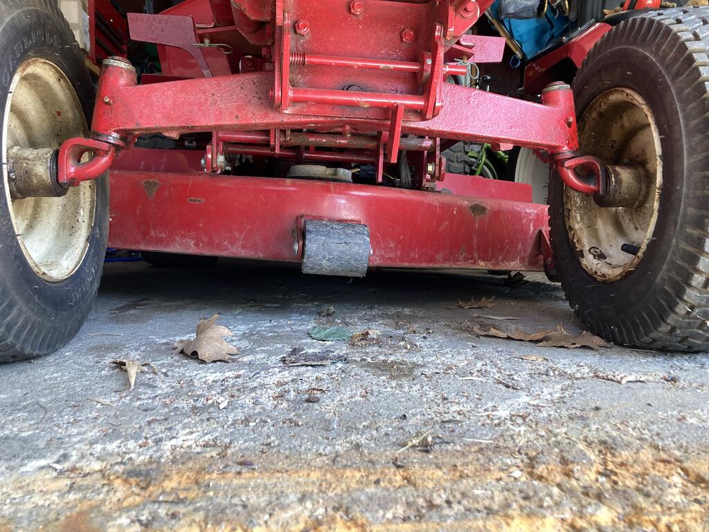

peter lena 9,231 #58 Posted December 16, 2022 @uglyblue66 referring to your lift lever , issue , look up the schematic drawing for that , looks common . remove your " shifter plate " on the console , aerosol penetrating oil with small tube extension get into the related bushing end points , also at each side of the transmission tunnel , make the rust run out . squirt into the top of lift lever , as well as all related linkage areas , typically neglected , any rust / dry spot will hang it up . notice there is no grease on your front axel spindle points , or center axel swing / mount point , typically emphasize lubrication related issues , that reinforced front axel , is so worth some green grease . would love to recover / lubricate that set up , you are looking right at it , pete 2 Share this post Link to post Share on other sites
