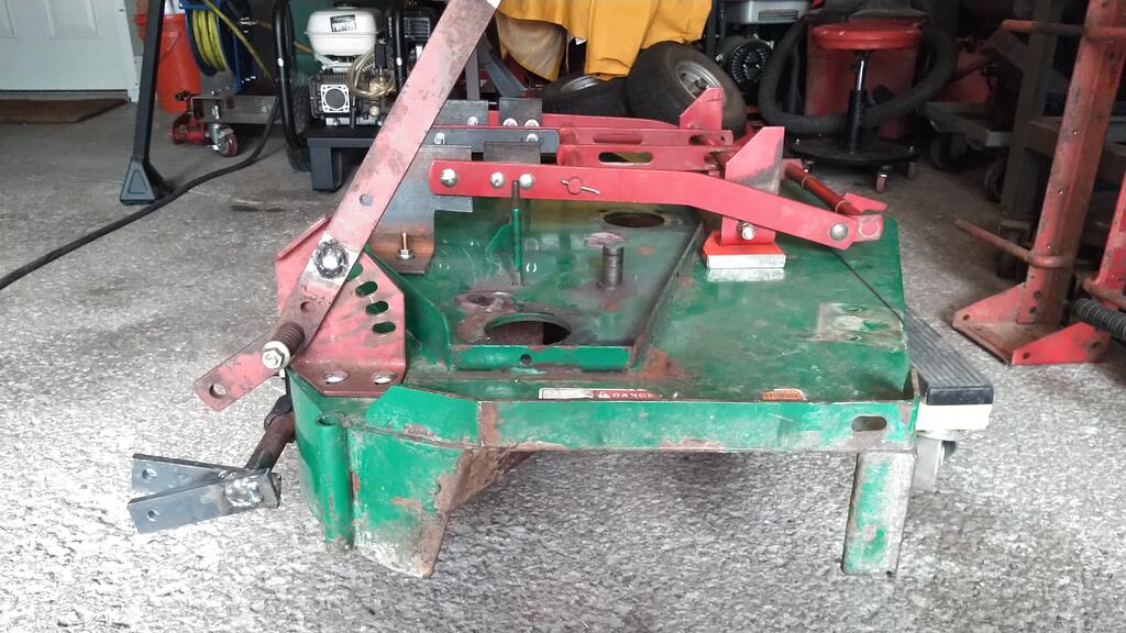

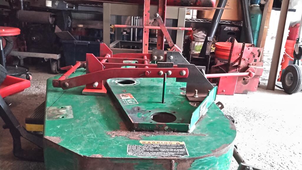

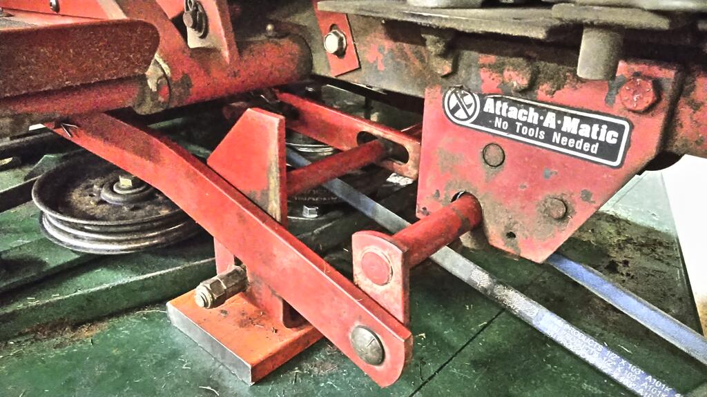

Bill D 3,064 #27 Posted August 29, 2021 I made some progress today. Most of the fab work to mount the deck is done. Gauge wheel bar is finished. I have to pick up two 1/2" Heim joints to connect the height adjuster to the gauge wheel bar. I'm fighting with a spindle that won't come apart at the moment. I plan to rebuild them with new bearings at some point. For now I plan to take the spindles apart and remove the inner grease seals from the bearing and add grease fittings to the spindles. For some reason Bobcat doesn't want you to be able to grease their spindles. Next up is new pulleys and front anti scalp roller brackets. 4 Share this post Link to post Share on other sites

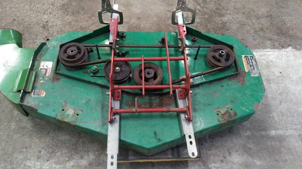

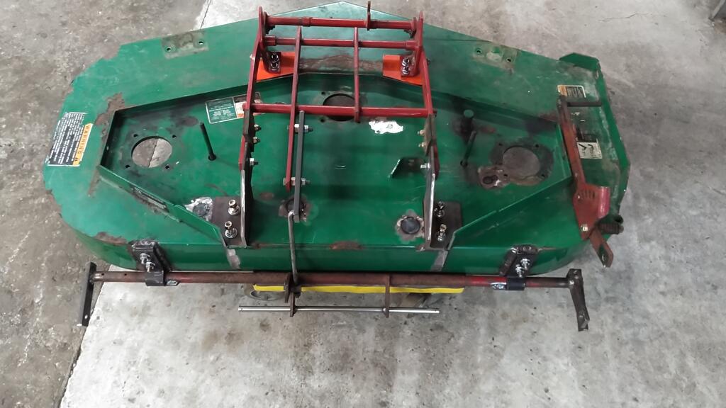

Bill D 3,064 #31 Posted August 29, 2021 More pictures. Some trimming of the rear mounting brackets may be needed. Share this post Link to post Share on other sites

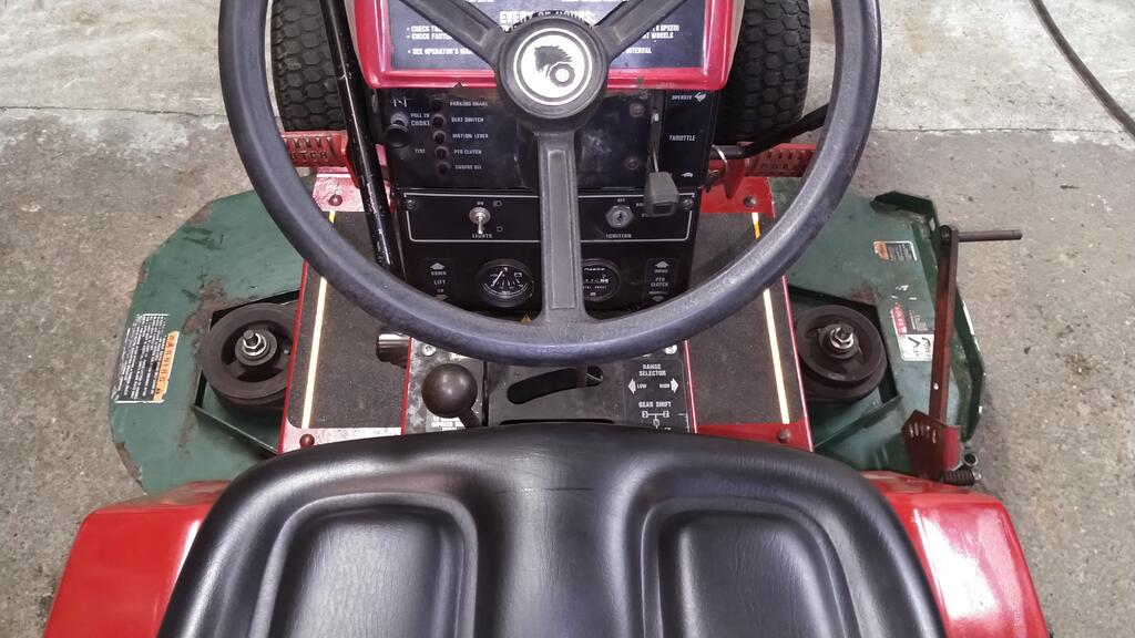

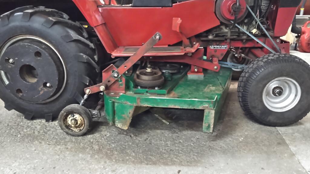

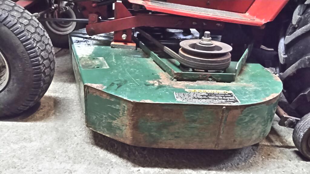

Bill D 3,064 #34 Posted September 4, 2021 I got the deck under the tractor today. It's heavy. I was able to take a pulley from harbor freight and cut it down and stack it on top of one of the OEM pulleys. I keyed the two pulleys together. I'll try it out tomorrow. I will have to trim the deck as the front tires rub. Stay tuned. 1 Share this post Link to post Share on other sites

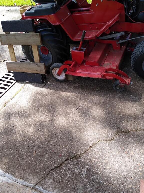

kpinnc 18,859 #35 Posted September 4, 2021 Looking awesome Bill! Using mine regularly now, and I love it. Can't wait to hear how yours works for you! 1 Share this post Link to post Share on other sites

Bill D 3,064 #37 Posted September 4, 2021 I had to shorten the lift rod by an inch. It was hitting the center spindle nut. The cross rod was rotted where it connects to the frame, so I cut the old one out, shortened the bar an inch and welded in a new cross rod. I've seen that other people have problems with the grease fitting on the OEM decks hitting that rod, perhaps that would be a good way to fix the problem. 2 Share this post Link to post Share on other sites

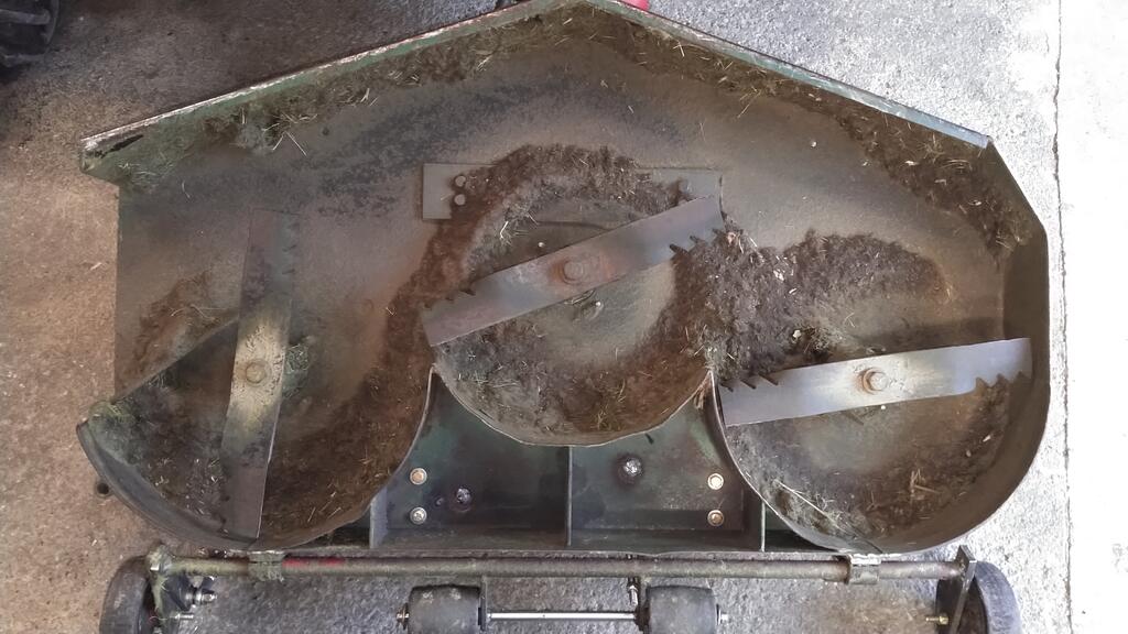

Bill D 3,064 #38 Posted September 6, 2021 I got a chance to mow with it. Sounds much different than the OEM deck. The cut quality is great, however there are more clippings built up on the engine intake screen then there was with a stock deck. The deck has gator blades on it and doesn't have front baffles like the Exmark deck @kpinncused for his build. I have to trim the front of the deck to stop the front tires from rubbing when I turn. I plan to add a baffle to the left side. Hopefully reshaping the deck shell and adding a baffle will improve air flow. I may also change to high lift blades. In addition I will be adding much needed front anti scalp wheels. 2 Share this post Link to post Share on other sites

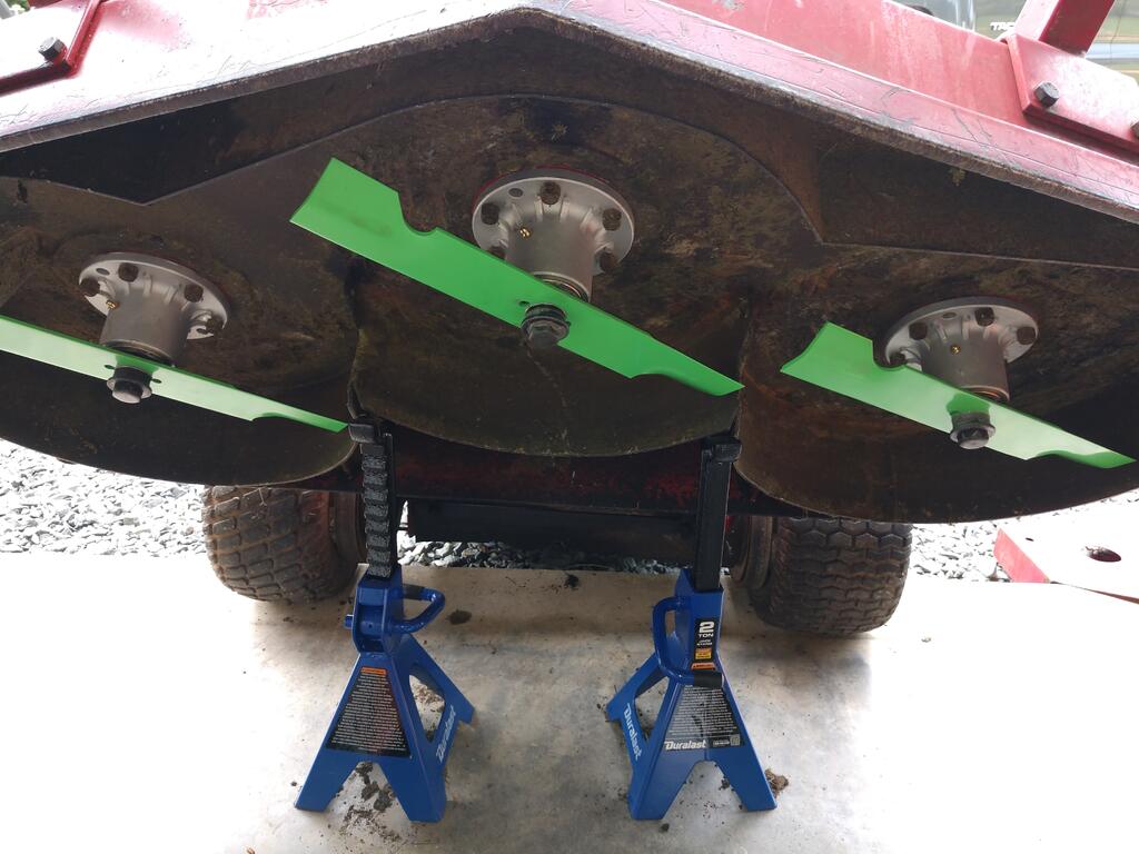

kpinnc 18,859 #41 Posted September 6, 2021 9 minutes ago, Bill D said: Seems like a much better starting point. The Exmark deck that @kpinnc used is probably a better choice as well. The spindles have grease fittings unlike mine. I do think my belt tensioner setup is superior however. Oddly enough, my spindles have grease fittings on sealed bearings. The complete spindles are cheaper than bearings alone, so I didn't remove the seals. I didn't realize that your deck didn't have baffles. Don't give up on it. When you get it completed, it will last forever, and does an awesome job. ...and I want to see that tensioner. I don't see any pics that clearly show it. Share this post Link to post Share on other sites

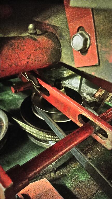

Bill D 3,064 #42 Posted September 6, 2021 14 minutes ago, kpinnc said: Oddly enough, my spindles have grease fittings on sealed bearings. The complete spindles are cheaper than bearings alone, so I didn't remove the seals. I didn't realize that your deck didn't have baffles. Don't give up on it. When you get it completed, it will last forever, and does an awesome job. ...and I want to see that tensioner. I don't see any pics that clearly show it. Here is the only picture I have that shows the tensioner. It's slightly modified from it's original form. It uses a J hook bolt to tighten the belt. I will take a better picture in the future. Share this post Link to post Share on other sites

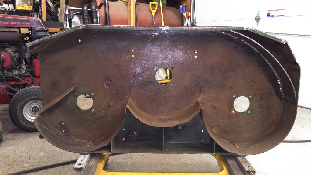

kpinnc 18,859 #43 Posted September 6, 2021 (edited) Yep, that's definitely better than mine. I used a WH one, which is fine except it is very limited on movement. If you decide to put baffles under at least the left side, here is the best pic I have of mine. Maybe even a more direct shape like the front of a WH deck might be helpful? It would still be 3-4 inches back from the front. Edited September 6, 2021 by kpinnc Share this post Link to post Share on other sites

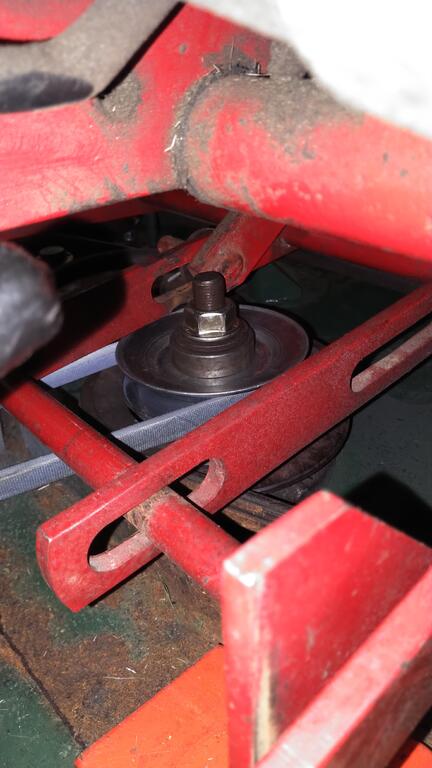

Lee1977 7,744 #44 Posted September 6, 2021 6 hours ago, Bill D said: Here is the only picture I have that shows the tensioner. It's slightly modified from it's original form. It uses a J hook bolt to tighten the belt. I will take a better picture in the future. You might want to use a longer j-bolt with a spring on the back side. 2 Share this post Link to post Share on other sites
Bill D 3,064 #45 Posted September 7, 2021 2 hours ago, Lee1977 said: You might want to use a longer j-bolt with a spring on the back side. I see no reason to change it. The stock setup came with a longer spacer between the arm and the idler pulley. The original setup had the deck belt on top and the belt from the PTO on the bottom. I just replaced the spacer with a shorter one and flipped the pulleys over. 1 Share this post Link to post Share on other sites

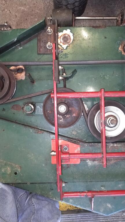

Bill D 3,064 #46 Posted September 8, 2021 Here is a better picture of the deck belt tensioner and the underside of the deck after mowing wet grass. 2 Share this post Link to post Share on other sites
kpinnc 18,859 #47 Posted September 9, 2021 Yep, you need some baffles! There is a video on YouTube where a guy cut the front off a Bobcat walk behind to make a bush hog. Now I understand how easy it was. That is actually what I had planned for mine a long while ago, but cutting out the baffles was too much. I think you can buy 3 foot long by 4 inch wide plate steel at TSC. 1/8 or even thinner will work. You could bend it and add baffles pretty easy. 1 Share this post Link to post Share on other sites
Bill D 3,064 #48 Posted September 9, 2021 21 minutes ago, kpinnc said: Yep, you need some baffles! There is a video on YouTube where a guy cut the front off a Bobcat walk behind to make a bush hog. Now I understand how easy it was. That is actually what I had planned for mine a long while ago, but cutting out the baffles was too much. I think you can buy 3 foot long by 4 inch wide plate steel at TSC. 1/8 or even thinner will work. You could bend it and add baffles pretty easy. That was the plan. I think regular blades would also help. 2 Share this post Link to post Share on other sites

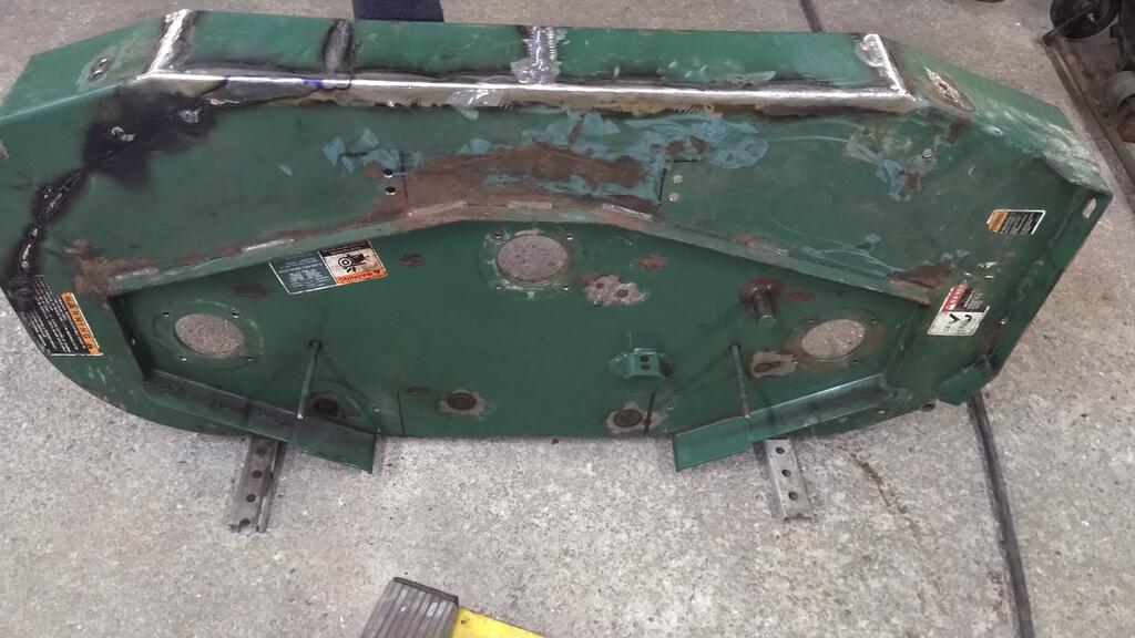

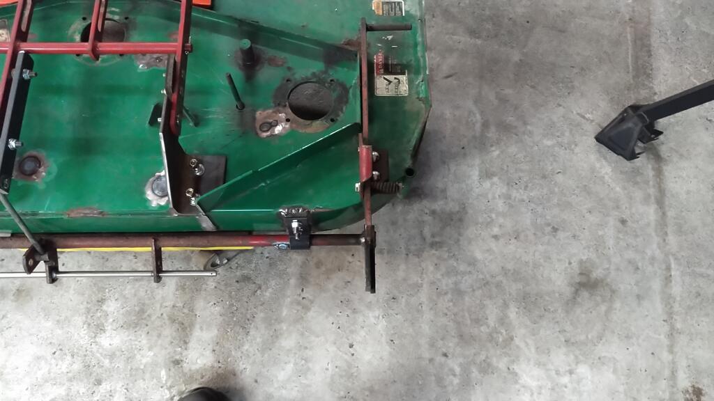

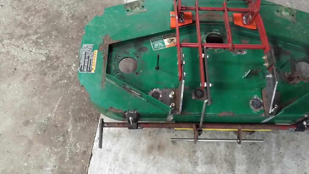

Bill D 3,064 #49 Posted September 11, 2021 (edited) Now that I know it will work under my tractor, I stripped the deck back down to fix a few issues. I cut the nose off the deck and rewelded it. I had to do this because the front tires were rubbing the deck when turning. I decided to weld in only one small baffle on the non discharge side. I don't have a way to roll steel so this was the best I can do by hand. I expect some air flow improvement, especially if I change from Gator blades to high lift blades. Up next are anti scalping wheels for the front and a mount for my trac vac boot. I'm debating on reinforcing the front edge. Any one have an opinion on that. There will be a center anti scalp wheel. Edited September 11, 2021 by Bill D 1 Share this post Link to post Share on other sites
kpinnc 18,859 #50 Posted September 13, 2021 Bill that looks great! I'm betting you won't have as much clippings now on the left side with that baffle in place. So far as reinforcement, mine has a 1 x 1/4 flat bar welded around the front lip from one side to the other. Whether you need it or not really depends on how many roots or other obstructions you have to contend with. Share this post Link to post Share on other sites
