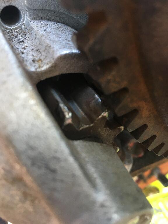

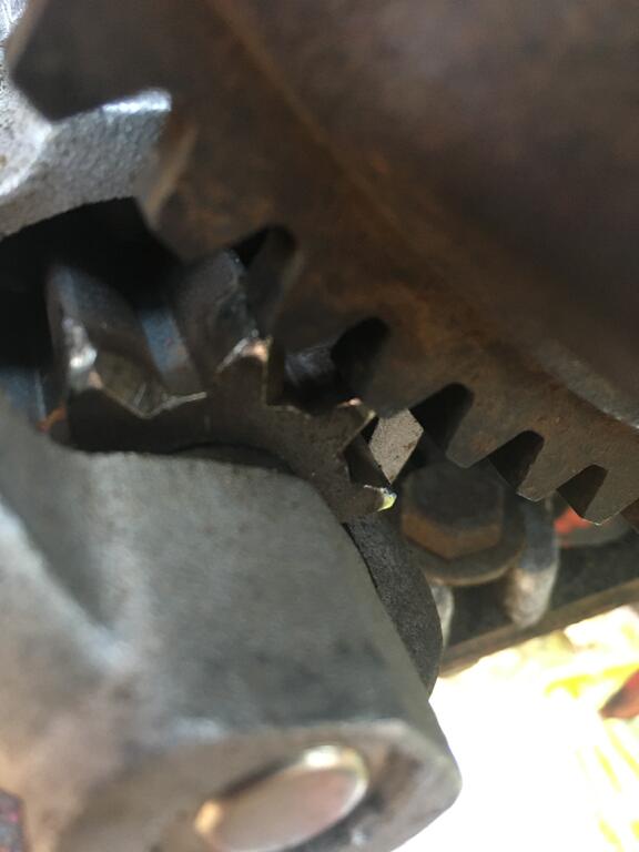

Tuneup 1,452 #5 Posted August 9, 2021 ...or you'll find that the starter is jammed in the flywheel, Good luck! 1 Share this post Link to post Share on other sites
WheelHorse520H 708 #6 Posted August 9, 2021 1 hour ago, Tuneup said: ...or you'll find that the starter is jammed in the flywheel, Good luck! You mean like what I had with a cheap Chinese starter from Amazon on my 520-H… 1 Share this post Link to post Share on other sites

johnnymag3 2,633 #9 Posted August 26, 2021 So I took the entire Flywheel off, ...gapped the coil., it was already good.....Stator is not touching magnets..nothing loose or out of position....I left cooling tin off to view starter....it was perfect.....and fired up M12.....squeal seems like its on the other side of the engine....PTO? Any ideas? engine runs perfect..... Thanks, John Share this post Link to post Share on other sites
