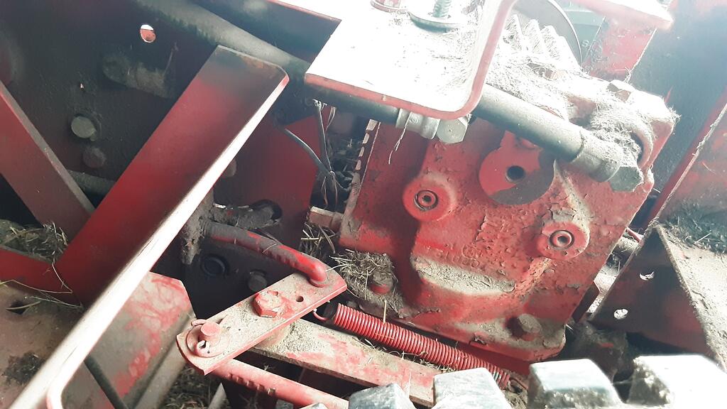

Jon925mn 39 #1 Posted August 8, 2021 Not currently running 1980 C-145 has locked wheels when pushing. Turn freely in opposite direction when jacked up.. Has sundstrand 90 and can't find tow valve. Mine doesn't have the top valve with rod. Only thing I see is the 5/16 extension that doesn't move.. Can someone post a picture of the valve on a 90-1173 LH. Thanks. Share this post Link to post Share on other sites
squonk 48,207 #2 Posted August 8, 2021 I think it's right above the brake rod in your pic. The thingy with the hex shape. If it doesn't move, it's probably stuck. 1 Share this post Link to post Share on other sites
Jon925mn 39 #3 Posted August 8, 2021 That's what I tried to turn but that sucker doesn't move. From it's position in pic which way does it turn and how much? Don't want to force it and there's nothing to soak as it's a sealed extension. Thank you. Share this post Link to post Share on other sites
squonk 48,207 #4 Posted August 8, 2021 You would turn it about a half turn the normal way you would loosen a bolt. I have seen them stuck really bad. If you need to move the tractor and you're on concrete or pavement, you can buy a couple of little furniture dollies from Harbor Freight for about $15 1 Share this post Link to post Share on other sites

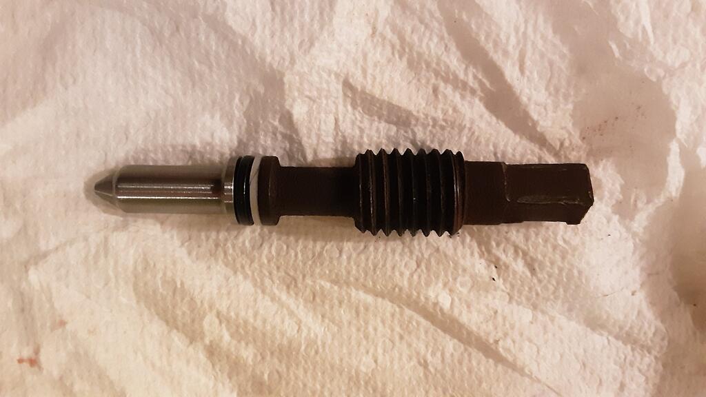

Jon925mn 39 #13 Posted August 9, 2021 I got the bugger out and intact so I'm happy bout that. Can one put anti seize on threads to avoid repeat. Thanks guys for thoughts and tips. 1 Share this post Link to post Share on other sites
pfrederi 21,215 #14 Posted August 9, 2021 9 hours ago, Jon925mn said: I got the bugger out and intact so I'm happy bout that. Can one put anti seize on threads to avoid repeat. Thanks guys for thoughts and tips. Yes, a little never seize is a good thing. Absolutely do not use teflon tape Share this post Link to post Share on other sites
