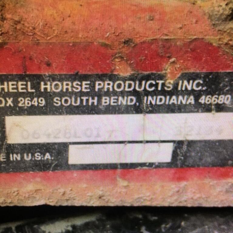

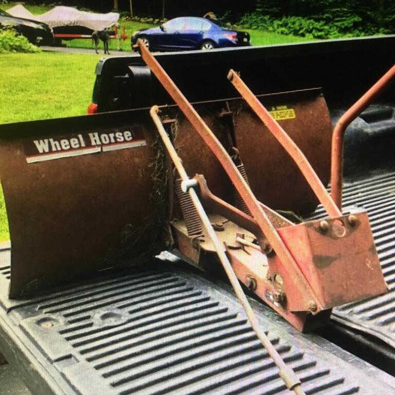

Jrain 276 #1 Posted August 8, 2021 Little help needed again , will this plow fit / mount to my 1973 c120 and if not what does it fit / mount to Share this post Link to post Share on other sites
roadapples 6,987 #2 Posted August 8, 2021 Not made for a C120.... 2 Share this post Link to post Share on other sites
squonk 48,215 #3 Posted August 8, 2021 Fits 200 series tractors 2 Share this post Link to post Share on other sites

Jrain 276 #5 Posted August 8, 2021 (edited) Oh ok so this will fit my 1988 212-5 lawn tractor ID # 3212050 , thanks for the help once again . Edited August 8, 2021 by Jrain 2 Share this post Link to post Share on other sites

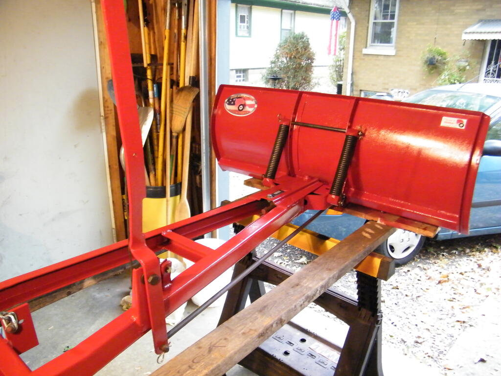

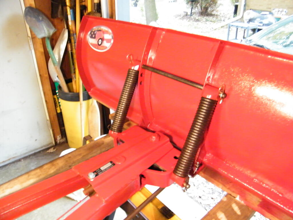

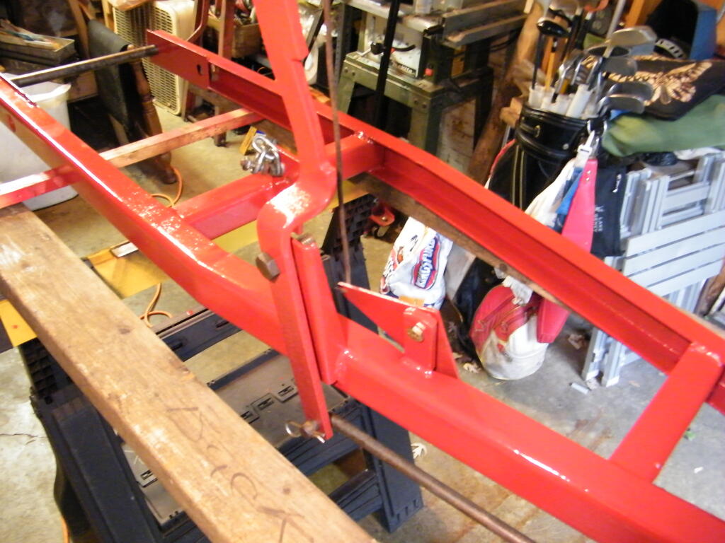

stevasaurus 23,857 #6 Posted August 8, 2021 @Jrain...you need a snow blade that looks like this...not an "A" frame, but one that comes out from an "A" and has about 2' parallel at the end. You can see the blade frame goes all the way back to the transmission and mount on one of those attach-a-matic thingy's on the transmission axle...but see how the frame is an "A" until the last 2 or 3 feet. 2 Share this post Link to post Share on other sites
