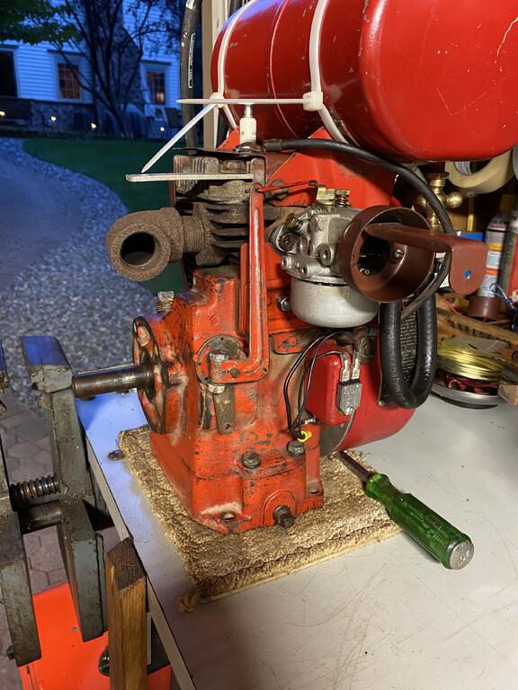

formariz 12,379 #1 Posted August 8, 2021 (edited) Today I set up another K91 that I had here for many years for the first time. Started immediately and runs really nicely. However there are two things with it perhaps related. It is pretty tight when pulling the starter. Also there is a bit of play when pulling crank back and forth. Any thoughts about those two issues ? Any downsides to using it this way? Edited August 8, 2021 by formariz 1 Share this post Link to post Share on other sites
squonk 47,421 #2 Posted August 8, 2021 End play spec is .004- .023" You have way more than that. I would think the bearings are shot and that would also account for the rope being hard to pull. See if you have up and down movement as well. 2 Share this post Link to post Share on other sites
formariz 12,379 #3 Posted August 8, 2021 1 minute ago, squonk said: End play spec is .004- .023" You have way more than that. I would think the bearings are shot and that would also account for the rope being hard to pull. See if you have up and down movement as well. No other play. Just what is shown. Share this post Link to post Share on other sites

squonk 47,421 #5 Posted August 8, 2021 You need to open that up Cas. Pull the pan. Either the bearings have slop between the inner and outer races or the outer races are moving back and forth in the plate and rear bearing boss. 1 1 Share this post Link to post Share on other sites

richmondred01 2,383 #8 Posted August 8, 2021 (edited) I was told by a wise old man when I was a young man “Where there’s smoke there’s fire.” And “Pay me now or pay me later” Both statements have rung true numerous times over my life. That’s not a “bit of play” Too much play. Yes they are related. I personally would not run it until it’s repaired. Time for a tear down. Edited August 8, 2021 by richmondred01 1 1 Share this post Link to post Share on other sites
formariz 12,379 #9 Posted August 8, 2021 Thank you guys . That’s what I thought. I’ll probably open the pan to see what it is. Don’t need to get too deeply into it right now. Fortunately I can just pick another one off the shelf.I was curious about this one since I had never started it before. It actually looks to be one of the oldest ones here. Share this post Link to post Share on other sites
