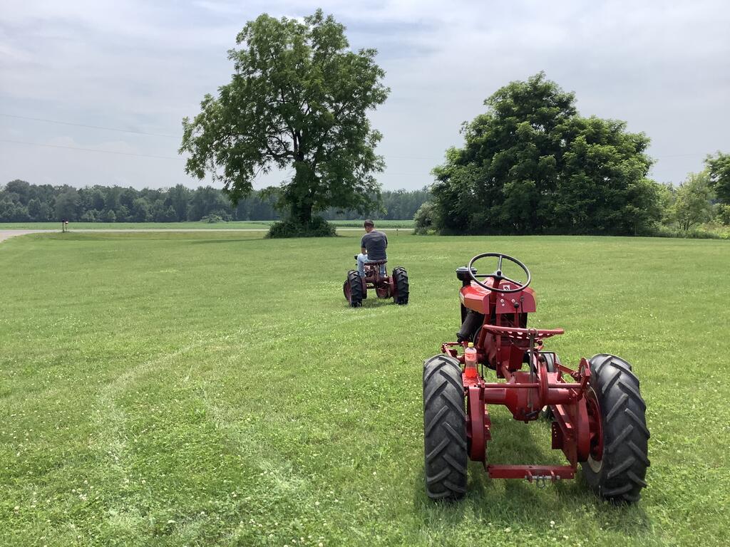

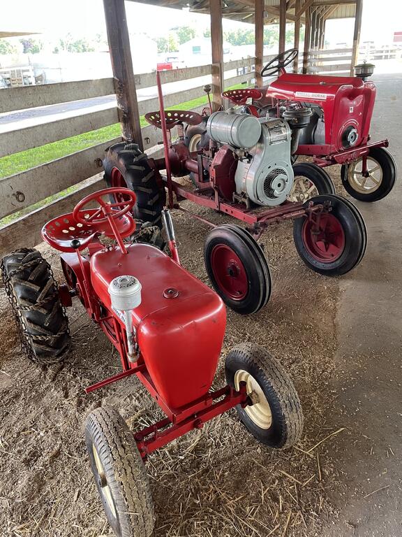

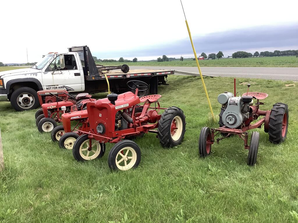

Pullstart 68,860 #10 Posted August 11, 2021 to RedSquare @ModelANut! My wife has a Senior and I have a Lever Steer, they sure are a blast! As @AMC RULES stated, I’ve been told 600W in everything as well. It would be cool to see pictures of your friend’s project. If you need any other help… as you can tell there is quite a bit of commotion on this site and everybody is super helpful! 1 Share this post Link to post Share on other sites
