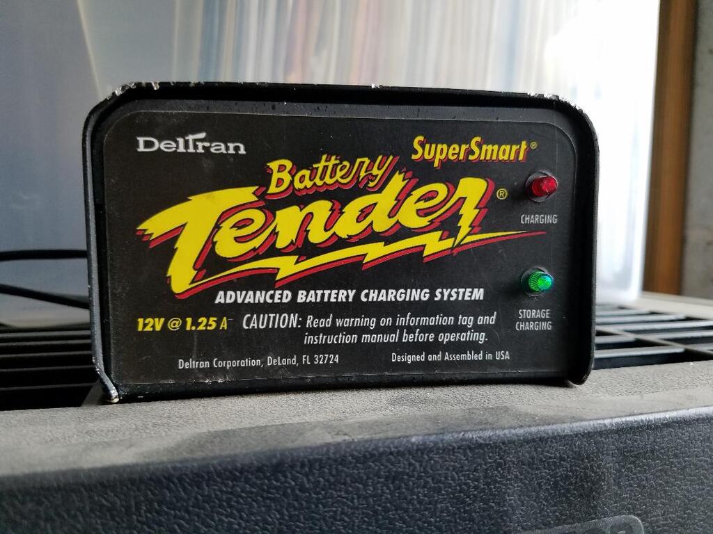

Brockport Bill 2,407 #9 Posted August 7, 2021 thanks all for great feedback -- here is photo of Battery Tender I have used for many years for my SeaDoo batteries during winter when they are in storage - but never charged when they were in the Sea doos - so that's why I wanted to check to be safe if ok to charge WH batteries while hooked up in the tractors? Thanks for info 2 Share this post Link to post Share on other sites

lynnmor 8,875 #12 Posted August 8, 2021 8 hours ago, Brockport Bill said: wonderful suggestion about the connectors - will order - thanks I see you have a good Battery Tender, I use the same one and rotate it between seasonal batteries using the SAE quick connects. I charge each battery about three days per month, just because the green light comes on doesn't mean it is 100% full, it will slowly take some more. Connecting multiple batteries at the same time will not give optimal results, do one at a time. 1 Share this post Link to post Share on other sites
