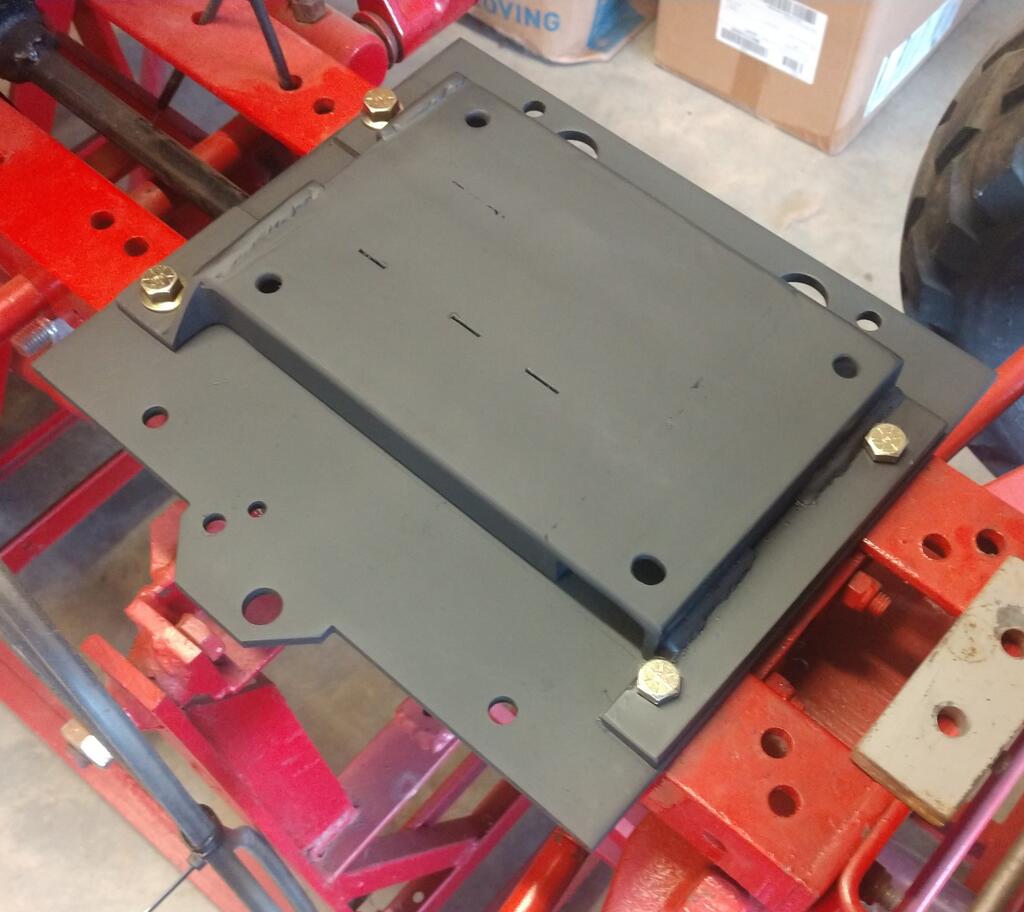

kpinnc 18,340 #102 Posted September 5, 2021 This is what I made today for mine. Had to raise the PTO shaft about an inch, and backspace the block as well. Took the better part of the afternoon, but it's all downhill from here! 2 Share this post Link to post Share on other sites
chipwitch 73 #103 Posted September 5, 2021 23 minutes ago, kpinnc said: This is what I made today for mine. Had to raise the PTO shaft about an inch, and backspace the block as well. Took the better part of the afternoon, but it's all downhill from here! Are those pieces of channel welded together to make it? 1 Share this post Link to post Share on other sites
Snoopy11 5,731 #104 Posted September 5, 2021 23 minutes ago, kpinnc said: This is what I made today for mine. Had to raise the PTO shaft about an inch, and backspace the block as well. Took the better part of the afternoon, but it's all downhill from here! I just mentioned Chip in your High Roller forum @kpinnc... maybe Chip will find it useful... Don Share this post Link to post Share on other sites
kpinnc 18,340 #105 Posted September 5, 2021 1 hour ago, chipwitch said: Are those pieces of channel welded together to make it? Yes sir. 1 inch by 2 inch. 1 Share this post Link to post Share on other sites
