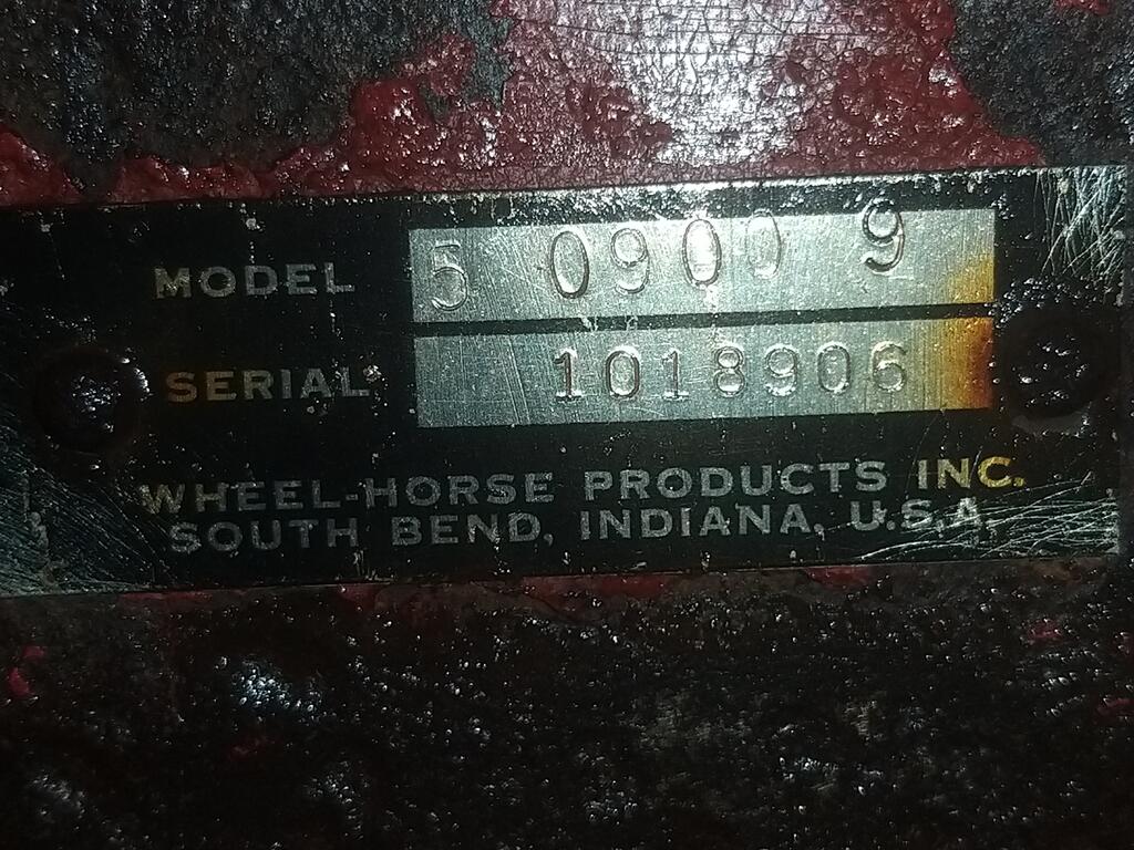

Bertie 314 #1 Posted August 4, 2021 I recently purchased a WH 60" finishing mower which is very rarely available in the UK am I correct in thinking Woods made it originally and the RM59 model is correct when ordering any replacement parts. Its been stood for some time and rust abounds but its still a solid unit... 1 Share this post Link to post Share on other sites

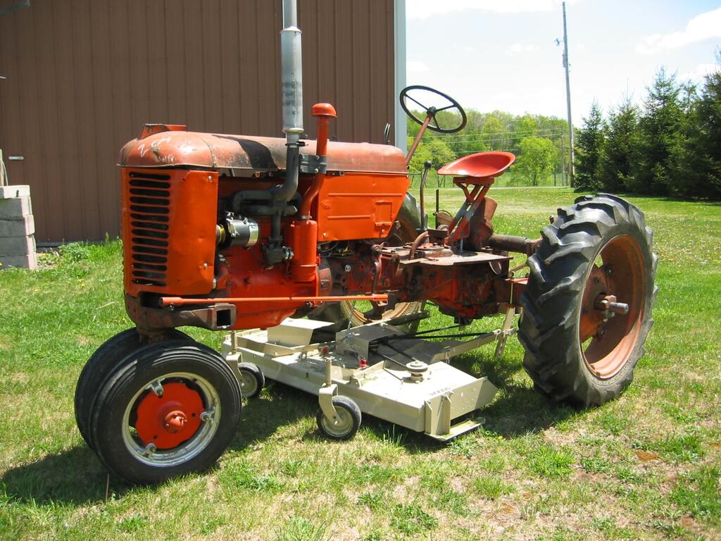

pfrederi 20,870 #3 Posted August 4, 2021 Many of the parts, spindles, bearings etc are rally Woods and hence easier to find. L59 is correct for most all woods parts. I have the WH finish mower but also a belly mount Woods L59 that can be on my Case VAC (picture) I have a hard copy of the Wood L59 manual if you need anything...what is unique to WH is the input pulley and top cover. John Deere also used this mower. 1 1 Share this post Link to post Share on other sites

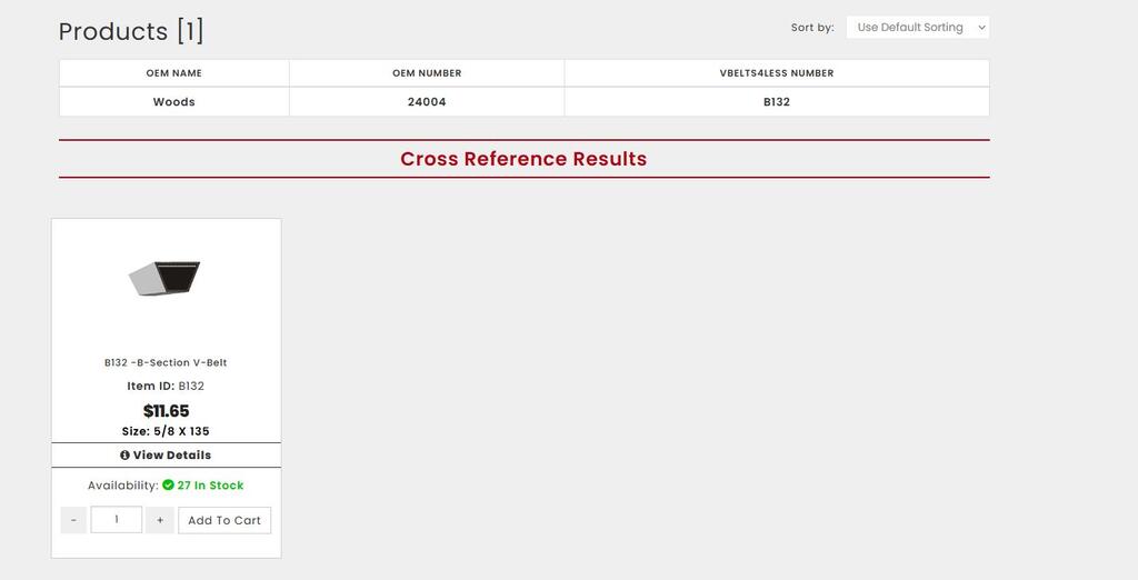

Bertie 314 #4 Posted August 4, 2021 I was looking for a replacement V belt pt number 103236 but at over $200+ they are a crazy price imo. Does anyone have the dimensions of the belt as I'll find something similar over here... Share this post Link to post Share on other sites
pfrederi 20,870 #5 Posted August 5, 2021 I used an Agricultural & Industrial (A&I) Products replacement listed a woods 24004 B section (5/8") 135" Some other cross numbers for parts in this thread 2 Share this post Link to post Share on other sites
