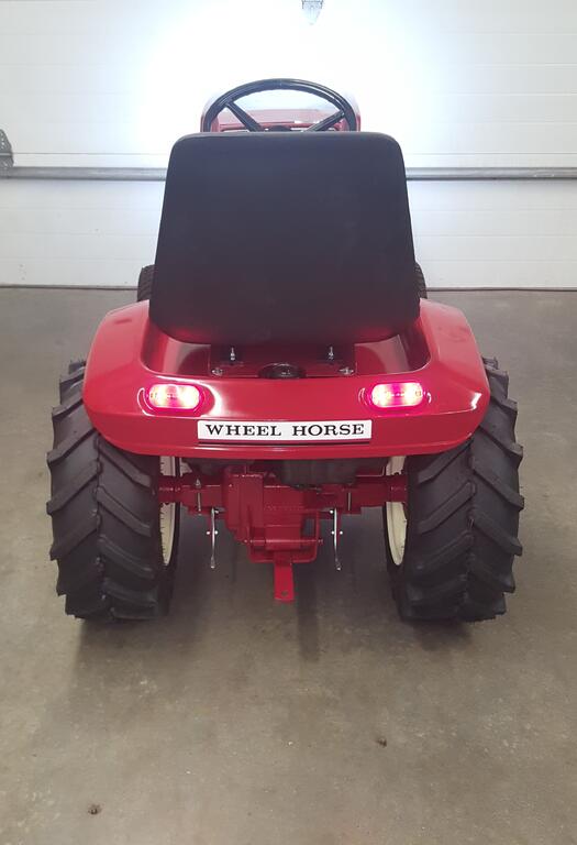

RandyLittrell 3,944 #3 Posted August 5, 2021 Here ya go! 2 1 Share this post Link to post Share on other sites

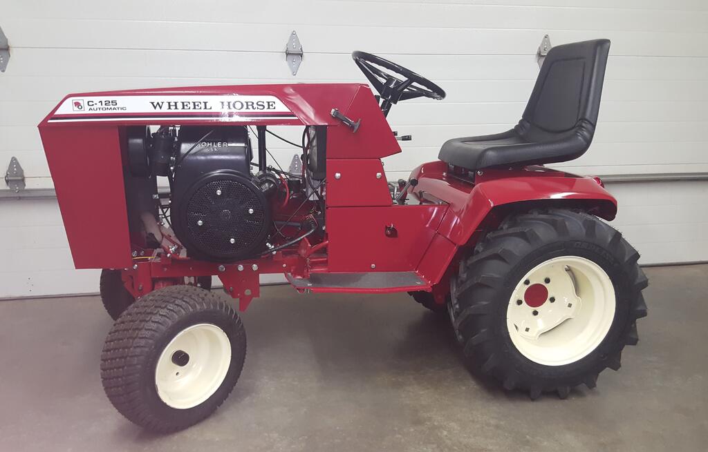

Gregor 4,848 #8 Posted August 8, 2021 These are 23/8.50-12 Carlisle Tru Power Ag tires on stock wheels. This is on a C-125. You don't mention what tractor you are putting them on. 3 1 Share this post Link to post Share on other sites

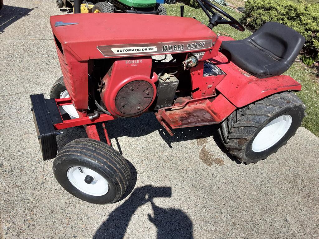

Roger R 473 #13 Posted August 12, 2021 23 - 10.50 are no problem on stock rims. these fit on with no problem 1 1 Share this post Link to post Share on other sites

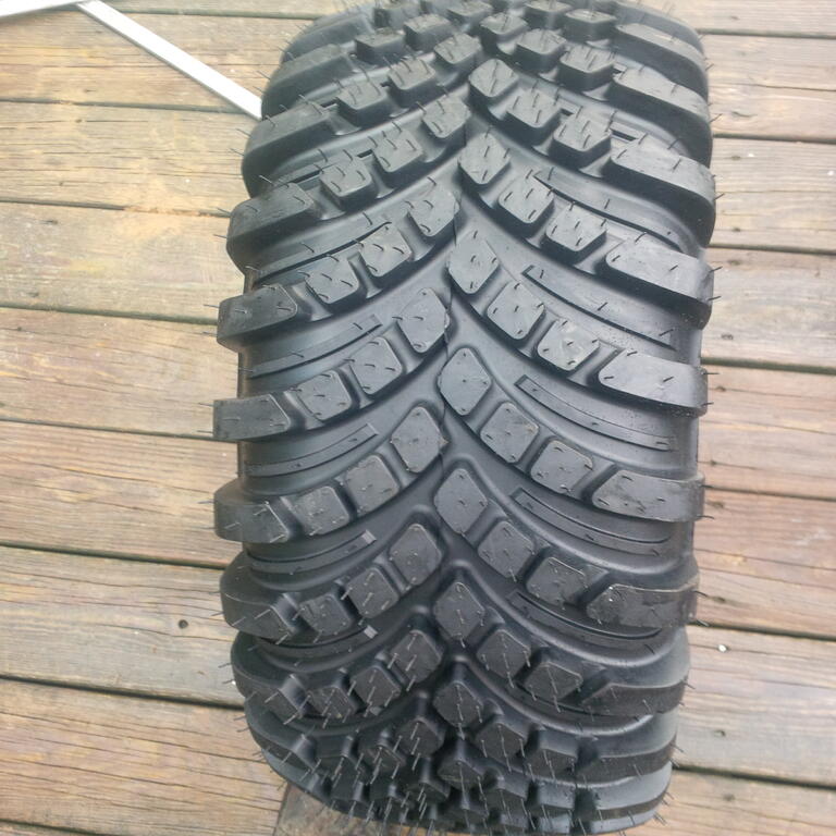

fast88pu 3,393 #14 Posted August 15, 2021 I got these carlise tires. 26x12x12 1 1 Share this post Link to post Share on other sites
Gregor 4,848 #15 Posted August 15, 2021 18 minutes ago, fast88pu said: I got these carlise tires. 26x12x12 On what may I ask? Share this post Link to post Share on other sites
Handy Don 16,944 #16 Posted August 15, 2021 6 hours ago, Gregor said: On what may I ask? These look intriguing. Rim size? 6 hours ago, fast88pu said: I got these carlise tires. 26x12x12 And what are their actual dimensions (diameter once mounted? Thanks! Share this post Link to post Share on other sites
fast88pu 3,393 #17 Posted August 15, 2021 10 hours ago, Gregor said: On what may I ask? 12x7 rims on a 312 Share this post Link to post Share on other sites
fast88pu 3,393 #18 Posted August 15, 2021 4 hours ago, Handy Don said: These look intriguing. Rim size? And what are their actual dimensions (diameter once mounted? Thanks! 12 x 7 rims 25.8" high mouted 1 Share this post Link to post Share on other sites
DoctorHfuhruhurr 137 #19 Posted August 20, 2021 On 8/15/2021 at 7:59 AM, fast88pu said: I got these carlise tires. 26x12x12 Radial? Radials have a larger contact patch and are becoming more popular due to better performance. Share this post Link to post Share on other sites
fast88pu 3,393 #20 Posted August 21, 2021 22 hours ago, DoctorHfuhruhurr said: Radial? Radials have a larger contact patch and are becoming more popular due to better performance. Yes radials, nice flat tread even on a 7" wide rim Share this post Link to post Share on other sites
AMC RULES 37,259 #22 Posted August 21, 2021 On 8/15/2021 at 6:55 PM, fast88pu said: 12x7 rims on a 312 What's the name of those funky Carlisles Kyle? Share this post Link to post Share on other sites
fast88pu 3,393 #23 Posted August 21, 2021 1 hour ago, AMC RULES said: What's the name of those funky Carlisles Kyle? Carlise versa turfs Share this post Link to post Share on other sites
