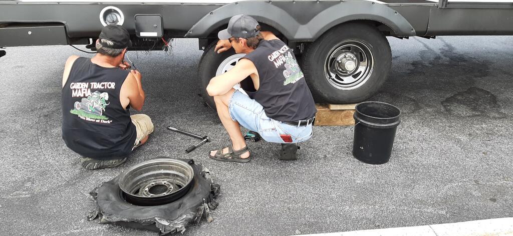

WHX?? 58,070 #36 Posted August 5, 2021 (edited) 46 minutes ago, tom2p said: tighten with a 4 way A 4-way is not a substitute for a torque wrench but is handy is some situations. 46 minutes ago, tom2p said: I would not change a tire on the side of the road / highway ... I would drive on the wheel or spindle Tried that once when I was young and stupid and did not work out well. Now that I am old and stupid best thing to do if you can't make it to a safe spot is to call the and ask them for roadside safety assistance. That's what we pay them for. I do understand your concern tho. I had three blowouts this year and one on a very busy interstate but fortunately close to a service area where tire changes could be carried out safely. Note the torque wrench there... never leave home without it! Edited August 5, 2021 by WHX?? 2 Share this post Link to post Share on other sites

8ntruck 9,289 #39 Posted August 5, 2021 (edited) Man, I think that wheel is one that I developed the stamping dies for! Somebody sure mis-treated it. My 40 year engineering carrer was in the automotive steel wheel industry. Lug nut torque - in general 60 to 80 lb ft is proper for 1/2, 9/16 inch or 12 and 14mm studs. I always used 80 lb ft of lug nut torque. Yes, I've used torque wrenches on my cars. I forgot to add that lubrication of the stud is a no no. Lube in the threads messes up the torque/tension relationship. Lube will raise the tension in the stud to a point that the nut seats in the wheel will deform or high enough that the stud will yield or break. Edited August 5, 2021 by 8ntruck 4 1 Share this post Link to post Share on other sites
