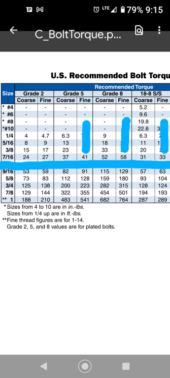

WHX?? 57,388 #2 Posted August 4, 2021 5 minutes ago, Gregor said: I'm thinking that's not enough That is correct, Google up a torque chart and go by what it says when in doubt. Keep in mind The charts are dependent on what the material the fastener is. 1 Share this post Link to post Share on other sites

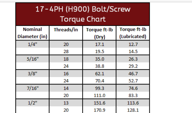

WHX?? 57,388 #6 Posted August 4, 2021 3 minutes ago, WHX?? said: what the material the fastener is. I have no idea what material the chart I posted is for. For stock lug bolts i would just use mild steel in 7/16-20 1 Share this post Link to post Share on other sites
ebinmaine 79,685 #7 Posted August 4, 2021 4 minutes ago, WHX?? said: I have no idea what material the chart I posted is for. For stock lug bolts i would just use mild steel in 7/16-20 Agreed. Grade 2 or 5. 6 minutes ago, Gregor said: Now you understand my confusion. I've been following my method of 35 or 40 foot pounds plus a retorque for several years now and haven't had anything come undone. It's important to keep in mind that we move some very heavy stuff on hilly rough terrain. Share this post Link to post Share on other sites
WHX?? 57,388 #8 Posted August 4, 2021 Just to confuse you more .... not what EB is showing....well kinda. I do torque the 1/2" lugs on the toy hauler @ 110 ft lbs with no problems. Torque-Tension Reference Guide.pdf (fastenal.com) 2 Share this post Link to post Share on other sites

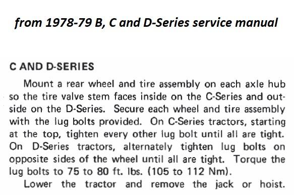

gwest_ca-(File Mod) 12,349 #9 Posted August 4, 2021 Much of the info in this SM still applies to the latest models 3 1 Share this post Link to post Share on other sites

Jeff-C175 7,209 #16 Posted August 4, 2021 1 hour ago, WHX?? said: what material the chart I posted is for 17-4PH (H900) would seem to indicate some type of 'specialty' fastener to me. Gotta be some sort of super high strength material! Share this post Link to post Share on other sites
Achto 32,095 #17 Posted August 4, 2021 1 hour ago, midpack said: I have an air hammer wrench that I use and so far none have ever loosened An impact is fine on steel rims. Use one to install aluminum rims and you chance cracking the rim. Um, been there . Now I use a torque wrench on aluminum rims. Always recheck after the first 100miles. My tractors get torqued to 60ft lbs. 3 Share this post Link to post Share on other sites
oliver2-44 11,628 #18 Posted August 4, 2021 13 minutes ago, Jeff-C175 said: 17-4PH (H900) would seem to indicate some type of 'specialty' fastener to me. Gotta be some sort of super high strength material! So I had to look it up, It says that is a heat treated precipitated stainless steel know for it strength. so not what were using. 2 Share this post Link to post Share on other sites

WHX?? 57,388 #21 Posted August 4, 2021 2 hours ago, Jeff-C175 said: 17-4PH (H900) would seem to indicate some type of 'specialty' fastener 2 hours ago, oliver2-44 said: is a heat treated precipitated stainless steel know for it strength. Lol inquiring minds want to know! I just grabbed the first chart google threw at me just to show Greg what a torque chart was. I suppose you canaries want to resto a horse with them now ..... 2 Share this post Link to post Share on other sites
