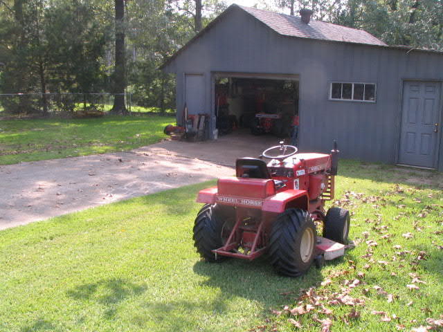

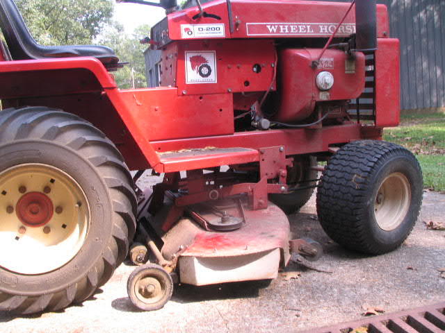

pacer
I put this together in about 10 mins with a piece of ..thinnish? sheet metal off ??? and found it worked surprisingly well (in light duty)
As fall of the year nears the trees star dropping a few leaves and makes my yard look ... messy? I have a Cyclone Rake system for the serious leaf fall later but for 2-3 times I will use this to 'clean' up prior to the big fall of leaves.
