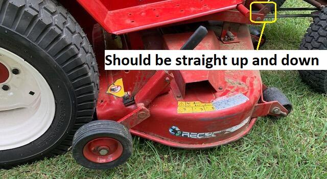

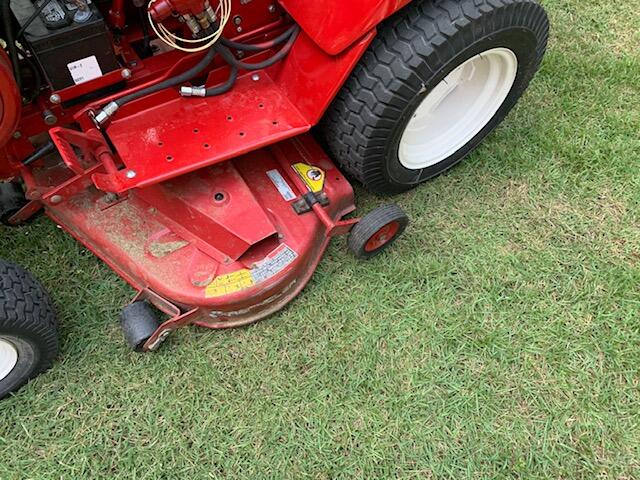

Searcher60 209 #1 Posted August 2, 2021 Hello! I just put a 42” rear discharge deck, 78355 on my Electro. As you can see in the pics, the deck hits the rear wheels….. The frame is 73 Charger attach mattic. Anybody know whatHi the deal is? I have a feeling this ain’t going to be good! Looks like the deck needs to move forward? The attachment point is the same distance from the front of the frame as my 520H. Thanks in advance. Share this post Link to post Share on other sites

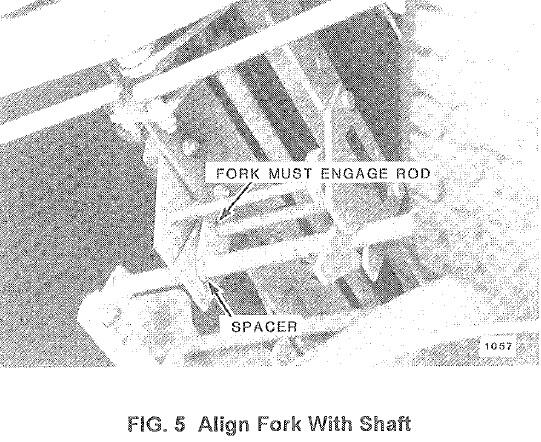

gwest_ca-(File Mod) 12,258 #2 Posted August 2, 2021 Do you have the hitch fork in the correct position? Poor picture from the mower operator manual 2 2 Share this post Link to post Share on other sites
daveoman1966 3,883 #3 Posted August 2, 2021 You don't have the deck mounted right. 5 Share this post Link to post Share on other sites
Searcher60 209 #5 Posted August 3, 2021 Yep, I missed with the fork. Never done that before! Thanks a bunch. . 2 Share this post Link to post Share on other sites
