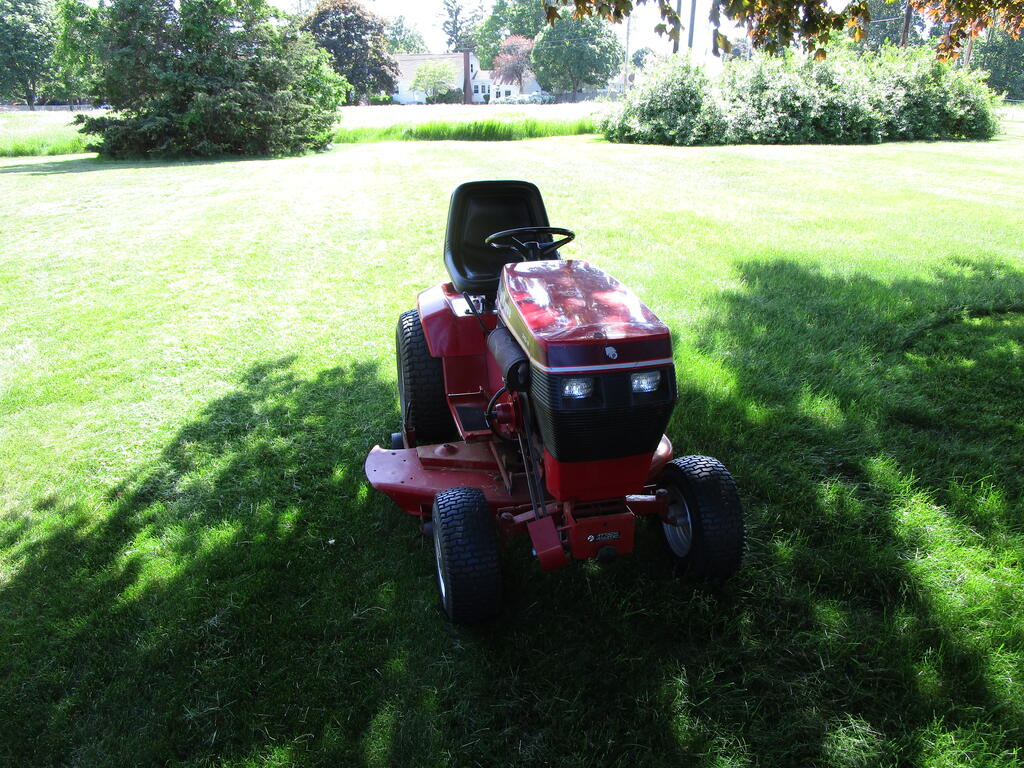

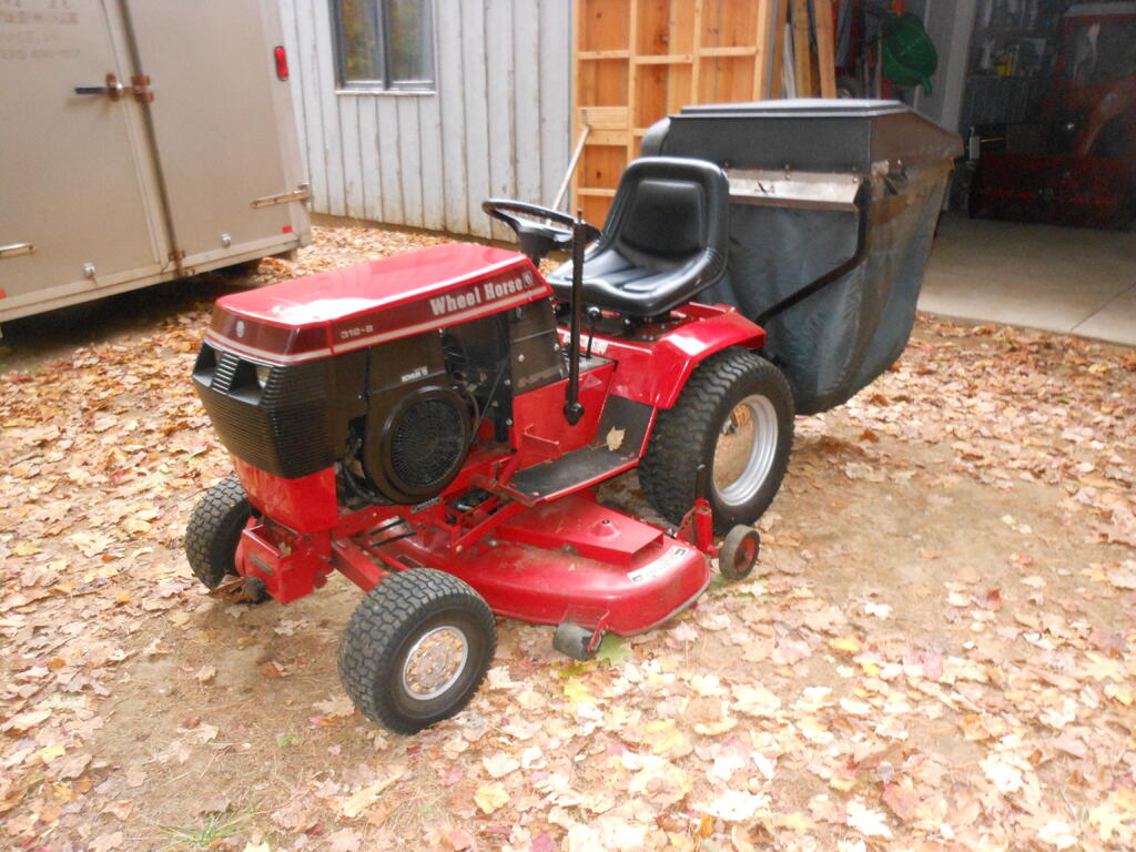

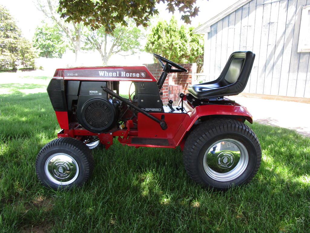

JCM 11,154 #4 Posted July 30, 2021 Great question that I have asked myself for years. Having owned a 312-8 with a 42'' SD deck for 32 years since new and recently refurbed a 310-8 of the same vintage with the same size deck I can honestly say I see no difference in the two for mowing. Yes a twin Kohler would be my choice with your acreage to mow especially if it is tall on a consistent basis. That being said towing a trailer should not matter. I also have a tiller that I picked up 8 years ago but have not yet tried it out but I doubt you would have any issues with an 8 speed transmission. 3 Share this post Link to post Share on other sites
