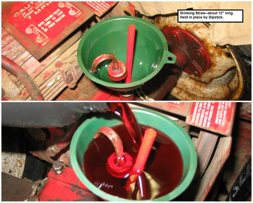

daveoman1966 3,884 #4 Posted July 30, 2021 Use a small funnel with a 12" drinking straw inserted like this to 'vent' air as oil (ATF) is poured in. Works great. 1 Share this post Link to post Share on other sites
