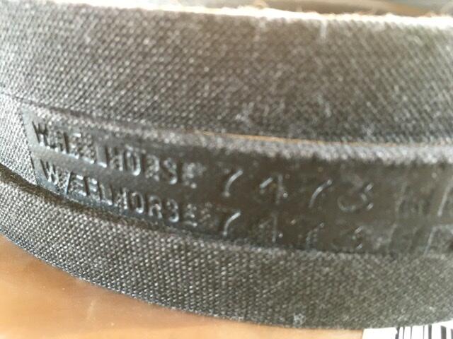

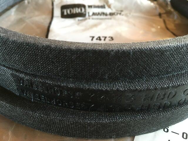

tom2p 2,394 #11 Posted August 3, 2021 (edited) If you can find a 'real' Toro / Wheel Horse OEM belt - they are the way to go molded / wrapped belts - with the name and numbers stamped (not printed) in the belt I don't know who manufactured belts for Wheel Horse - but the materials and quality control were first rate some are black - some are off -white I believe the OEM drive belts with the off-white cover allow for smoother engagement when the clutch is released Edited August 3, 2021 by tom2p Share this post Link to post Share on other sites
