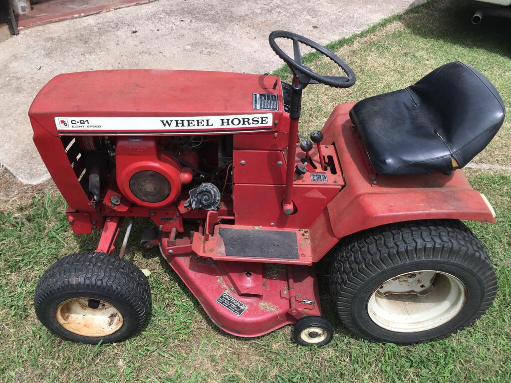

twiisted71 51 #1 Posted July 28, 2021 Ok fellow red riders, I need to put on some new tires for my C81. I'm using it in soft Oklahoma red dirt so I'm going with a set of Deestone 3 rib 4.00-8s to help with turning effort. The issue I'm running into is wheels. My spindles are 3.75" long to the C-clip groove and I can't find any of the 8x3.75" wheels for it. Miller is out of stock with no expected date. Anyone have a source for some of the narrow wheels? They usu run around $30-35/each new with bearings. Picture for attention--who doesn't like to look at'em! Share this post Link to post Share on other sites
