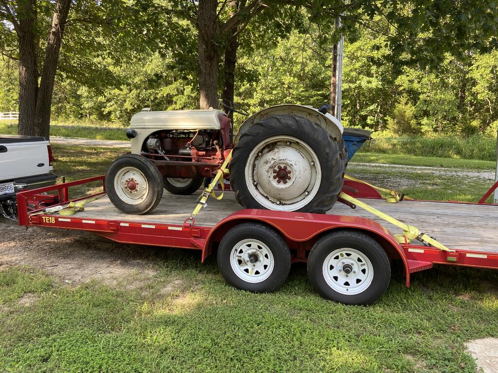

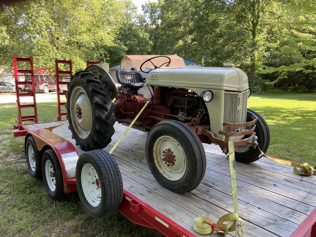

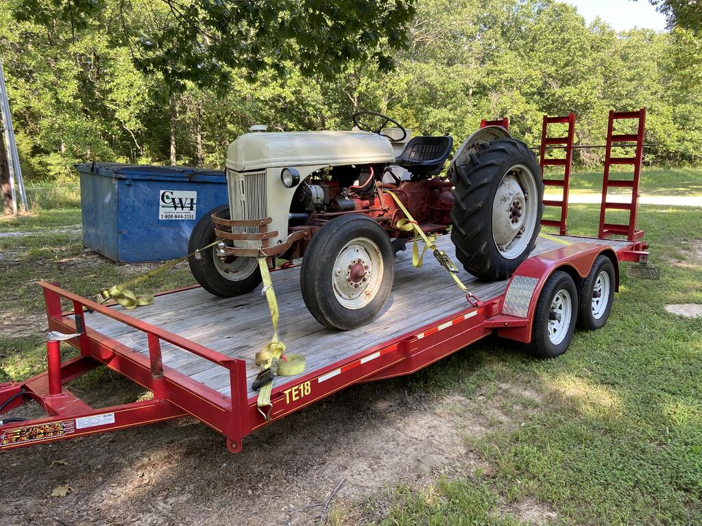

T-Mo-(Moderator) 4,597 #1 Posted July 28, 2021 I picked this up over the last weekend. Drove down to near Metropolis, Illinois (Brookport, to be exact). It sort of a Frankenstein tractor, especially the engine. It appears to be, from certain features, an early 1948. Holes in the grill for the "Ferguson System" badge that were on the 9Ns and 2Ns tractor, and Ford did not remove the holes until later in 1948 (though Ford did not put the badge on the 8Ns at all). Steering knuckle is from an earlier 8N. Oil filler tube is on the forward part of the engine as the earlier 8Ns had front mount distributors and the generator on the right. In 1950, Ford changed the engine to mount a side distributor on the right side, moved the generator to the left side, and move the oil filler tube back and down on the left side to allow for the mounting of the generator. The engine on this 8N seems to have been modified with a side distributor, which means the timing cover and cam had to be changed out. Since the block is from an earlier 8N which had the oil filler tube on the forward left side of the block, they just smashed the filler tube against the block, which means the cap is almost touching the underside of the fuel tank. I can get the cap off and I believe I can add oil with a flexible hose. The filler tube is smashed to allow the alternator to be mounted on the left side (yes, this has been converted to 12V). The hood was painted to cover rust spots that if you get closer to the tractor, the rust spots are clearly visible. In addition to the images, I'm attaching a short video of it running that the previous owner made. 9 3 Share this post Link to post Share on other sites

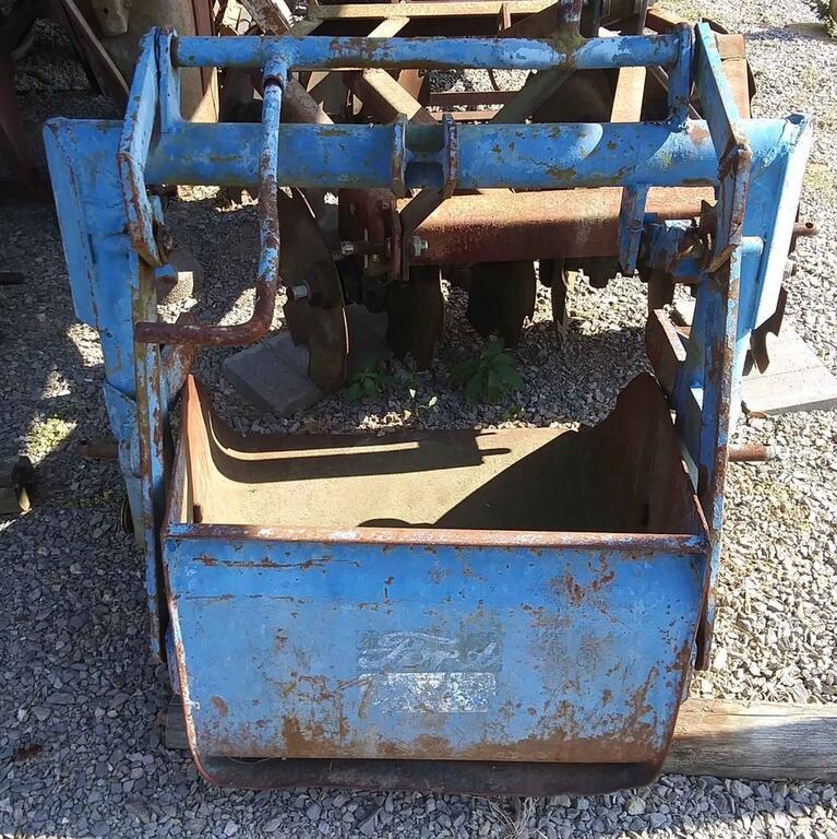

T-Mo-(Moderator) 4,597 #3 Posted July 28, 2021 I have some 3 point attachments that I picked up for my 2N, so both the 2N and 8N will see duty with those attachments. I want to add more attachments as time goes by. Right now, I have a back blade, a rear reversible scoop, a two bottom moldboard plow, and a boom pole. I have plans to add a brush hog, a 3 point carrier or maybe a 3 point fork lift. 5 Share this post Link to post Share on other sites
OutdoorEnvy 1,764 #4 Posted July 28, 2021 Very cool. If I ever get the space an old bigger tractor of some kind is on my wish list. This looks really good though. In spite of the rushed repairs and modifications. Share this post Link to post Share on other sites

ebinmaine 72,075 #6 Posted July 29, 2021 12 hours ago, T-Mo said: a back blade, a rear reversible scoop What's the difference between these two things? Good find on the 8N. Share this post Link to post Share on other sites

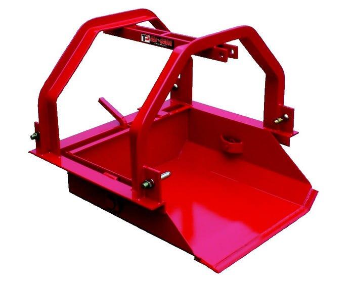

RandyLittrell 3,894 #7 Posted July 29, 2021 2 hours ago, ebinmaine said: What's the difference between these two things? Good find on the 8N. Scoop is like this, and you can pick up dirt or clean out things. Blade is just a rear 3 point blade. This is a new pic and I'm sure Terry has an older style. Randy 1 Share this post Link to post Share on other sites

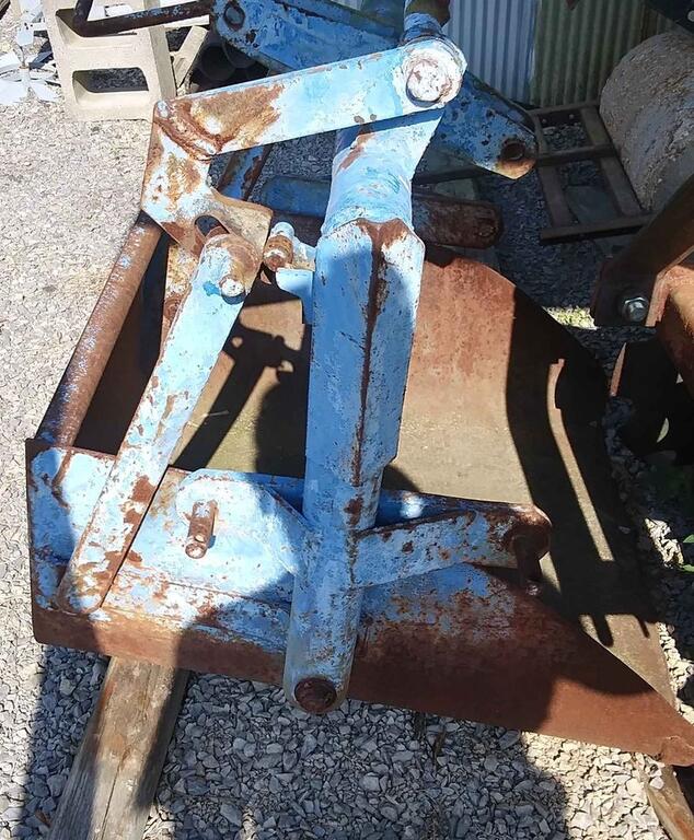

T-Mo-(Moderator) 4,597 #9 Posted July 29, 2021 The rear scoop I have is a Ford 19-142 scoop. I picked it up a few weeks back. In the Series 706 parts book attached to this post, it covers the 19-142 scoop that I have. Ford Reversible Scoop - Series 706 - Master Parts Book.pdf 3 Share this post Link to post Share on other sites
T-Mo-(Moderator) 4,597 #10 Posted July 29, 2021 And, I have deciphered the serial number on the engine block enough to know it’s a late 2N engine block. And with certain features the tractor itself is late ‘47 or early ‘48. Definitely not a ‘50 to ‘52. Someone has changed out the timing cover, distributor, and cam to add the side distributor. I would rather it was left alone as a front mount so the alternator could have been mounted on the right side and the oil filler tube would have been left alone and not smashed against the block to allow the alternator to be mounted on the left side. 1 Share this post Link to post Share on other sites
Zeek 2,286 #11 Posted July 29, 2021 Nice I love those and the Gold Jubilees. @T-MoWhat trailer brand is that and what is the GVWR? I'm going to get one at some point and yours is pretty nice. I like that it has the three ramps for smaller stuff. Share this post Link to post Share on other sites
T-Mo-(Moderator) 4,597 #12 Posted July 29, 2021 The trailer I ordered and picked up off the lot from Trailer Express in Sikeston, Missouri. It's a TE18, 83 inches wide by 18 foot long. Special things I had put on it when I ordered it, a third ramp for loading narrow front tractors, surge brakes so I can use any truck to tow with it, spare tire and spare tire mount, D-rings....and the rest was standard. It's a 7500 lb GVWR trailer. I had thought about ordering a 10,000 lb one, but I really didn't want to be towing that much, though my '99 F250 is certainly capable of handling it, but my '04 Dodge Ram with the 5 speed, not so much. With the third ramp, I'm able to haul garden tractors, lawn tractors and zero turns (I have done it several times) and with the 18 foot length, I can get two good size garden tractors on it. I would have love a Jubilee or any NAA, but those are harder to find in a decent price range that don't require a lot of work. What would have been really nice is a Power Master 900 series Ford. Share this post Link to post Share on other sites

RandyLittrell 3,894 #14 Posted July 30, 2021 On 7/29/2021 at 7:33 AM, T-Mo said: The trailer I ordered and picked up off the lot from Trailer Express in Sikeston, Missouri. It's a TE18, 83 inches wide by 18 foot long. Special things I had put on it when I ordered it, a third ramp for loading narrow front tractors, surge brakes so I can use any truck to tow with it, spare tire and spare tire mount, D-rings....and the rest was standard. It's a 7500 lb GVWR trailer. I had thought about ordering a 10,000 lb one, but I really didn't want to be towing that much, though my '99 F250 is certainly capable of handling it, but my '04 Dodge Ram with the 5 speed, not so much. With the third ramp, I'm able to haul garden tractors, lawn tractors and zero turns (I have done it several times) and with the 18 foot length, I can get two good size garden tractors on it. I would have love a Jubilee or any NAA, but those are harder to find in a decent price range that don't require a lot of work. What would have been really nice is a Power Master 900 series Ford. My 18 footer has pretty much the same specs and I bought it in 1992, best money I ever spent!! I can still get more money out of it now than what I paid for it. It looks really nice Terry! Randy Share this post Link to post Share on other sites

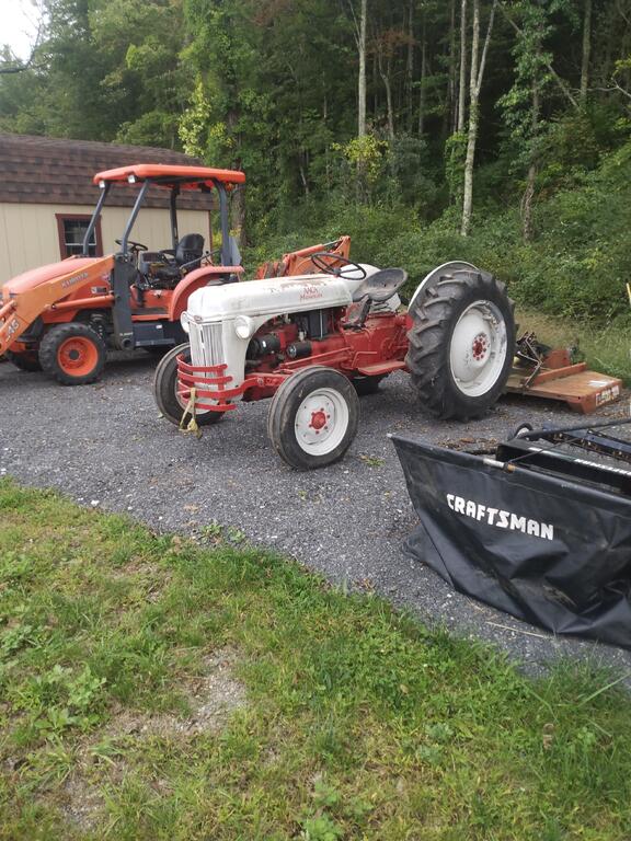

Shed 249 #15 Posted September 21, 2021 Just picked this up myself side mount it was in the aaca museum friend bought from them and I got it from him so it's a nice little tractor doesn't run had 3 point problems all the normal 8n stuff Share this post Link to post Share on other sites
T-Mo-(Moderator) 4,597 #16 Posted October 30, 2021 Update on this 8N. It's sort of a Frankenstein tractor. From certain features, it's a 1947 8N, which the 8N came out in late 1947. By 1948, Ford had made some minor changes that this one does not have, so it's a 1947. What gets confusing is, everyone thinks it's a mid-50 to 52 due to the side distributor. Up to then, the 8N had a front mount distributor. To further muddied the waters, the serial number on the engine block, makes the engine a 2N engine, which also should have a front mount distributor. Somewhere in it's life the front mount distributor has been replaced with a side distributor. To get that to happen, someone had to change out the cam gear and timing cover, and make brackets to move the generator ( in this case, an alternator) to the left side. To get the alternator on the left side, they had to push the oil filler tube against the engine block. A true side distributor 8N engine will have the oil filler tube mover back to make room for the generator or alternator. It will also have an access cover on the right rear of the engine to see timing marks. A front mount engine does not have that since there is only one way to put in a front mount distributor. This engine does not have that access to the flywheel timing marks. When I got this 8N, it ran, but ran poorly due to being out of time. The previous owner put in a new distributor, points, distributor cap and coil ( which is also mounted behind the dash since there is no place to mount it where it should be, this being a 2N engine). After fiddling around with it and putting in new spark plugs, it now runs a lot better. I bought a new radiator as this one is shot, ordered a new thermostat, and the tractor will get a new coat of gray and red paint when it's finished. For now, a temporarily gas tank it's on it, to run it and drive it around a bit. 1 1 Share this post Link to post Share on other sites
