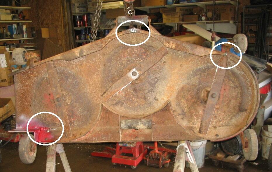

Creapy8x 7 #1 Posted July 27, 2021 So I am going to be picking up a 520h and a c160 here soon an have been looking for a 60” to go under them as I’ve got 3 acres of grass to cut! One gentleman messaged me an said he has one but said it measures about 56”! I am still pretty new to whee horses so I was wondering if anyone knows how to figure out how big a deck actually is if it doesn’t have stickers? From the pictures I’ve found on google the 60s seems to have more squared off edges! Please help Share this post Link to post Share on other sites
WHX?? 58,304 #2 Posted July 27, 2021 (edited) First thing I do is check the blades. You'll want to check the condition of them anyway and while your there you can check the spindles for tightness. They should be all the same length with a few rare exceptions. A 48 should have 3 16's a 60 should have 3 20's etc. If it's a 60 you'll know by the weight. they are beasts and one guy cannot pick one up alone. Here is a decent one for sale with some pics. 1990 520-8 For Sale - Wheel Horse for Sale - RedSquare Wheel Horse Forum Edited July 27, 2021 by WHX24 Share this post Link to post Share on other sites
Ed Kennell 47,600 #3 Posted July 27, 2021 1 hour ago, Creapy8x said: That's a 48" deck. 1 hour ago, Creapy8x said: To run a 60" deck you will need a 1990 or newer 520. They have the forward swept front axle to clear the deck. You also need the special spring loaded mule drive. The 1988 and 1989 520s do not heve the swept axle. The 48" deck shown will run on any 520 or C-160. 1 1 Share this post Link to post Share on other sites
JAinVA 4,638 #4 Posted July 27, 2021 The deck pictured is a 48" and not 60" deck. 1 Share this post Link to post Share on other sites
Creapy8x 7 #5 Posted July 27, 2021 30 minutes ago, Ed Kennell said: That's a 48" deck. To run a 60" deck you will need a 1990 or newer 520. They have the forward swept front axle to clear the deck. You also need the special spring loaded mule drive. The 1988 and 1989 520s do not heve the swept axle. The 48" deck shown will run on any 520 or C-160. How hard would it be to convert the front axle in order to run the bigger deck? Share this post Link to post Share on other sites

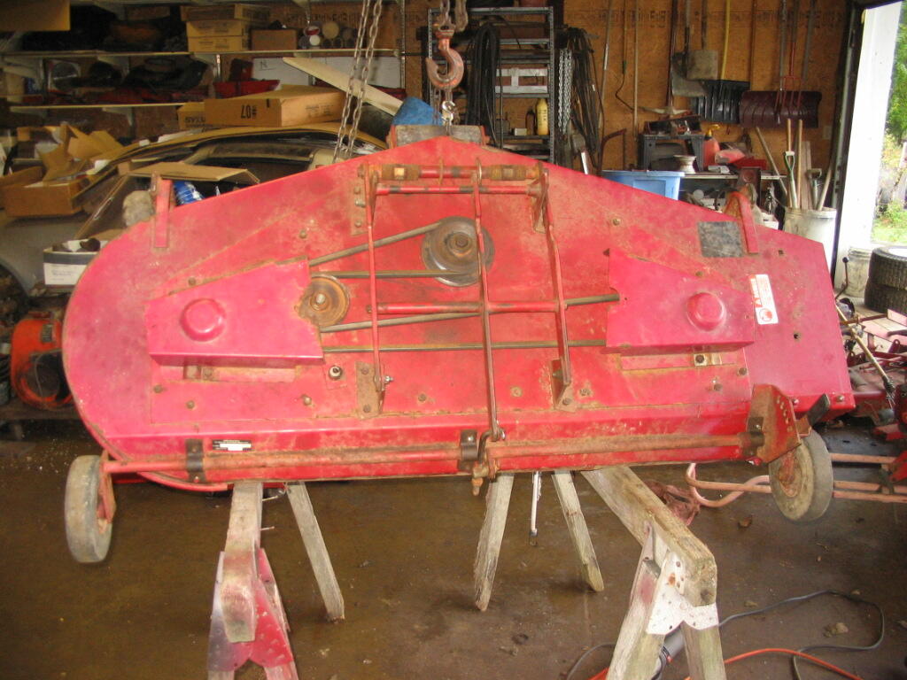

daveoman1966 3,884 #7 Posted July 27, 2021 This is what a 60" deck looks like: It is a heavy brute...350lb or so. Share this post Link to post Share on other sites
