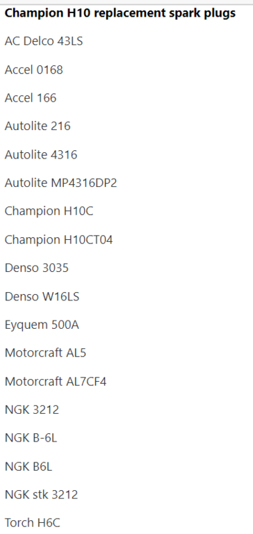

WHX?? 56,843 #11 Posted July 27, 2021 Here we go....not sure if this is right? Note how they cover their rears..... Spark plug cross reference (sparkplug-crossreference.com) 1 1 Share this post Link to post Share on other sites

clueless 3,403 #14 Posted July 27, 2021 1 hour ago, WHX24 said: Here we go....not sure if this is right? Note how they cover their rears..... Spark plug cross reference (sparkplug-crossreference.com) We will be waiting on tenterhooks till you let us know which one you go with . 2 Share this post Link to post Share on other sites

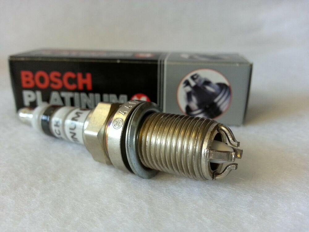

Crazyredhorse 296 #15 Posted July 27, 2021 Run these in harley good crack with throttle.they have iridium's good plug too.pricey though 2 Share this post Link to post Share on other sites
953 nut 66,545 #16 Posted July 27, 2021 11 hours ago, WHX24 said: ...not sure if this is right? Note how they cover their rears... The strange part is if you go to the application chart for each manufacturer of spark plugs for this same engine they seldom mtch the conversion charts. 1 Share this post Link to post Share on other sites
WHX?? 56,843 #17 Posted July 28, 2021 I agree Richard ... you thumb thru those books in the spark plug aisle it's like looking for a needle in a haystack and if you do luck out and find the correct one is it correct? We could go nuts here taking about heat ranges and electrode styles but most if not all of my big blocks have an H-10 and the smalls a CJ-8 with no issues. Heck a couple I even think I am running those cheapys they throw in with a gasket set. Those are good plugs Crazy... had some in a dual plugged shovel head once. Thing rocked but the other motor mods helped! 2 Share this post Link to post Share on other sites
