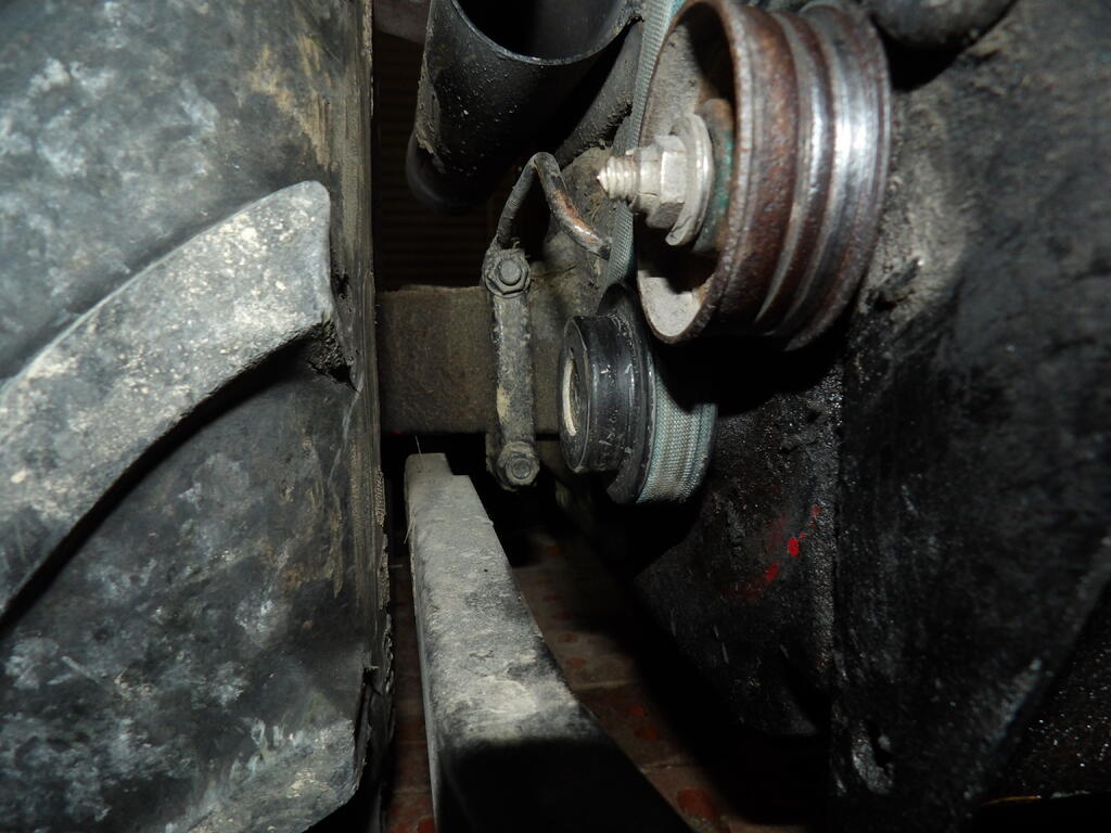

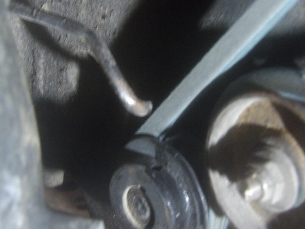

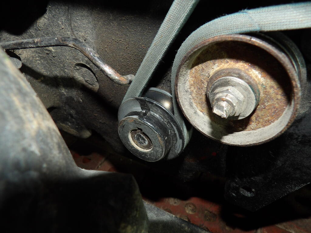

Snoopy11 5,731 #51 Posted August 26, 2021 23 minutes ago, WheelHorse520H said: I’d love to see some photos, I still need to get/make one. I used a 2-1/2 exhaust clamp, (napa or somewhere like that) to put around the axle. And welded a super strong, but pliable piece of steel rod, which I heated and bent. It is not touching the belt until I press the clutch, then the belt touches the rod, and stops immediately. I also did this on different pulleys to see if anything changes, same results with a 7,2,5, or 8 inch pulley. Works awesome. Don Share this post Link to post Share on other sites

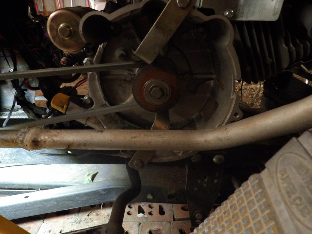

Snoopy11 5,731 #52 Posted August 26, 2021 27 minutes ago, WheelHorse520H said: I’d love to see some photos, I still need to get/make one. Sorry the tractor is so dirty by the way... been meaning to clean it up... just been so hot. Second picture is of my engine setup, third just for the heck of showing you guys my new decals... goes with my nickname, snoopy... and he is blowing a raspberry... how ironic... Don Share this post Link to post Share on other sites

WheelHorse520H 710 #54 Posted August 27, 2021 (edited) Love the design Don, simple and gets the job done. Only problem is I don’t have a welder. I’ll figure it out. I never thought of putting some pegs at the tranny, I just have some on the engine block that one of the POs put there. 7 hours ago, Snoopy11 said: And yes guys, I have my dozer blade back on for fall, leaves are starting... ugh... Don I agree, summer was too short this year. Comedian Jim Gaffigan did a whole thing about fall and the leaves. Sorry, I know this is off topic but he made some very interesting points about what we do. Video Edited August 27, 2021 by WheelHorse520H 1 Share this post Link to post Share on other sites
