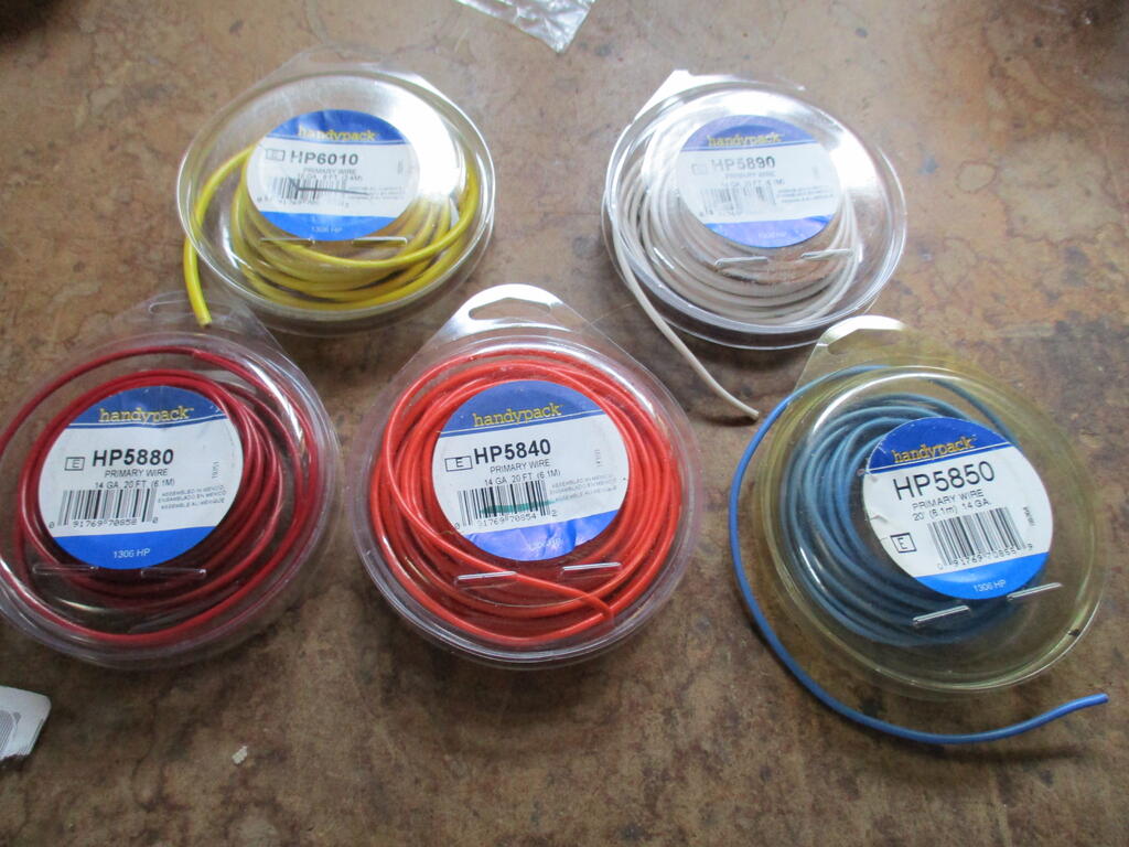

pfrederi 21,176 #11 Posted July 24, 2021 My local auto parts store has a rotating rack of wire 10-18 ga many colors...including Orange 2 1 Share this post Link to post Share on other sites
