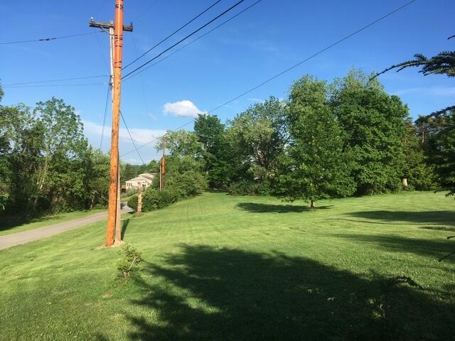

tom2p 2,391 #29 Posted July 26, 2021 19 hours ago, sgtsampay said: Thank you everyone for the responses. I enjoyed them all and learned things. mad far as the k341. Ot having an oil pump, I knew that but my slop is very low except for the end of the lawn which is about a 15ft long much steeper incline. I go up and down and or even across it without having to balance the tractor. So it can’t be that steep. You guys know what I’m talking about. A part so steep that I would have to sit on the fender just to balance the tractor. K341 or similar Kohler should be fine as long as slope is not too steep and/or tractor is not run continuously too long on a slope good portion of our property is a slope - cut it for years with a 312-8 (Kohler Magnum 12) ... still do on occasion ... (pictured below) crankcase holds 2.5 qts so this may figure into the ability to run on mild slopes 312-8 has 800+ hours and runs well ... uses very little oil ... (almost none) Share this post Link to post Share on other sites
