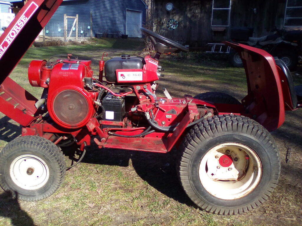

Darb1964
I recently acquired a c_161 A haven't looked up the year, it has the tool box under the seat. Just a great looking tractor, everything is easily accessible. The single sixteen is a power house

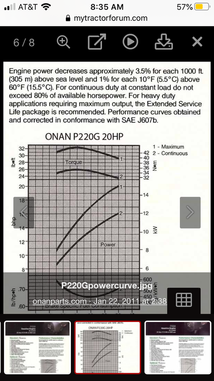

tom2p
2 hours ago, Lee1977 said:
Torque on a P220G is 31.4 ft. lbs.
I grabbed 32/33 from this doc
