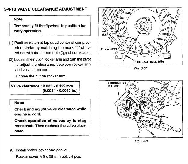

gwest_ca-(File Mod) 12,273 #2 Posted July 21, 2021 Page 38 of the service manual Share this post Link to post Share on other sites

Larrygrandmarquis 0 #4 Posted July 22, 2021 ok but I could not find fellers that went as low as 0.085mm just what I said in the vid. and it still backfired threw the muffler not carb so what is the problem? Share this post Link to post Share on other sites
