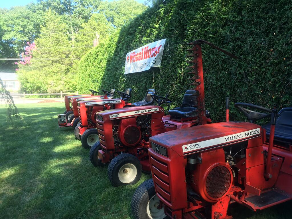

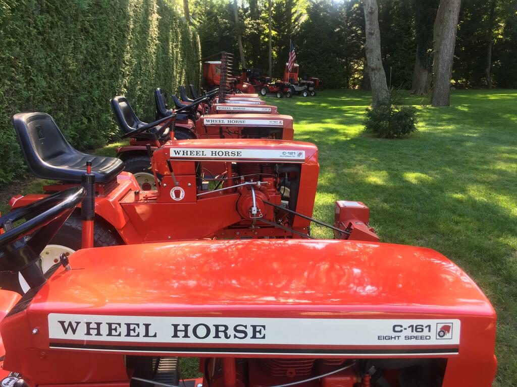

c-series don 9,887 #11 Posted July 22, 2021 The 78-79 C-series are some of my favorite, here’s a few of mine. 1 2 1 Share this post Link to post Share on other sites
oliver2-44 10,630 #12 Posted July 23, 2021 @c-series don you look a little lite on the C-Series models 5 Share this post Link to post Share on other sites
Wheelhorse#1 1,817 #13 Posted July 28, 2021 On 7/22/2021 at 7:58 PM, c-series don said: The 78-79 C-series are some of my favorite, here’s a few of mine. Nice collection you have there ! 1 Share this post Link to post Share on other sites
