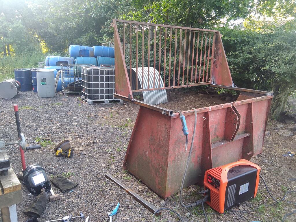

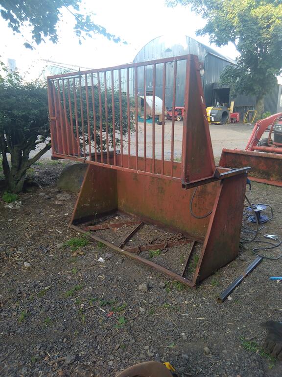

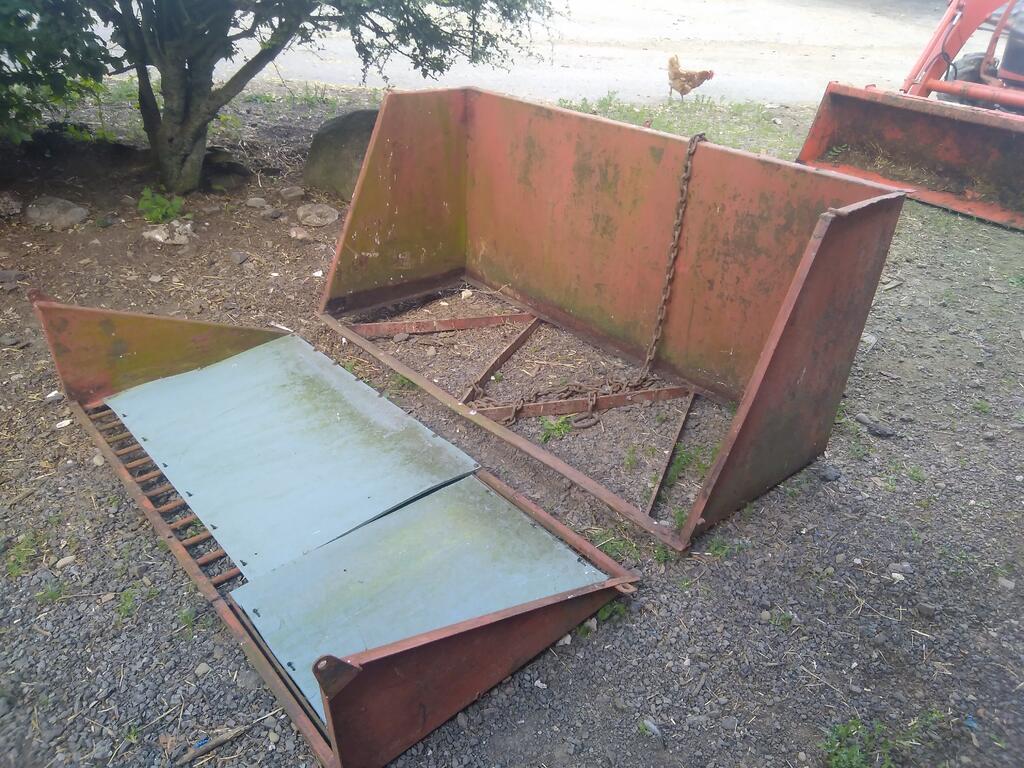

Dan.gerous 2,696 #1 Posted July 20, 2021 You may recall last year that I wanted to build a soil trommel powered by the wheelhorse, that's currently on the back burner due to time constraints. We have a lot of muddy tracks in the winter and our fields are full of stones - so a method for extracting them is still needed - albiet on a more industrial scale than the trommel for our vegetable garden. So here goes.... Found some suitable scrap laying about and am about to start welding it together to form a basic grizzly that we can load with the Kubota - hopefully this will be up and running in days rather than months as time is of the essence! Will post progress here 🙂 4 Share this post Link to post Share on other sites

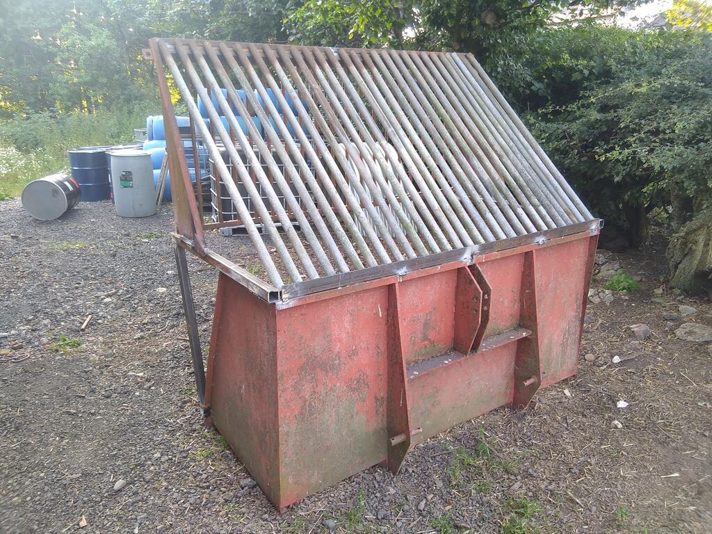

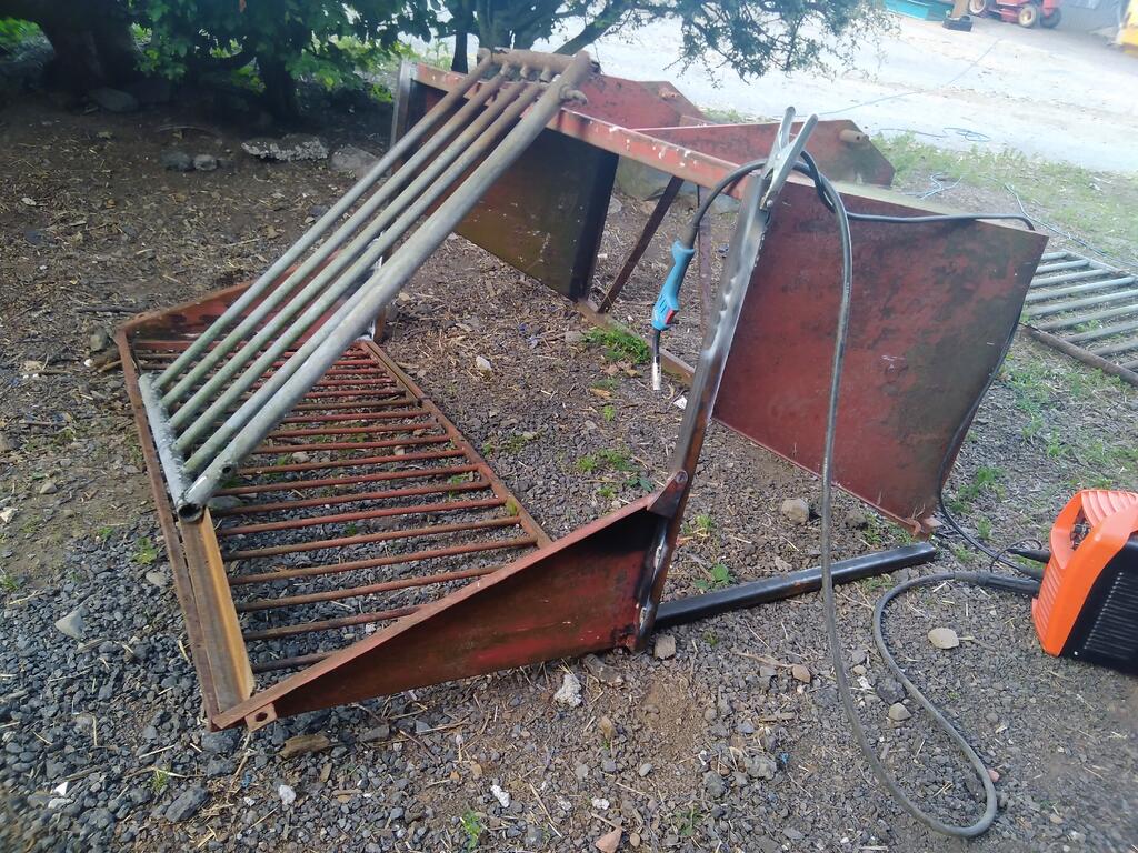

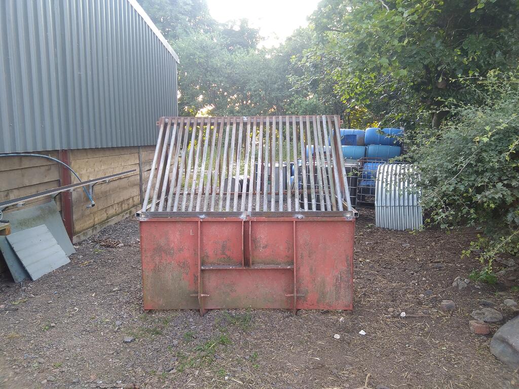

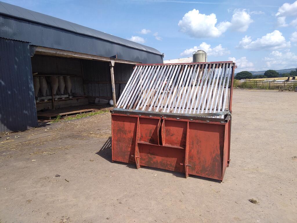

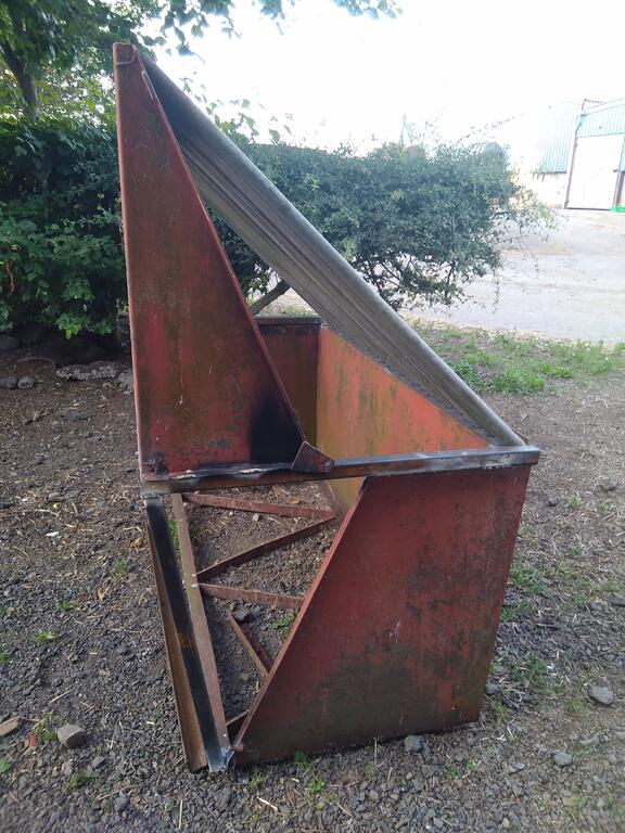

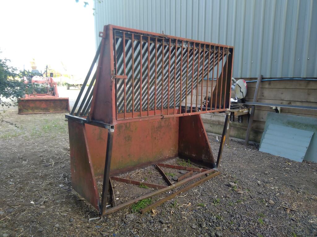

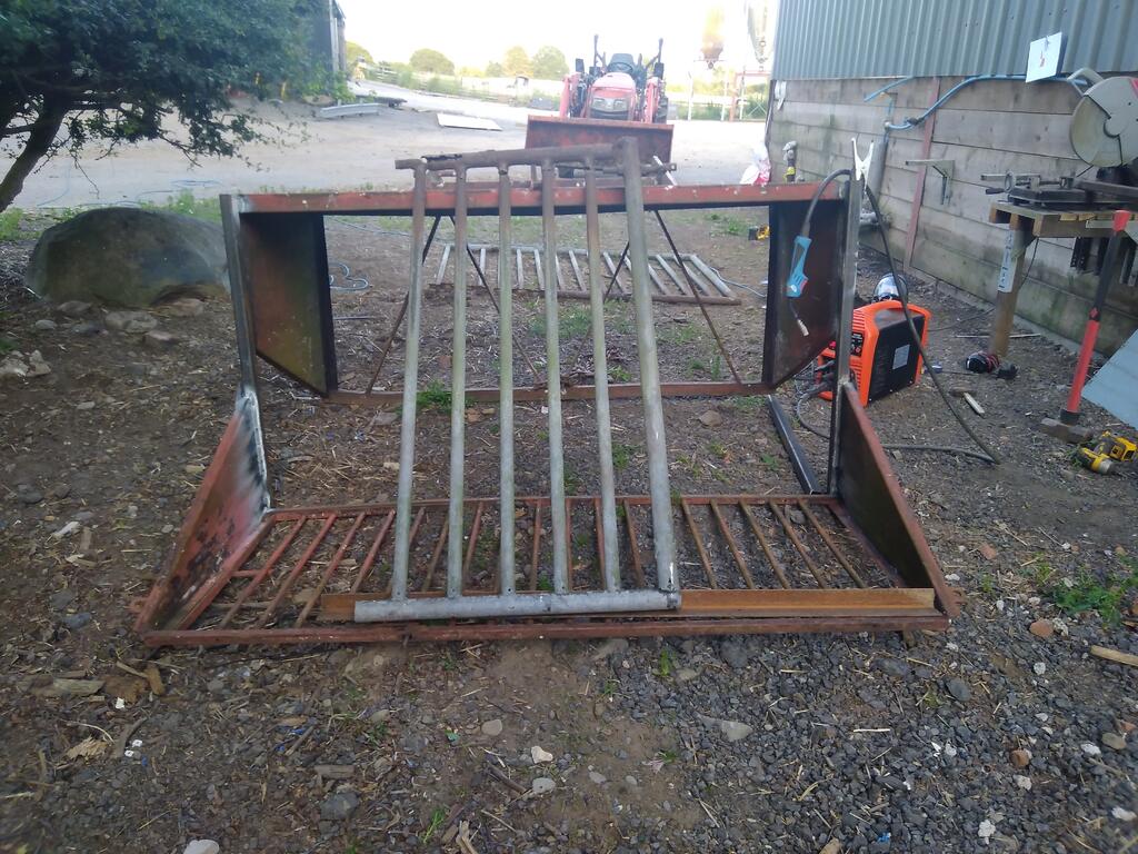

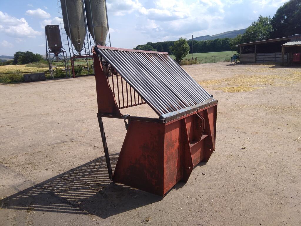

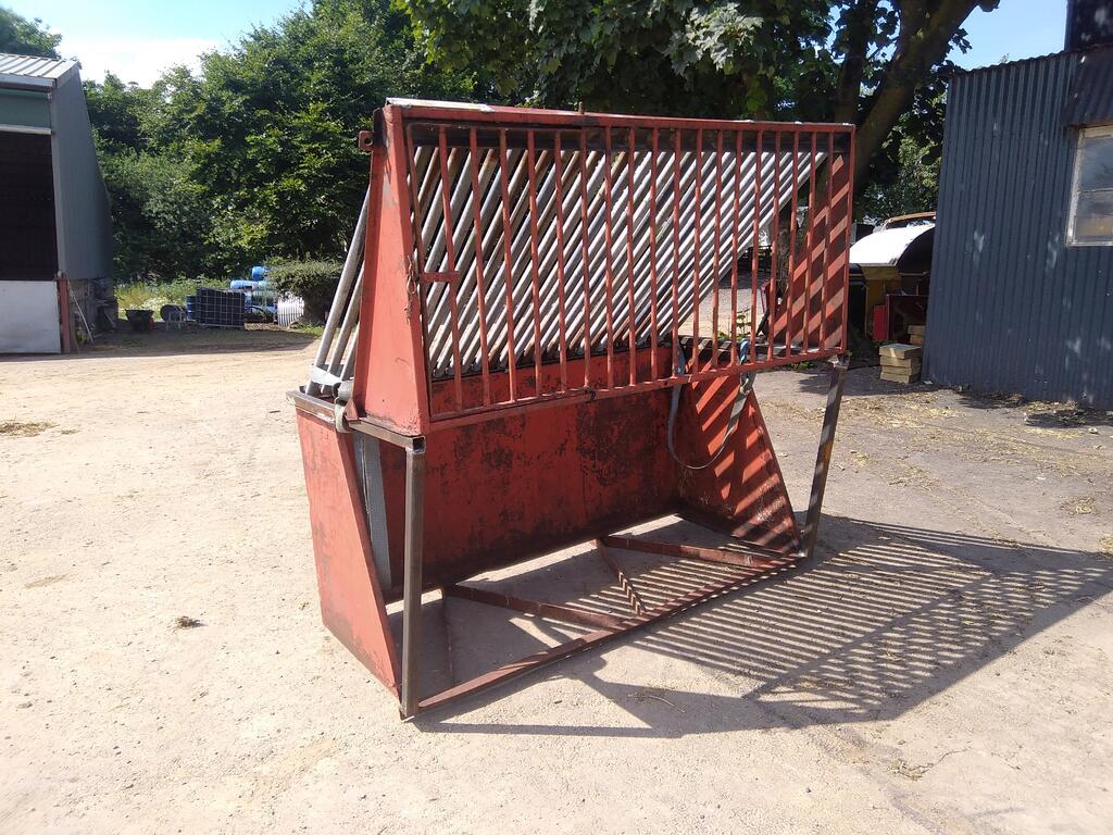

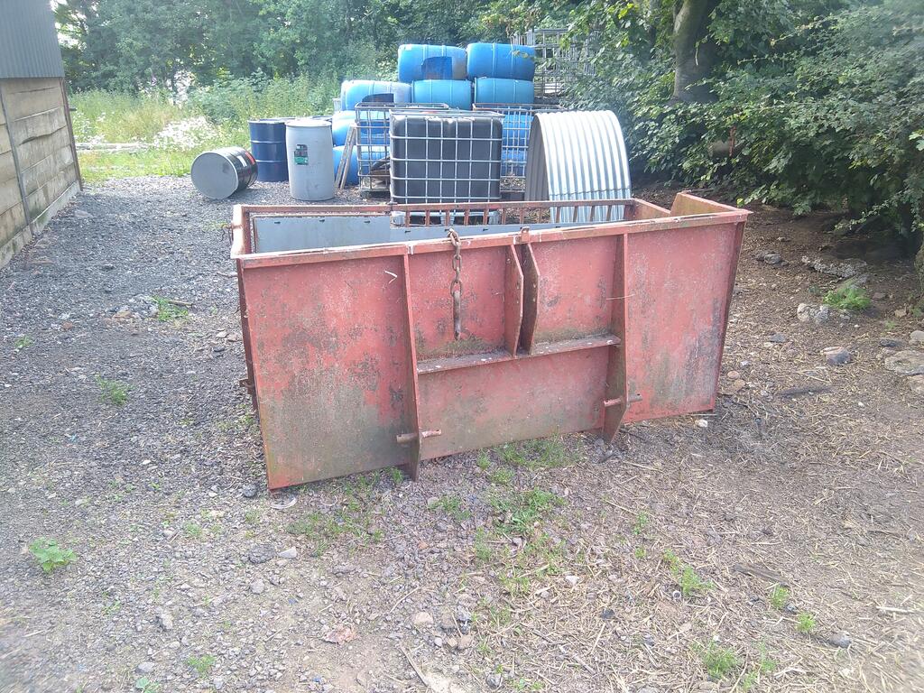

Dan.gerous 2,696 #2 Posted July 21, 2021 Rapid progress, have welded both halves of the structure together - it probably makes no sense from the photographs though! Ignore the vertical bars, I just didn't see the point in removing them as the tractor bucket should be fine working underneath them. We have half a dozen galvanised gates from inside the sheds that are rotten - these are going to turn the actual grizzly Bars. In the last pictures it's tipped on it's back so I can lay them in place. Will smarten it all up with some steel plate, paint and logos - hate things looking like rubbish. In the background is Pig Arc under repair - the bottom of the front and back rots out so I replace the lower steel work with new. The black and yellow drum is another project to make big drinkers for the outdoor pigs .... So much to do so little time! As if that isn't enough the wheelhorse in the earlier pictures appears to have a fuel pump failure - it was running beautifully up until that point! 3 Share this post Link to post Share on other sites

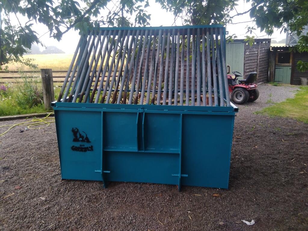

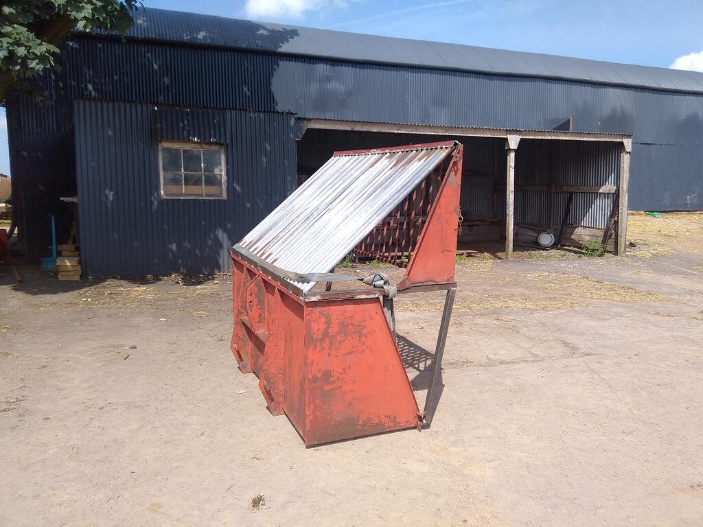

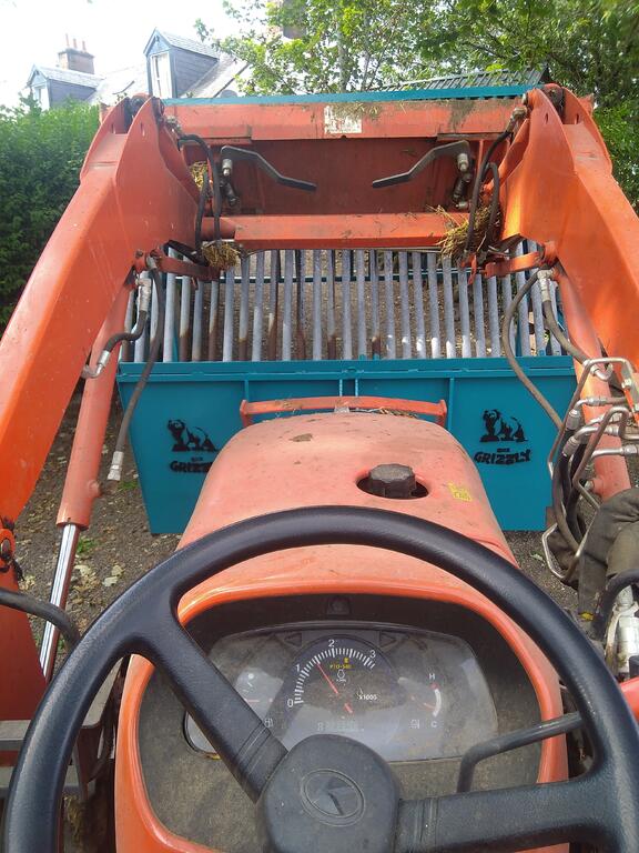

Dan.gerous 2,696 #7 Posted July 21, 2021 Flying along! Basic grizzly is now complete, just a few hours welding to make it solid, then see how it works. Then repair all the cracked welds... Have left the three point linkage points on it, might be handy for moving about the place - although will probably just use chains and the FEL. 1 Share this post Link to post Share on other sites

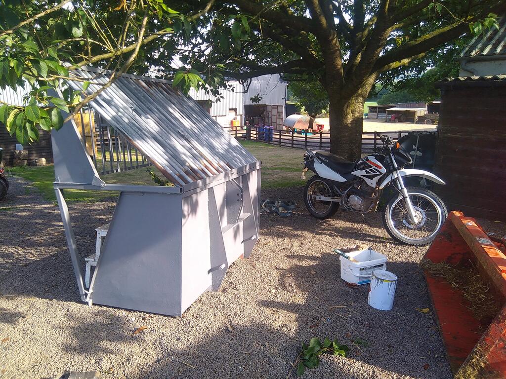

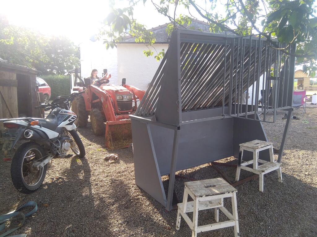

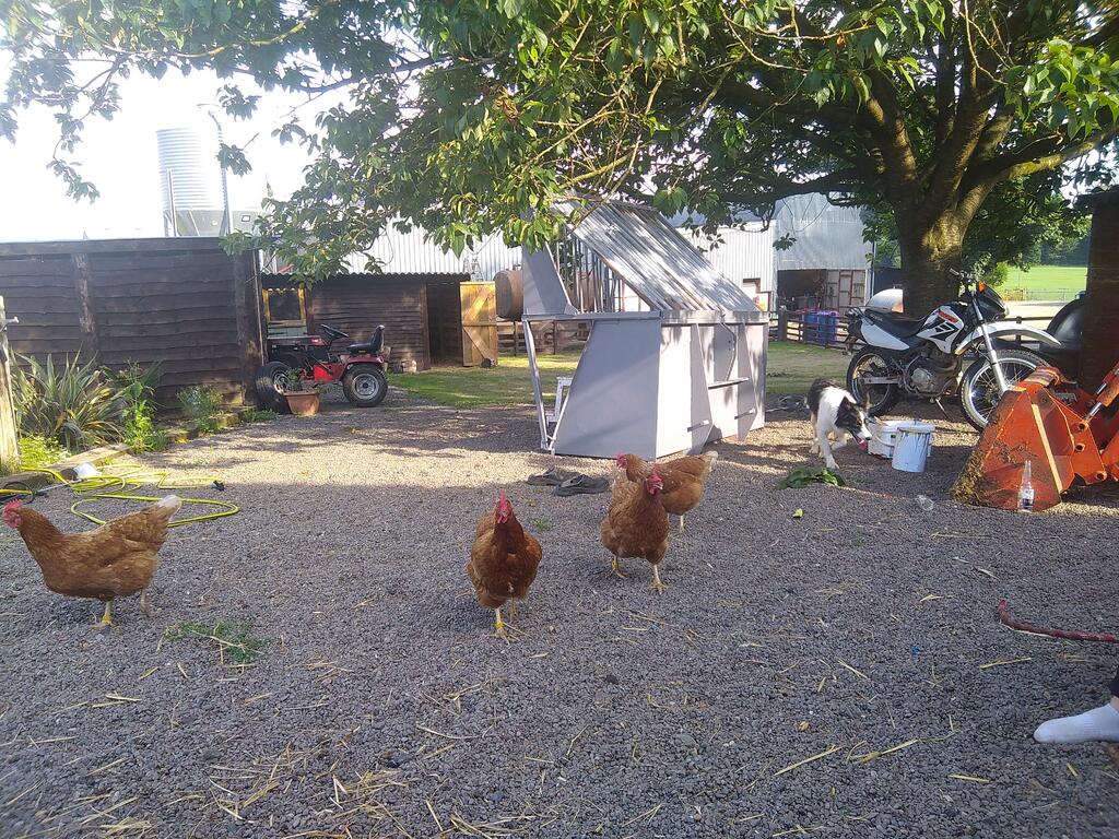

Dan.gerous 2,696 #11 Posted July 22, 2021 Found some shade under the cherry tree in our yard, lit the BBQ and grabbed some beer. Primer on, top coat later if I don't drink too much! Note the family all basking in various locations, but no volunteers to paint ☹️ 2 Share this post Link to post Share on other sites
Dan.gerous 2,696 #12 Posted July 22, 2021 Can you spot the wheelhorse?.... 1 2 Share this post Link to post Share on other sites

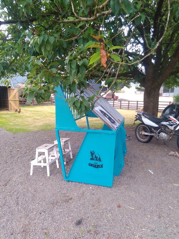

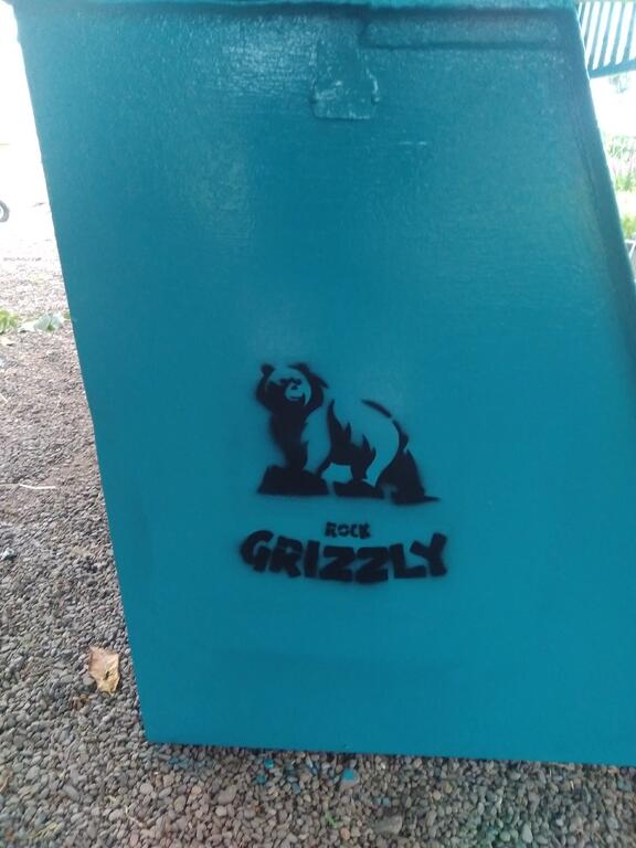

Dan.gerous 2,696 #17 Posted July 23, 2021 Finished! The logo is a bit rough and ready, but this thing will be a battered wreck in a few weeks. Trials later today once the real work is finished, will post a video of me crying next to a pile of broken steel.... 1 4 Share this post Link to post Share on other sites

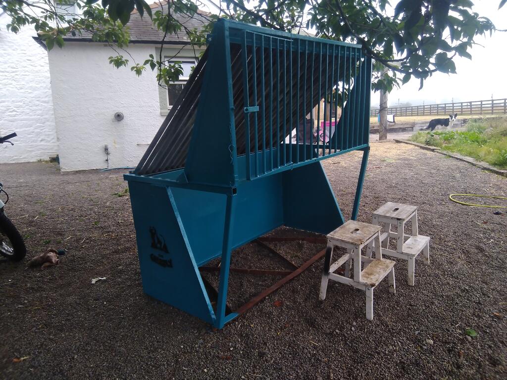

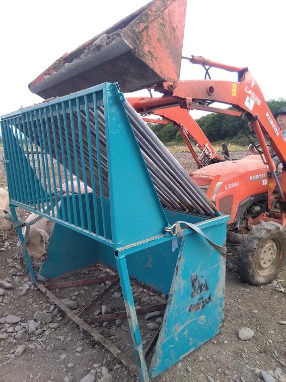

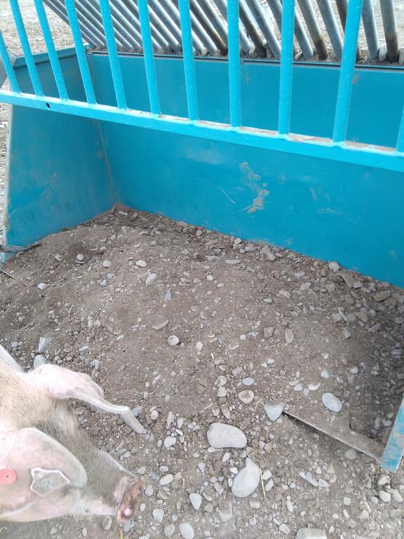

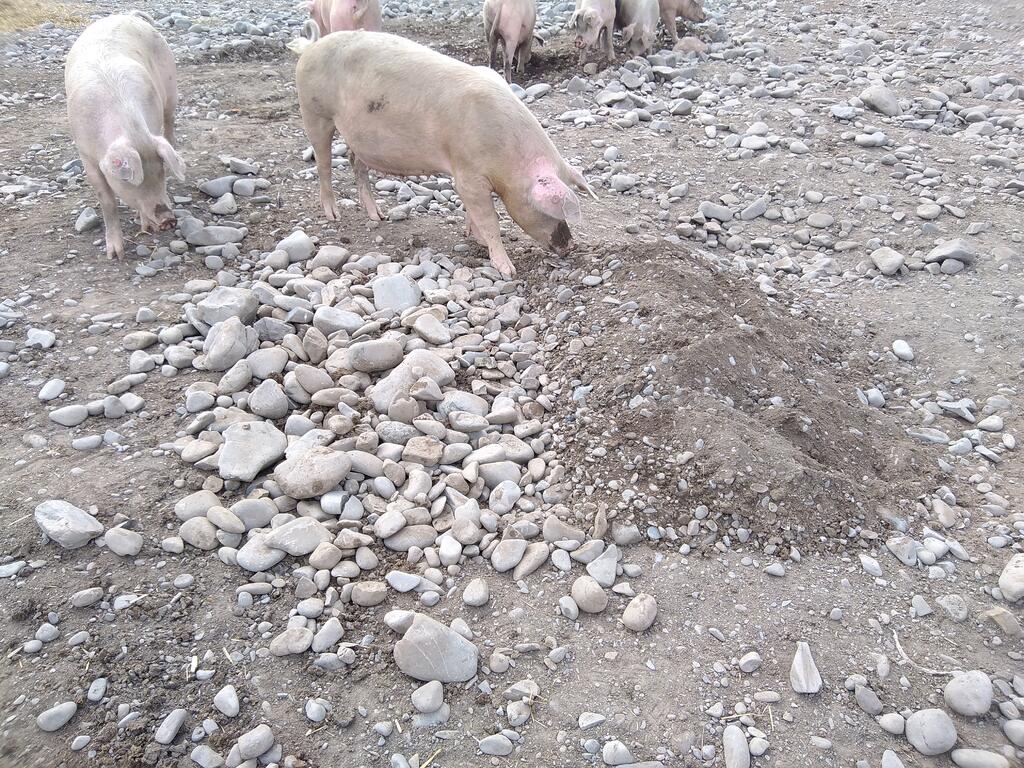

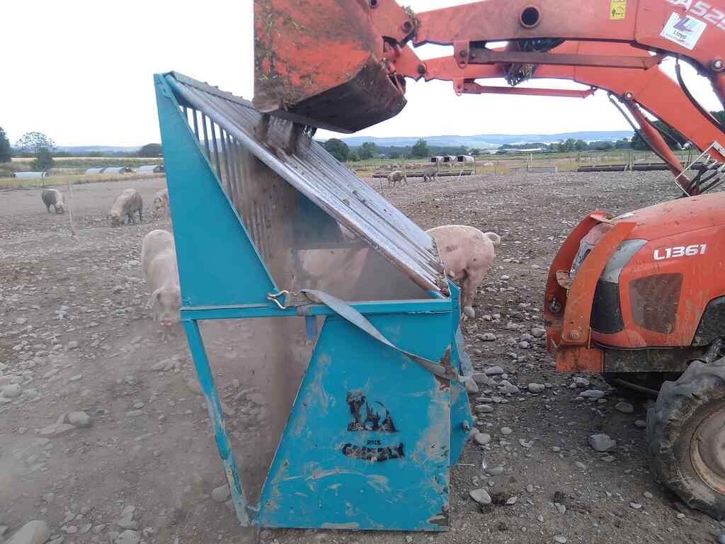

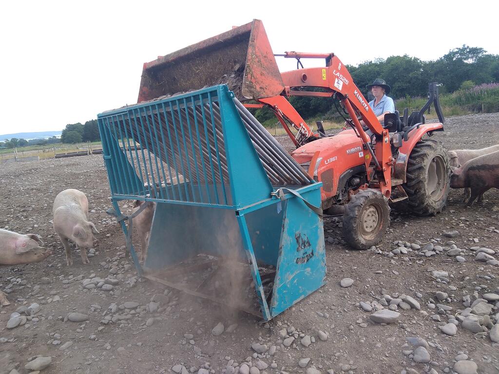

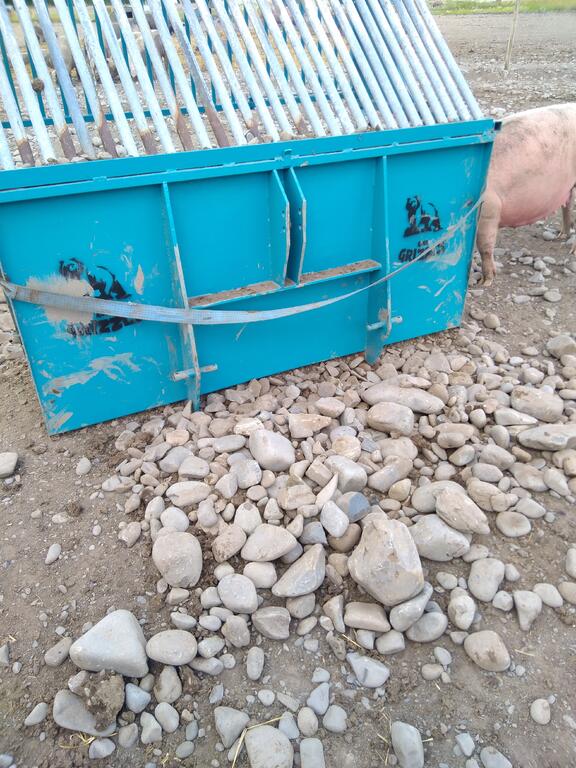

Dan.gerous 2,696 #18 Posted July 23, 2021 Success! Loaded up the Kubota and headed down to one of the dry sow pens for some rock picking trials. The Rock Grizzly worked as expected, the only problem we will have is getting the soil onto it - the ground is so hard the little Kubota struggles to get a grip on it. The rocks and dirt get sorted quite well, and if I add a mesh screen to it we will be able to get even the smaller rocks out. Have added photographs, video later once YouTube decides I can upload it. The pigs loved it, although they were mostly a pain in the ass - will pick an empty pen next time! 1 2 Share this post Link to post Share on other sites
Jeff-C175 7,211 #19 Posted July 23, 2021 (edited) 38 minutes ago, Dan.gerous said: The pigs They're pretty smart critters, can't you learn them to pick up or roll the rocks out to the fence row on their own? If they complain, just tell them they can do a little at a time. Doesn't have to all be done in one day! Why not approach from the OTHER side so the rocks don't bounce off the front of your machine? Edited July 23, 2021 by Jeff-C175 1 Share this post Link to post Share on other sites
Dan.gerous 2,696 #20 Posted July 23, 2021 3 minutes ago, Jeff-C175 said: They're pretty smart critters, can't you learn them to pick up or roll the rocks out to the fence row on their own? Why not approach from the OTHER side so the rocks don't bounce off the front of your machine? They are really good at getting the rocks out of the ground, just can't get them to load the trailer! Oh yeah we did load the other side, just tried both but the high side is best. My plan is to park our big Valtra with it's bucket under the ramp, that way the rocks go into it and saves trying to pick them up afterwards. 1 Share this post Link to post Share on other sites
Jeff-C175 7,211 #21 Posted July 23, 2021 (edited) 4 minutes ago, Dan.gerous said: Oh yeah we did load the other side, just tried both but the high side is best. Isn't it just as high on both sides? Quote park our big Valtra with it's bucket under the ramp, that way the rocks go into it and saves trying to pick them up afterwards. Good idea! Why pick things up and put them down more than once? Edited July 23, 2021 by Jeff-C175 Share this post Link to post Share on other sites
Dan.gerous 2,696 #22 Posted July 23, 2021 1 minute ago, Jeff-C175 said: Isn't it just as high on both sides? I meant the back 🙄 Share this post Link to post Share on other sites
Jeff-C175 7,211 #23 Posted July 23, 2021 (edited) 8 minutes ago, Dan.gerous said: I meant the back 🙄 Like this? Edited July 23, 2021 by Jeff-C175 1 Share this post Link to post Share on other sites
Dan.gerous 2,696 #24 Posted July 23, 2021 (edited) 1 hour ago, Jeff-C175 said: Like this? That's it, we started that way then tried the other way, then reverted back to that way - wouldn't take many loads before you couldn't get near it....and explaining the broken headlights.... Edited July 23, 2021 by Dan.gerous 1 Share this post Link to post Share on other sites
