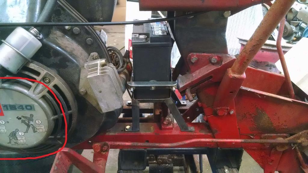

ebinmaine 80,765 #1 Posted July 20, 2021 We're looking at the possibility of having a Tecumseh 10 horse in a short frame tractor which means we need to lose about an inch or more of battery width front to back. Motorcycle application? Wheelchair? Something like that... I've seen it done I just don't know how. Thoughts or suggestions?. Share this post Link to post Share on other sites

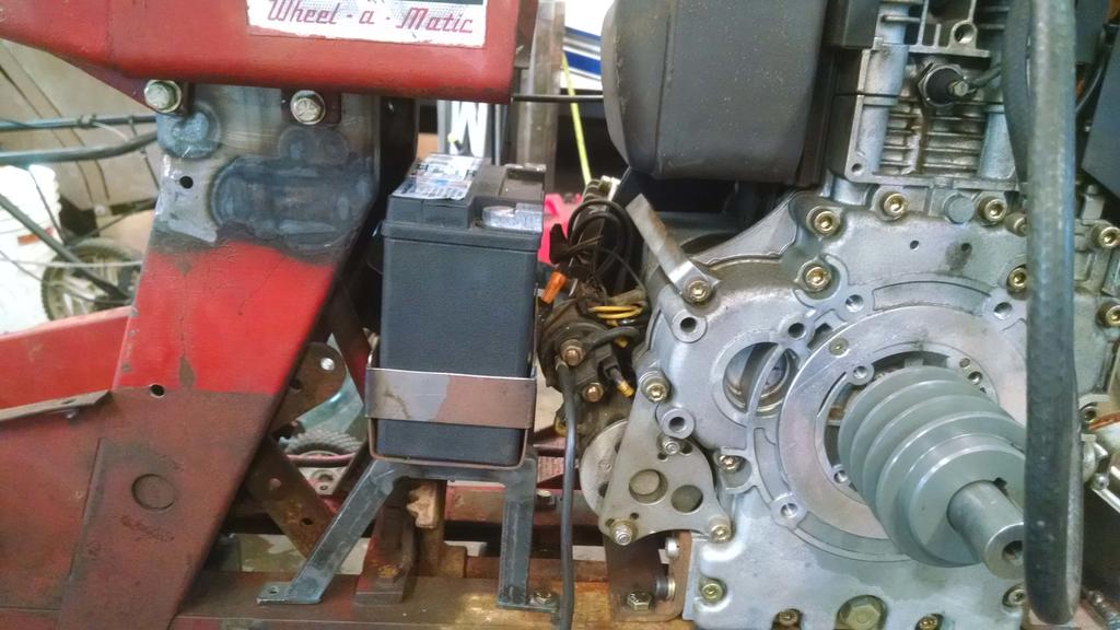

Achto 32,795 #2 Posted July 20, 2021 (edited) Radpferd is sporting an Interstate YTX20HL-BS battery. This would be a replacement battery for a Harley Davidson FXSTC as well as a few other FX models. Edited July 20, 2021 by Achto 4 1 Share this post Link to post Share on other sites
ebinmaine 80,765 #3 Posted July 20, 2021 6 hours ago, Achto said: Radpferd Boy that's some stuffed in there! Hadn't thought to do a raised battery holder... Might be enough room to use a U1 if we did that. 1 1 Share this post Link to post Share on other sites

pfrederi 21,176 #9 Posted July 20, 2021 Don't have any pics as the tractor is on Maine right now but I got a L@G battery in a short frame behind the engine by raising the battery tray ugly but i has worked for years 2 Share this post Link to post Share on other sites

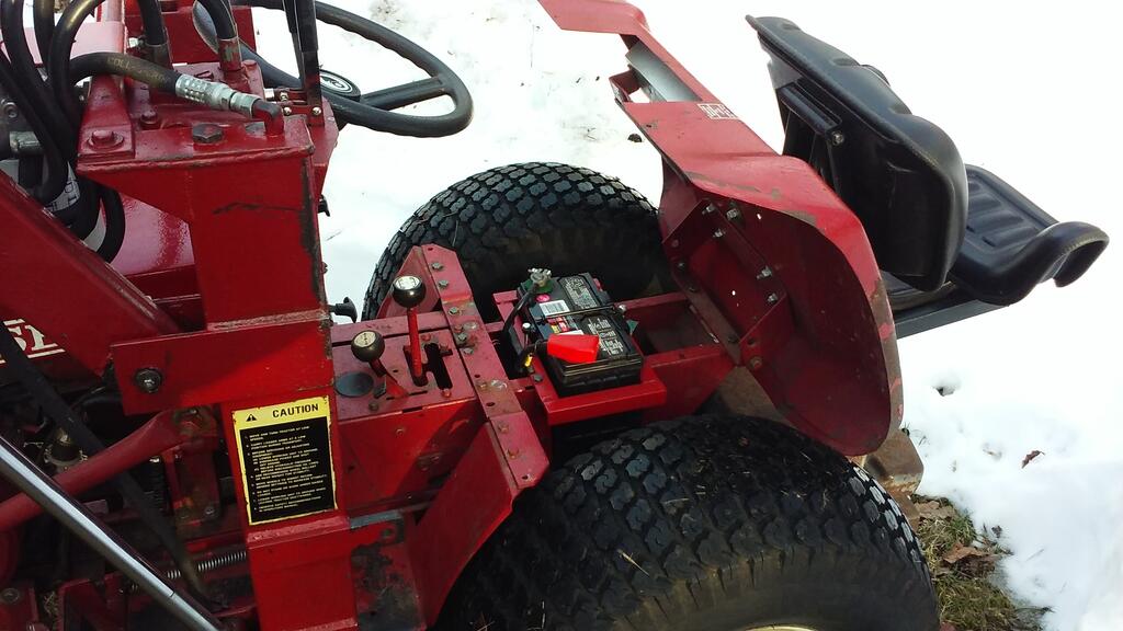

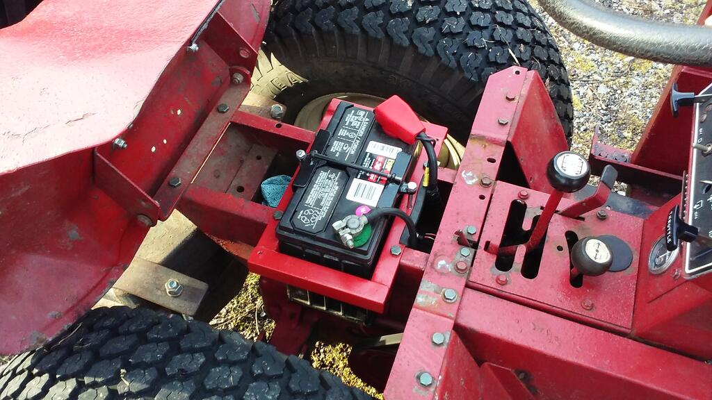

roadapples 6,987 #10 Posted July 20, 2021 I have a car battery in my C160 with the loader. When I added gear reduction steering, I moved the battery under the seat... 1 4 Share this post Link to post Share on other sites

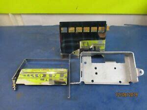

Crazyredhorse 296 #11 Posted July 20, 2021 (edited) if you did fx battery could use like a 73 tray like this.tabs on bottom cut off.strap goes over battery get used or new complete chrome kits n covers and tray for cool.also there was a kick fx and electric start might be different battery and tray.i think fxe was electric start. Edited July 20, 2021 by Crazyredhorse 1 Share this post Link to post Share on other sites
