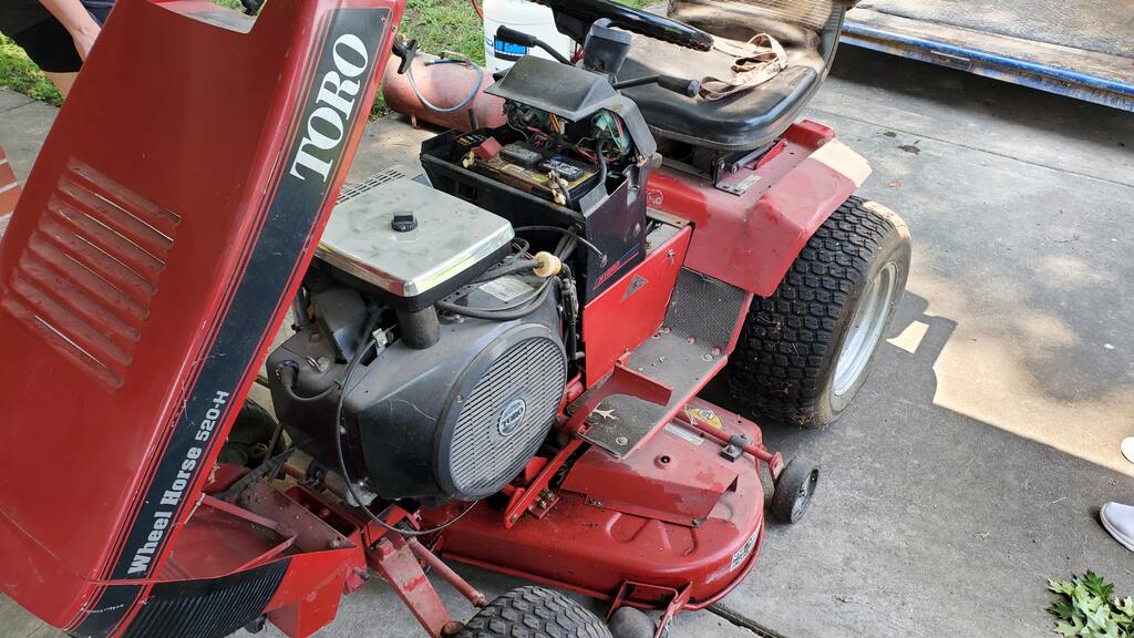

AlexH 2 #1 Posted July 18, 2021 Hey yall. So I bought a 92 520H yesterday. Lady said it hasn't ran in 5 years just parked in garage. I drained fluids and changed them all. New spark plugs, battery, battery cables, fuses and relays. Got it started up and it was surging a little bit. After a few minutes mowing it leveled out and ran fine. Well a little later I changed oil and filter and added seafoam to fuel. Started up and ran great a few minutes then started to blow white smoke and backfiring and started surging bad. Now only will run with choke adjustment. Any ideas? 1 Share this post Link to post Share on other sites
WHX?? 57,468 #2 Posted July 18, 2021 (edited) Start with a carb cleaning. Your well intentioned maintenance may have dislodged some crap. Did you replace fuel lines/ filter. May have sat with ethanol in it's go juice. Looks like you might have? Edited July 18, 2021 by WHX24 3 1 Share this post Link to post Share on other sites

lynnmor 8,915 #6 Posted July 19, 2021 You can first try cleaning the carb while it is in place. Before removing the carb top, take a photo of the linkages and keep the choke shut as much as possible to keep things and dirt from falling in, then clean it out as best you can. Those air box screws will need some blue thread locker. If that cleaning fails, it is time to pull the manifold and do it right. Use only genuine Onan gaskets for the manifold and exhaust, others can fail. Tell us the hours on the engine to see if we can suggest other maintenance. 1 Share this post Link to post Share on other sites

lynnmor 8,915 #9 Posted July 19, 2021 With 1200 hours, the valves need adjusted and the heads should have the carbon removed. Parts can be found at onanparts and Colburn. When you remove the exhaust it would be a good time to glass bead and paint it with Rustoleum High Temperature paint. The intake needs to be carefully inspected for leaks at the seam and for cuts from the heat shields. You need the Onan Service Manual for the bolt torque specifications as well as other information. Return here with questions. 1 Share this post Link to post Share on other sites
