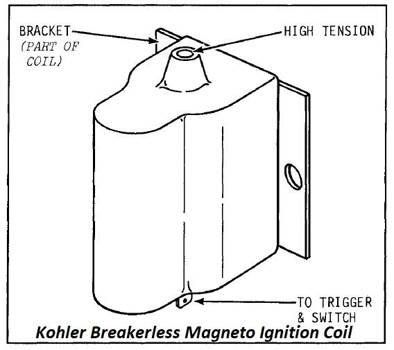

gwest_ca-(File Mod) 12,321 #2 Posted July 17, 2021 1969 Raider 12 originally had breakerless magneto ignition. Has it been changed to battery ignition because it failed? Click on the picture in the link to view more Garry 1 Share this post Link to post Share on other sites

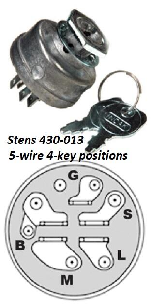

gwest_ca-(File Mod) 12,321 #3 Posted July 17, 2021 33-395 is an Oregon number for a 5-wire 4 key position magneto ignition switch with one of the 5 being a ground wire. Stens 430-013 is the same. This switch will not carry the starter load so the solenoid was added. 1 Share this post Link to post Share on other sites

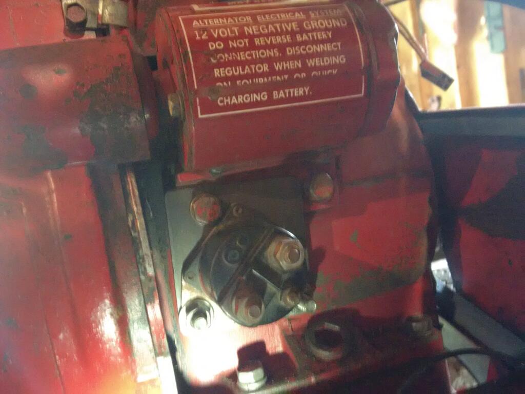

Uxtractor 8 #4 Posted July 18, 2021 (edited) Good evening ,And thanks for the fast reply my kohler has a regular ignition points and coil with condenser on the shroud ,my 33-395 switch is 3 position 5 terminal. I thinking that I need a different ignition switch ,the engine will spark if I just turn the key to on and cross the solenoid with a old screw driver . I did find a dealer selling 33-395 and he said it was for a magneto engine while the 33-396 says 4 position and no mention of mag . Yes I installed a solenoid my tractor was a parts tractor with nearly everything stripped off so without a original untouched one I am having a bit of a time sorting it out I appreciate everyone,s interest going to look at a new switch Sunday .Was not sure where Wheel Horse put it so made a small mount and attached it under the starter out of the way and short cables .cheers Mike Edited July 18, 2021 by Uxtractor added picture 1 Share this post Link to post Share on other sites
