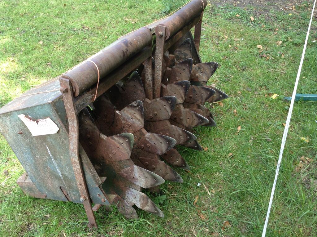

ranger 1,855 #5 Posted July 18, 2021 This is mine, originally 3point linkage, but I use the detachable draw bar from my flail mower to tow it around the paddocks. C121 tows it no problem, as you can probably guess, this thing is “Heavy”!!!p Share this post Link to post Share on other sites
