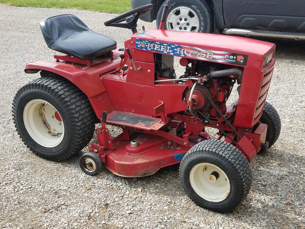

prondzy 3,890 #1 Posted July 15, 2021 I have a c81. It has separate clutch and brake pedals. I have been thinking of making a 2 seater for me and the Mrs. I want to make it a single clutch brake pedal. I know it can be done one way or another, but has anyone on here done it already, got any pics? 1 Share this post Link to post Share on other sites

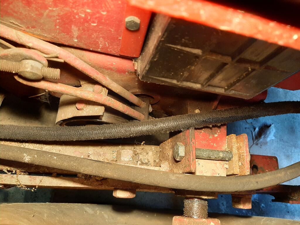

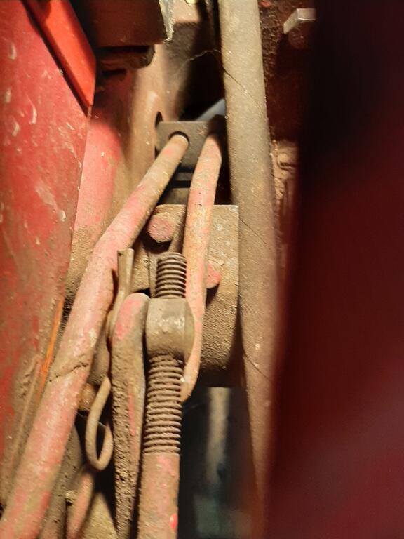

kpinnc 18,916 #6 Posted July 16, 2021 Many older tractors that used stirrup foot rests combined the clutch and brake on one pedal. The park brake accessibility becomes the issue if you use full length foot rests. 1 Share this post Link to post Share on other sites

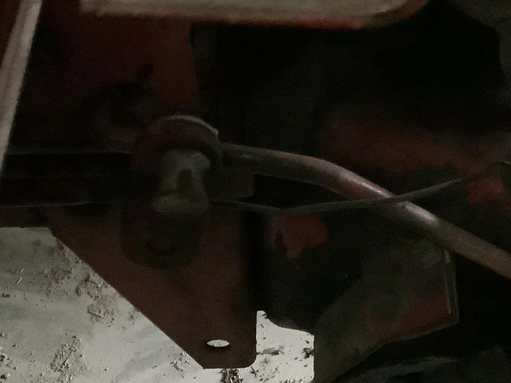

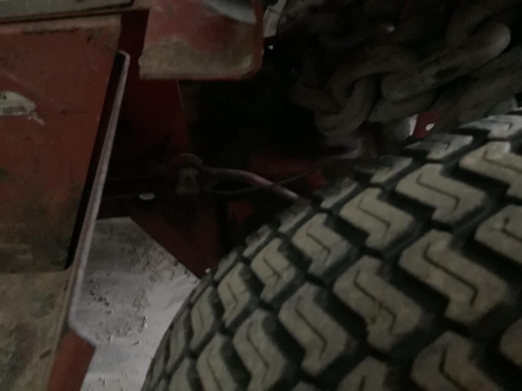

roadapples 6,987 #10 Posted July 16, 2021 Kpinnc has a good picture of the single pedal setup. I drilled a second hole in the brake pad bracket and added that same rod. I think I had to bend it a little more. Left everything else the way it was. I can use either pedal. Reason.. I was used to the single pedal. When I brought my 74 C160 with loader home backed on my pickup, I drove it off. When it started down the ramps I went for the brake on the left, which of course was the clutch. Got it stopped half way across the yard. Didn't know these little tractors could go that fast. Fortunately nothing in my way. Had a good laugh later on after I changed my pants... here's a couple pics. 1 1 2 Share this post Link to post Share on other sites
Pullstart 71,161 #11 Posted July 16, 2021 (edited) 58 minutes ago, roadapples said: Kpinnc has a good picture of the single pedal setup. I drilled a second hole in the brake pad bracket and added that same rod. I think I had to bend it a little more. Left everything else the way it was. I can use either pedal. Reason.. I was used to the single pedal. When I brought my 74 C160 with loader home backed on my pickup, I drove it off. When it started down the ramps I went for the brake on the left, which of course was the clutch. Got it stopped half way across the yard. Didn't know these little tractors could go that fast. Fortunately nothing in my way. Had a good laugh later on after I changed my pants... here's a couple pics. I like that you kept the brake pedal there too Mr. Jay... smart! Mike it does look like you could just add a trunion to the clutch arm and add a shorter brake rod and be done... Sorry for the darkness, but it looks quite easy when you see it. Edited July 16, 2021 by pullstart Photo 3 Share this post Link to post Share on other sites
