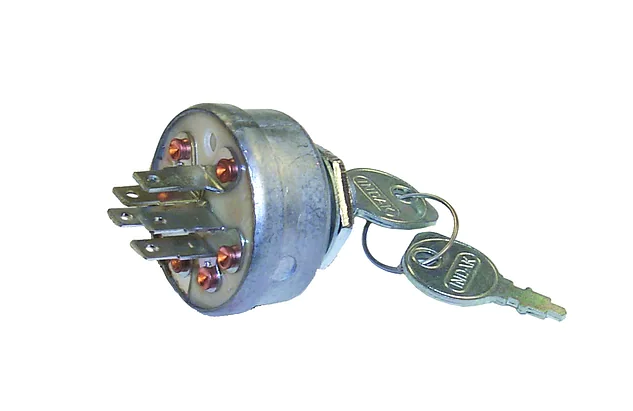

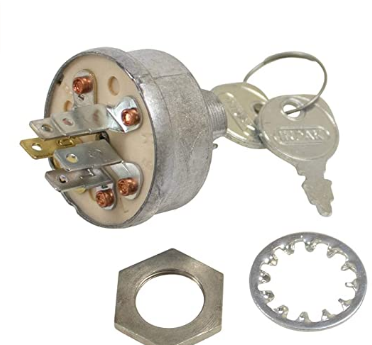

Achto 31,803 #26 Posted July 14, 2021 (edited) 2 hours ago, Gregor said: They are NOT the same. Do you happen to know the part number of the new switch you installed? The easiest way to tell if you have the right switch is to look at the letters on the terminals. If you have a terminal marked with an "M" you have the wrong type of switch. If you have a terminal marked with an "I" then you have the right type of switch. An "I" terminal how ever does not mean that the terminals are configured correctly. You may have to move wires around in the plug to get the correct configuration. Edited July 14, 2021 by Achto 2 Share this post Link to post Share on other sites
Gregor 4,848 #27 Posted July 14, 2021 3 minutes ago, Achto said: The easiest way to tell if you have the right switch is to look at the letters on the terminals. If you have a terminal marked with an "M" you have the wrong type of switch. If you have a terminal marked with an "I" then you have the right type of switch. An "I" terminal how ever does not mean the the terminals are configured correctly. You may have to move wires around in the plug to get the correct configuration. Don't I know it ! 1 Share this post Link to post Share on other sites
Talyn walsh 2 #28 Posted July 14, 2021 12 minutes ago, Gregor said: Here are 2 ignition switches. The top one is 5 pole 3 position (stop, run, start) battery ignition switch from Amazon. The bottom one is a 5 pole, 3 position, (stop, run, start) magneto ingition switch from Oreily Auto parts. My point is. Both switches are 5 pole, 3 position, identical looking switches. They are NOT the same. Do you happen to know the part number of the new switch you installed? I ordered it off of Amazon I’m not sure the number tho Share this post Link to post Share on other sites
Talyn walsh 2 #29 Posted July 14, 2021 6 minutes ago, Achto said: The easiest way to tell if you have the right switch is to look at the letters on the terminals. If you have a terminal marked with an "M" you have the wrong type of switch. If you have a terminal marked with an "I" then you have the right type of switch. An "I" terminal how ever does not mean the the terminals are configured correctly. You may have to move wires around in the plug to get the correct configuration. I have the terminal i for ignition not an m 2 Share this post Link to post Share on other sites
Talyn walsh 2 #30 Posted July 14, 2021 24 minutes ago, Gregor said: Only 1 wire Battery + to coil + Thats all Alright Share this post Link to post Share on other sites

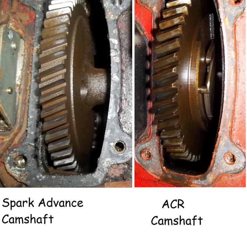

953 nut 66,064 #47 Posted August 1, 2021 6 minutes ago, Talyn walsh said: Ok so I have 12 volts going to the + on my ignition coil but no spark what’s my problem Your next check should be observing the ignition points while the engine is being turned over by the starter. There should be a slight spark at the points when they first open. The time of opening also sets your ignition timing so it needs to be correct. Gapping the ignition points at .020 has always been the standard answer to how points should be set. That probably will get you into the ballpark where the engine will run, but with a bit of additional effort you can improve the engine’s power and performance. The Kohler engine manual in the Red Square files section covers two methods for setting the ignition timing, Static Timing and using a Timing Light. This manual is a relatively new manual and it overlooks the fact that many of our engines were built prior to the ACR (automatic compression release) camshaft. Earlier engines (mostly 1965 and earlier) had a Spark Advance camshaft that can not be timed using Static timing. At rest (and very low RPMs) the timing is retarded to fire slightly after TDC. The timing mark (SP) on your flywheel is at twenty degrees before top dead center but at rest the points on these engines break about ten degrees after top dead center. The only reliable way to check or set the timing on these engines is with a timing light. There are a couple ways to determine what camshaft you have. Presuming the camshaft in your engine is the one it was born with the data plate on the engine has a suffix that can tell you what camshaft was used. The table below will tell you the suffix applicable to your engine. The other way to determine what camshaft you have is to remove the cam gear cover and take a look. If you see a mechanism attached to the cam gear it is the ACR cam. The following engines have the spark advance camshaft; K-141, Suffix prior to “C” K-161, Suffix prior to “J” K-181, Suffix prior to “D” K-241, Suffix prior to “D” With a battery ignition system, the ignition points are closed the majority of the time. With the points closed and the ignition switch ON the primary windings of the ignition coil have current flowing through them and are developing a magnetic field in the iron core of the ignition coil. The moment the ignition points open the magnetic field collapses and induces a momentary high voltage pulse in the secondary windings of the coil which goes through the spark plug wire and arcs across the gap of the spark plug. If this occurs in the presence of a compressed fuel/air mixture of the proper ratio an explosion will occur within the cylinder. If this explosion occurs at the proper time in the engine’s cycle there will be pressure applied to the piston forcing it downward on the power stroke. The ignition points will continue to open further after this has occurred. How far they open is immaterial, their work has been done for that cycle of engine operation. What is important is when they open relative to the position of the piston on its compression/power revolution. If it occurs too soon there will be backfiring, too late and there will be a reduction of power. In the case of our Kohler engines the sweet spot is twenty degrees Before Top Dead Center, that is what the “SP” mark on the flywheel is set to). At the moment the points open the condenser quenches the arc across the points extending their life, the rest of the time it just sits there. Share this post Link to post Share on other sites
