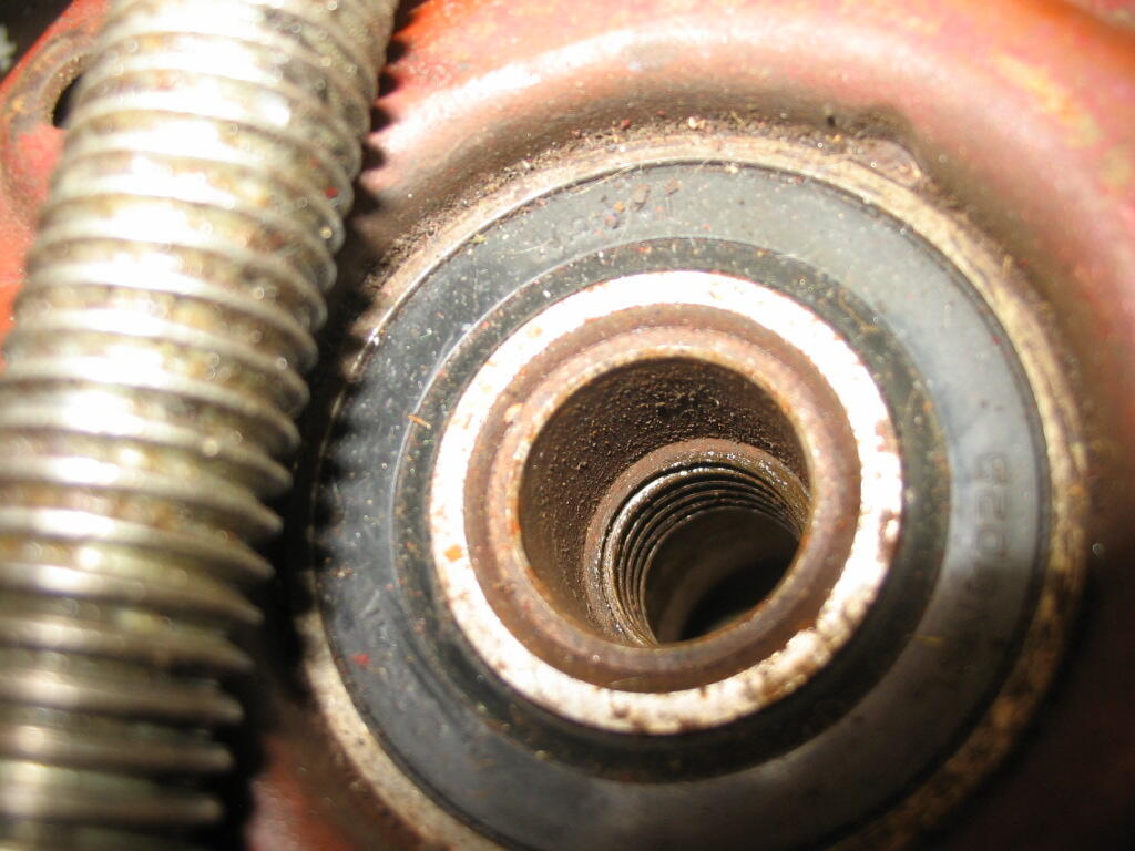

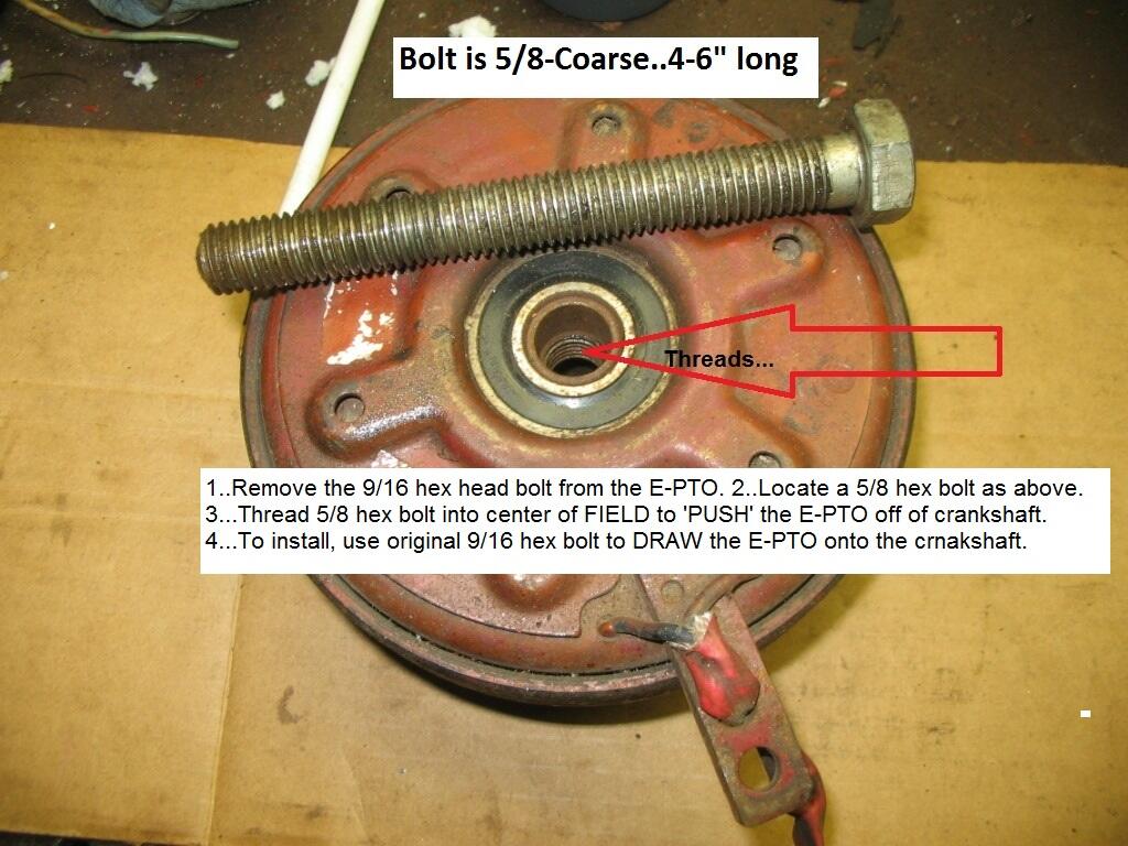

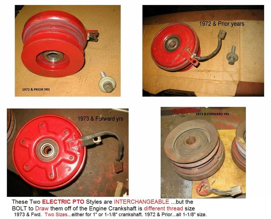

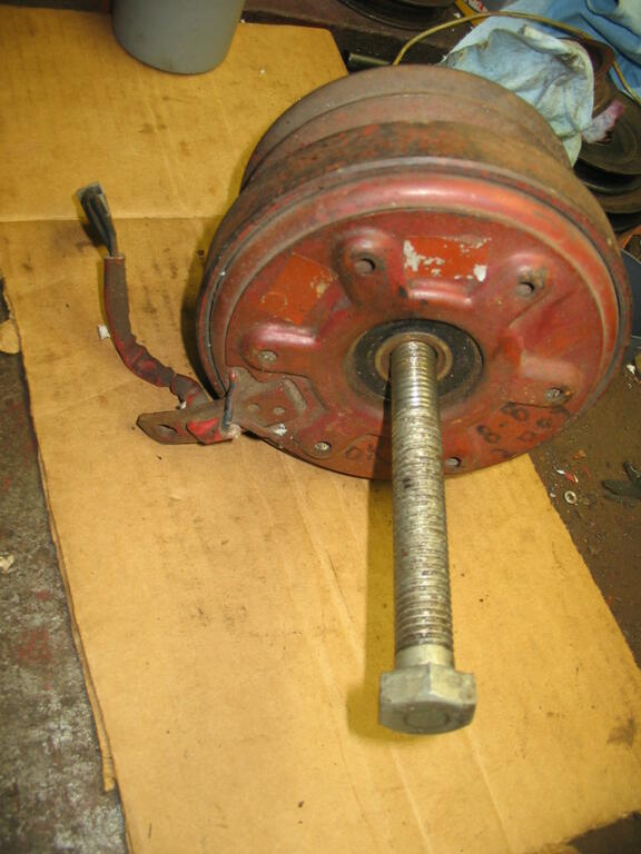

daveoman1966 3,882 #2 Posted July 13, 2021 (edited) You must mean the Electric PTO removal... Your method is correct....remove the little bolt that holds it to the crankshaft. Look inside that hole...you'll see COARSE threads. This is where you thread in the 5" long bolt (not sure of bolt dia...probably 11/16 or 3/4). The end of that big bolt will press against the end of the crankshaft, slowly drawing the E-PTO off. As you apparently know, don't EVER use any kind of tool ...like a 3-jaw...to take the E-PTO off... Guaranteed FUBAR. There arre TWO styles of E-PTO, and the removal method is the same. The GT-14 would be the 1972 & prior style. Edited July 13, 2021 by daveoman1966 4 Share this post Link to post Share on other sites
